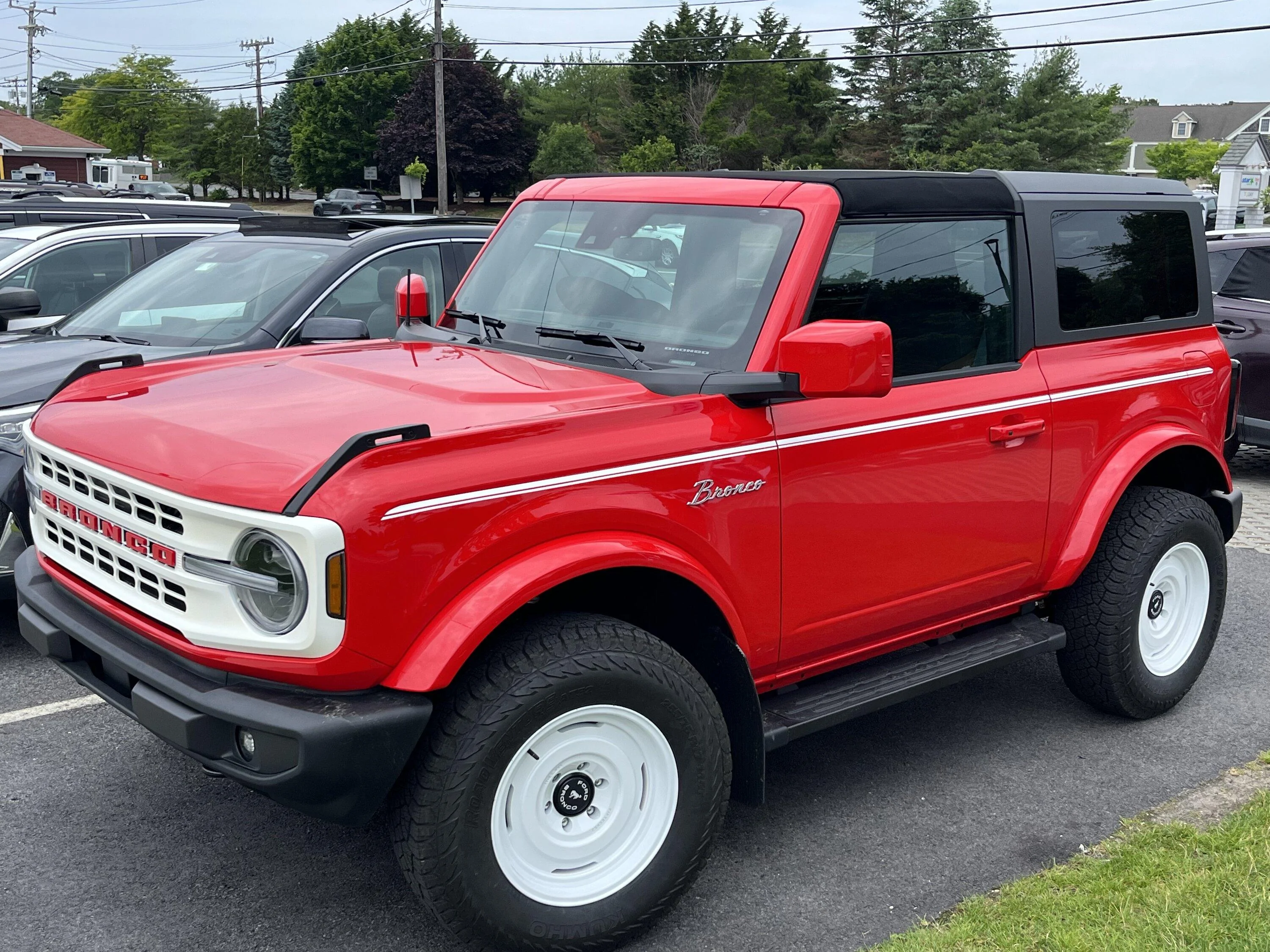

About how long did the install take?
Mine is finally released for delivery finally after 2 months sitting on Ford's embarrassment mountain. Dealer is telling me the reason Ford sells them 2x as much is because they are so difficult to install. Doesn't make sense to me
Here's a photo with the Sunrider closed.
Ford Bronco Installed Sunrider for 2-door sunrider
