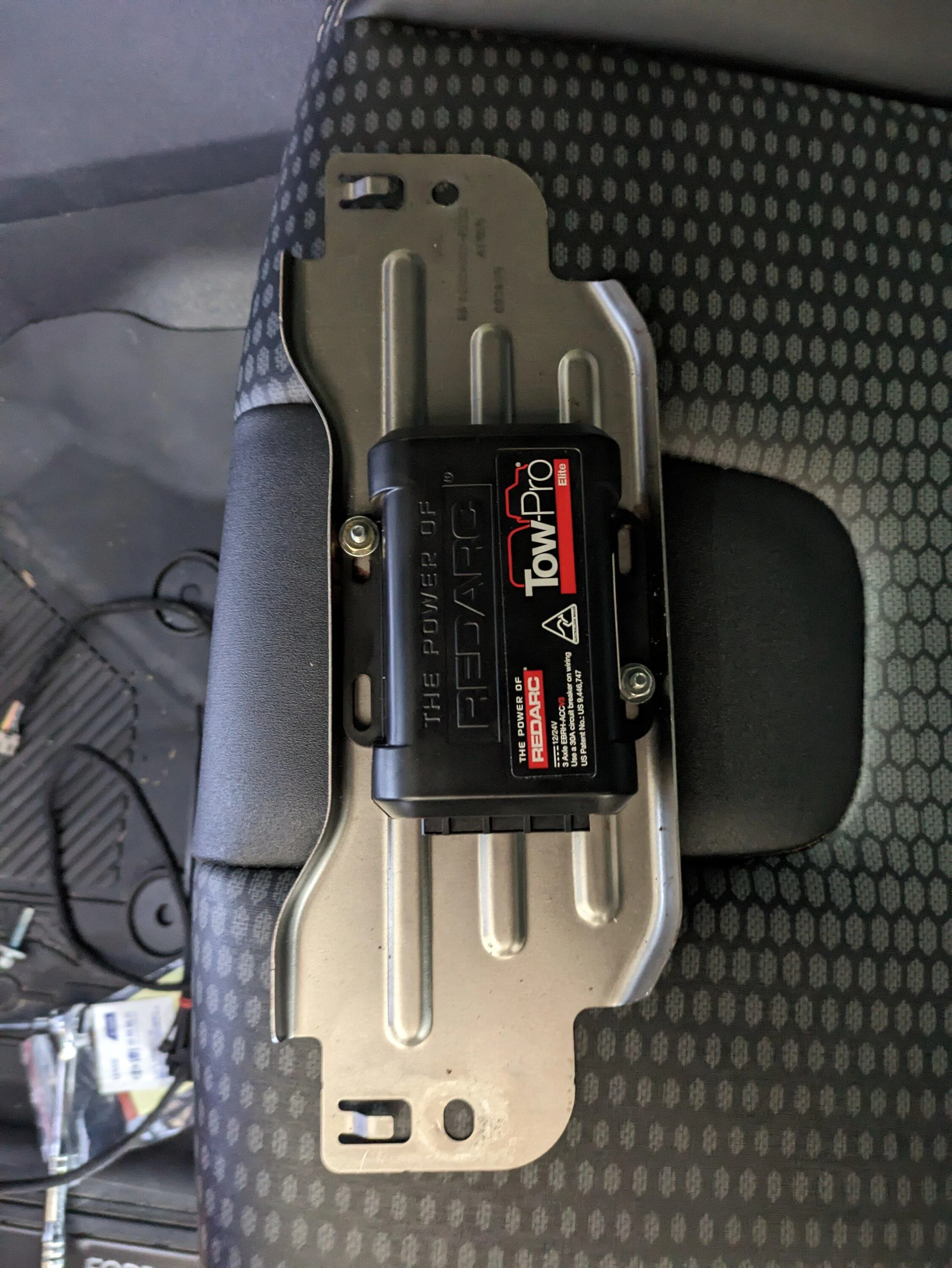

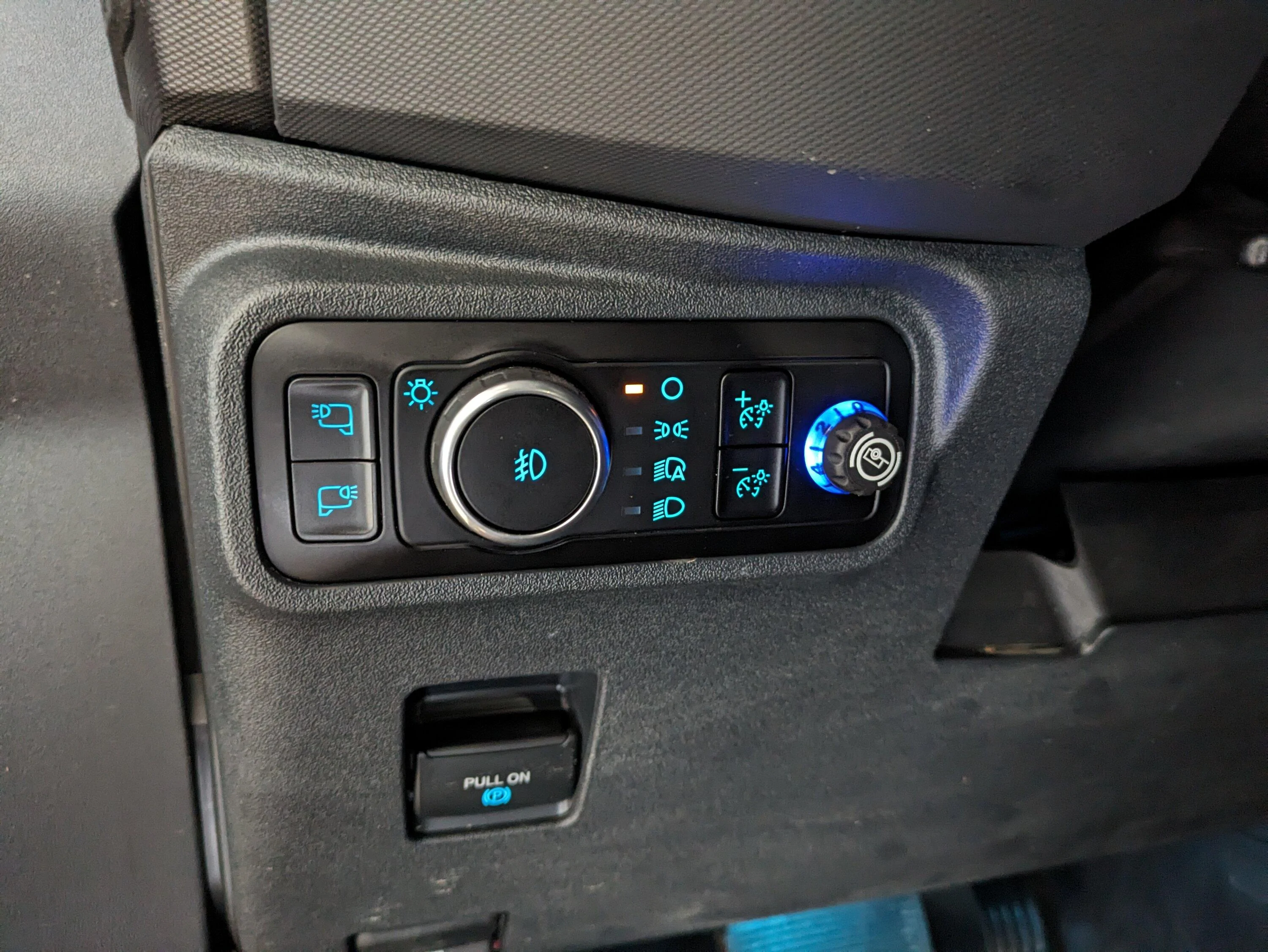

Finished install of Ford's brake controller system for the Bronco which 100% integrates with a custom Ford firmware so don't use the regular Redrac. Plug n play except I put the module and adjustment knob in a better location. Backside of the bracket below the steering wheel and the light control module.
I will be giving it a test run next week with an open car trailer with electrical brakes.
I know I am a bit late to this party but did you have an interference issue with the control know wiring hitting a mounting support? If so, how did you solve the mystery? Thank you.
