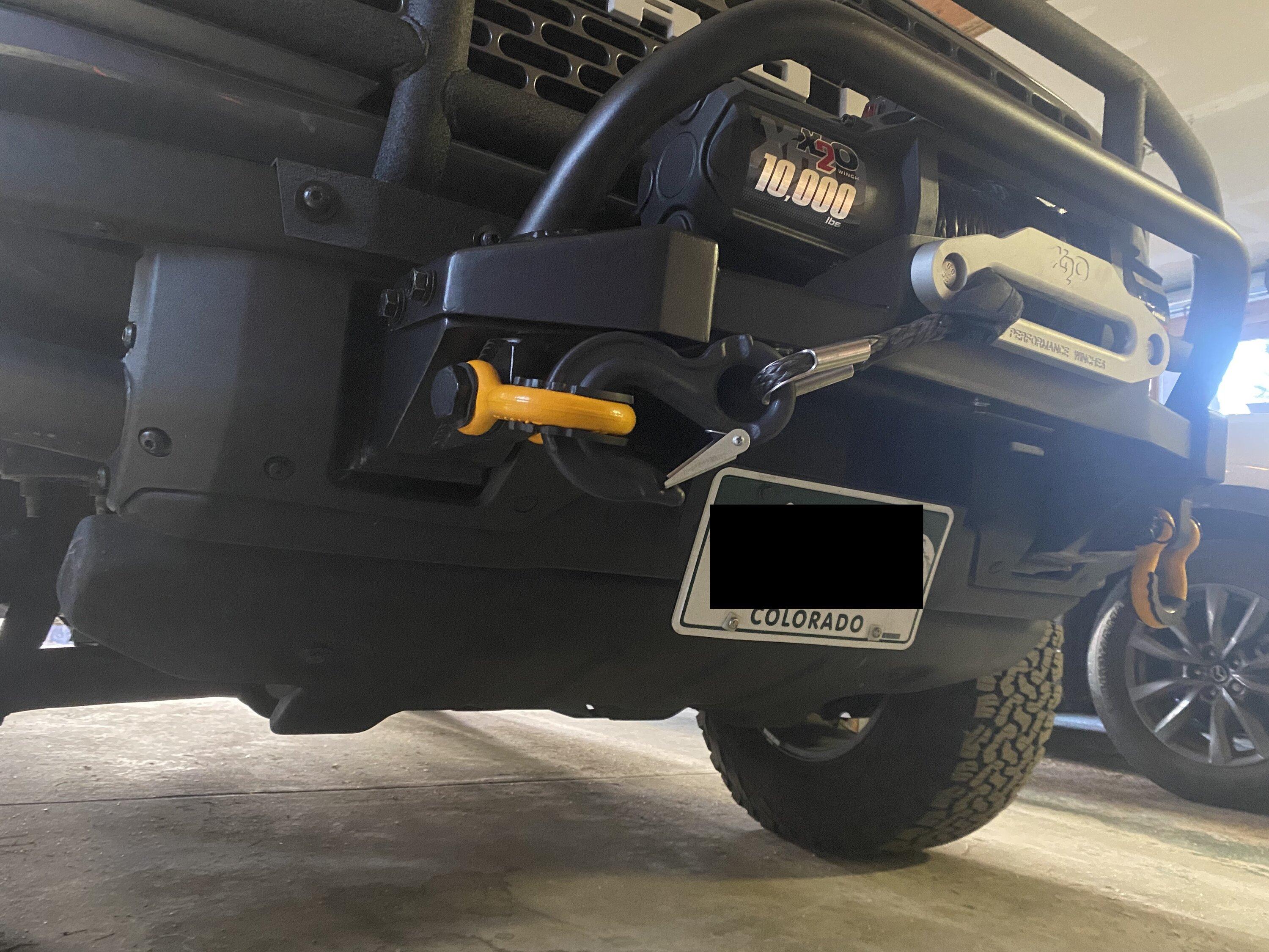

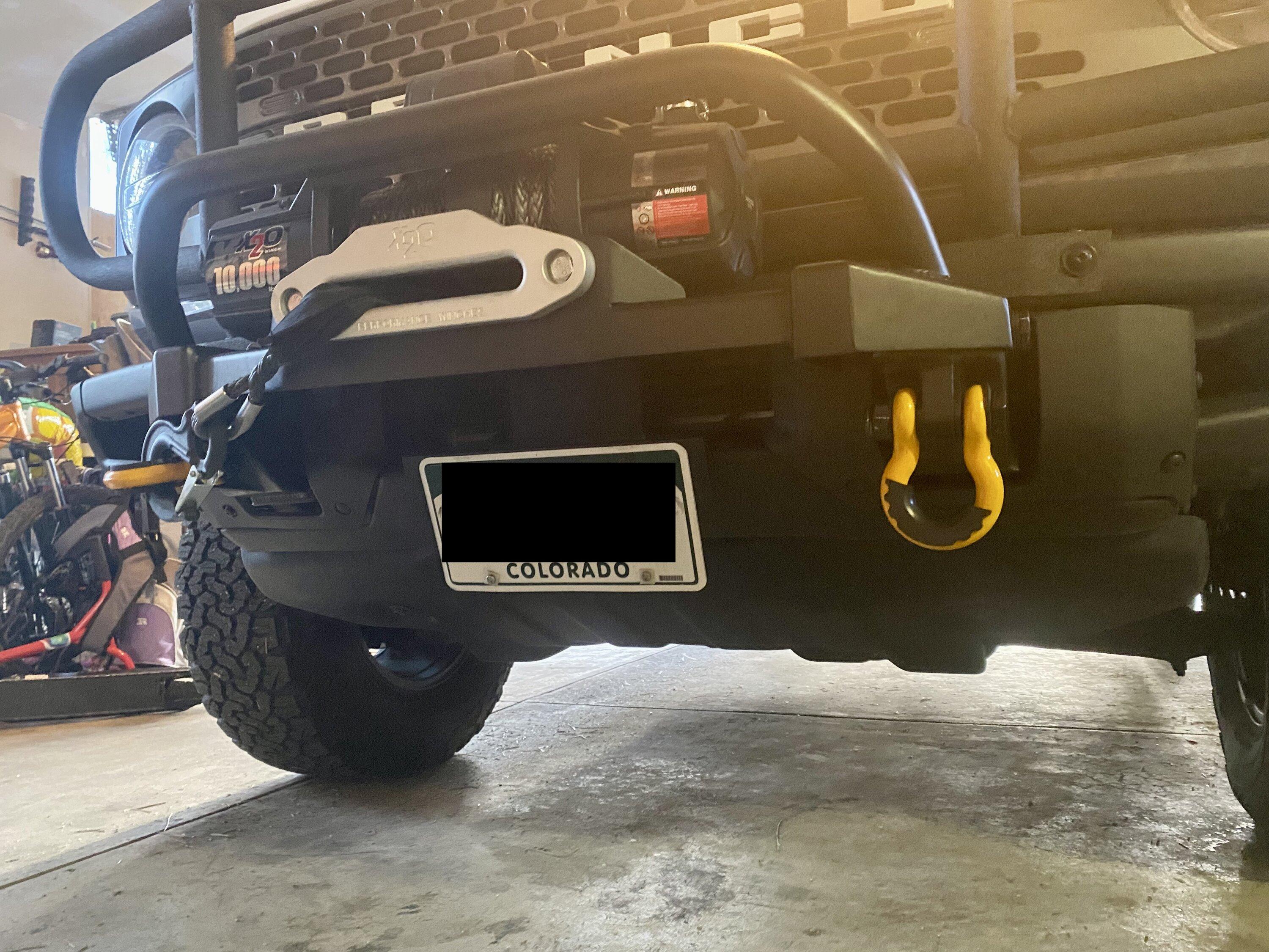

It looks to be better quality than the rough country ones I see. Although lower a bit. Would you take a picture low and to the side so I can see the approach angle? Thanks!
I don't see any issues with the approach angle.
Sorry about the lighting, the sun glare hit my camera, and I didn't feel like pulling her out of the garage.
Next time I take her out I should be able to get you a better pic in the daylight.

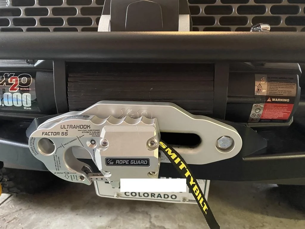

Also, I just upgraded to the Factor55 Ultrahook and rope guard, so that it will fit flush against the fairlead (and there will be no need to hook it to a shackle). I hope to have that installed by next week.

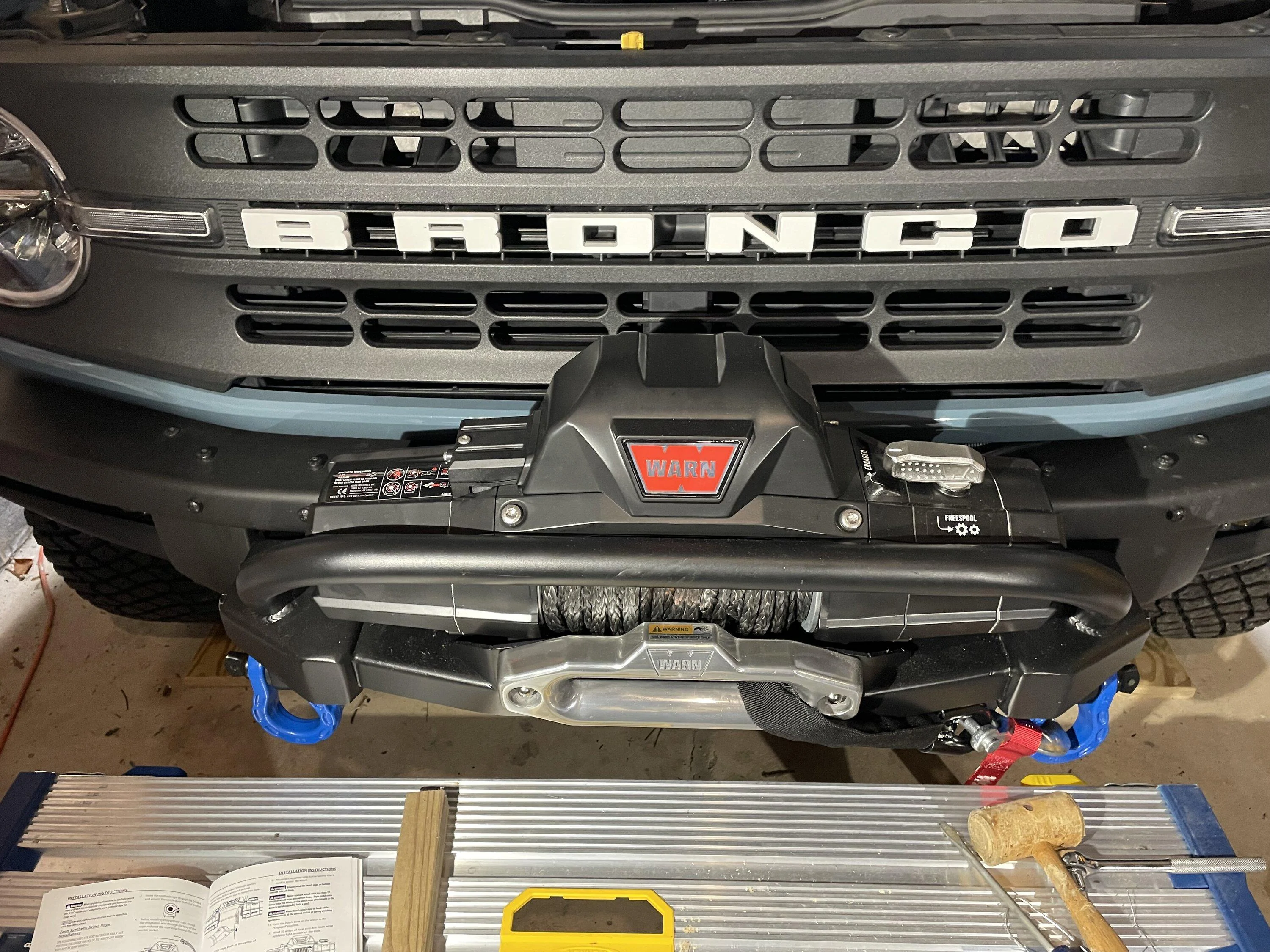

Installed the IAG winch bumper today and used the advice of @Hemisfear on the winch spacer plates and the Warn Zeon 10s fit with no problem. I used the DV8 camera relocation bracket. I really like the look, I just hope it’s strong enough.

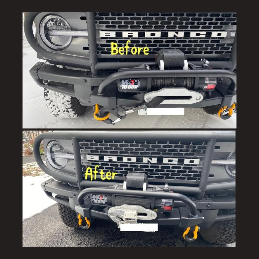

I highly recommend the Factor 55 Ultrahook and rope guard. Well worth the $$.
My buddy fabricated a cover for my synthetic line (corrugated plastic) to protect from the sun. It also prevents freezing in winter conditions.

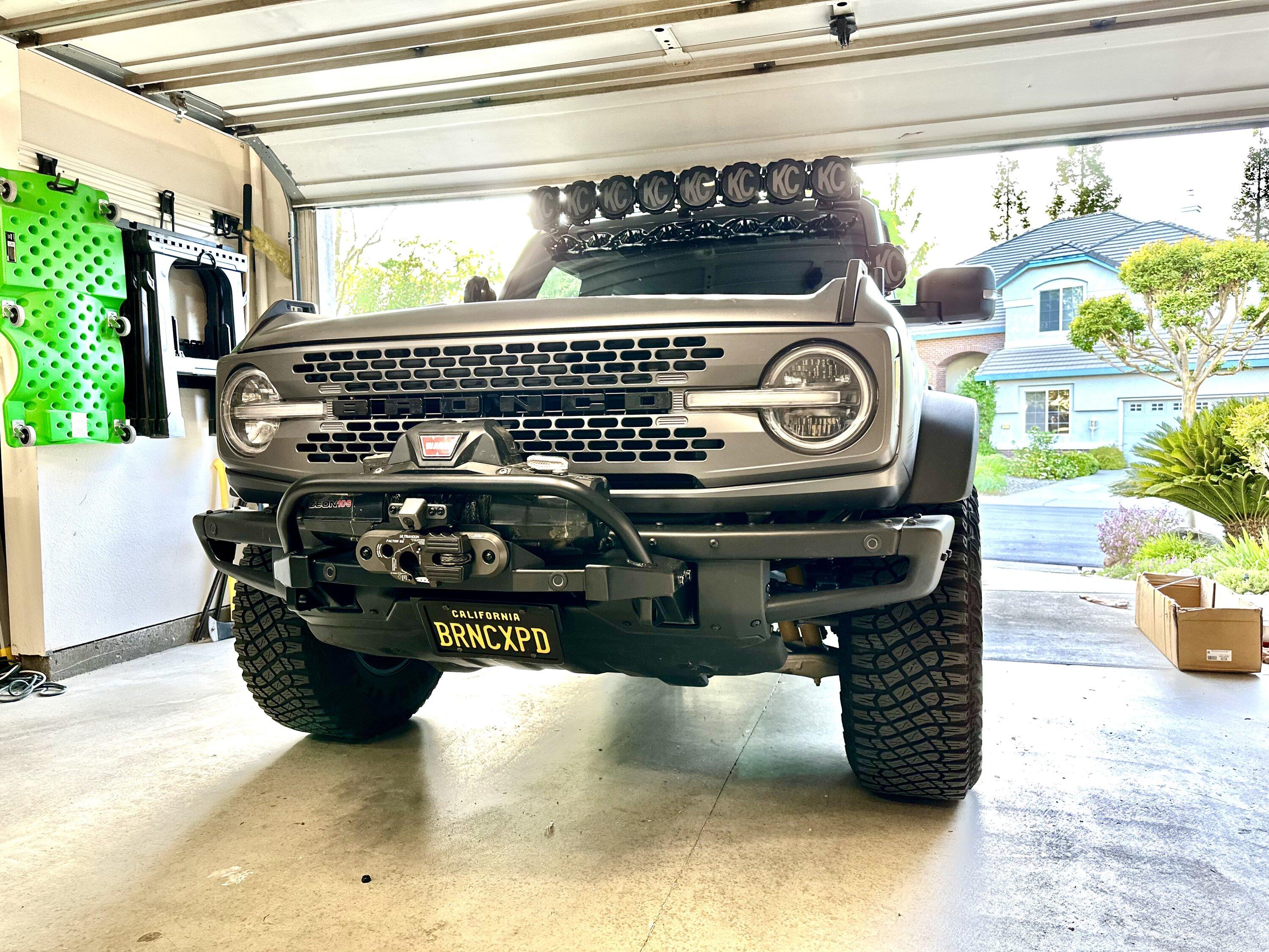

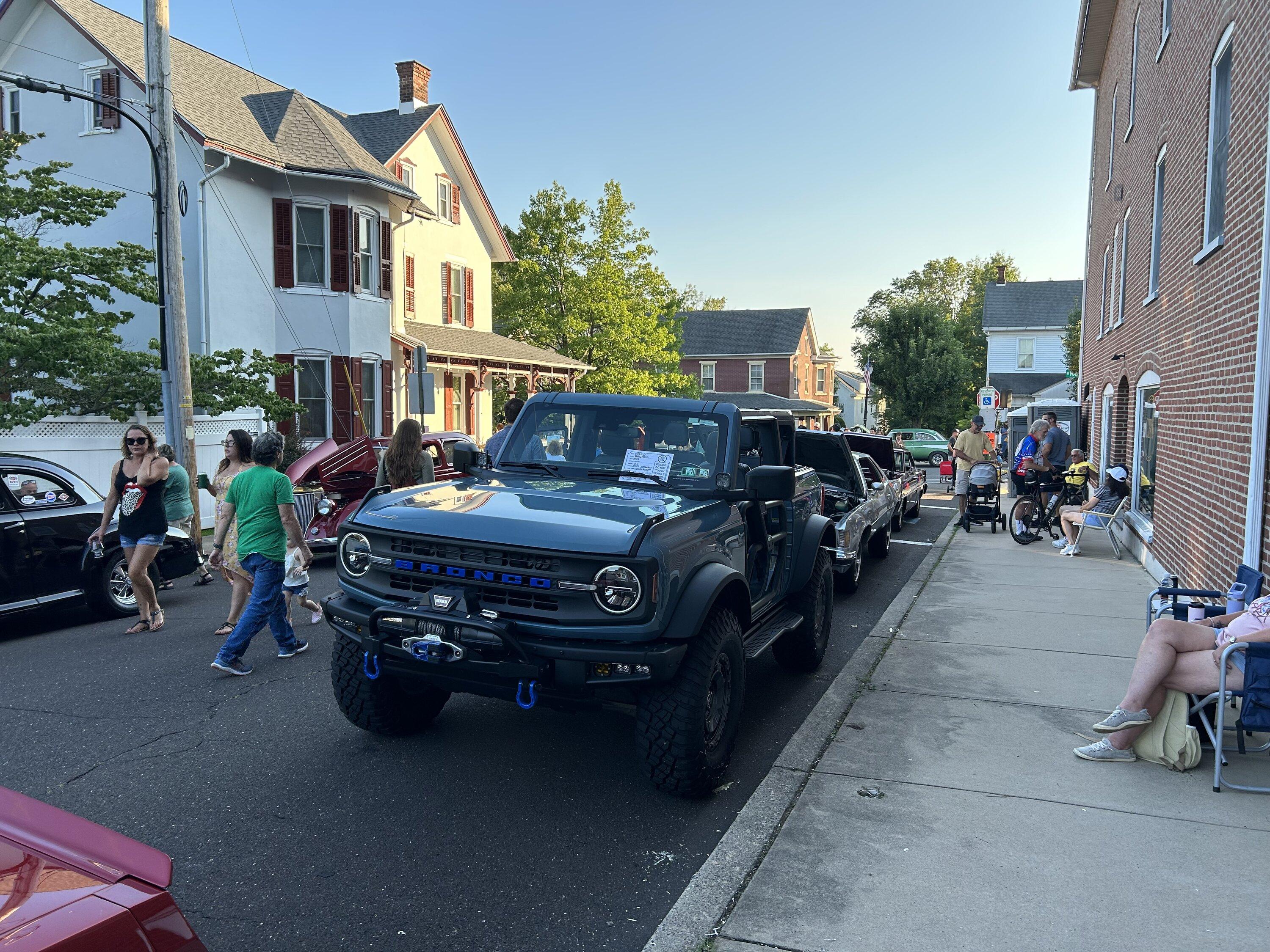

Zero issues with the Zeon 10S.
Ford Bronco IAG winch mount - anyone installed yet? IMG_4873
Ford Bronco IAG winch mount - anyone installed yet? IMG_5138

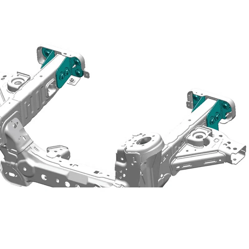

When it comes to the installation, is the point when the IAG mount attaches to the Frame Ends strong enough to handle the Force put upon the assembly when under load.

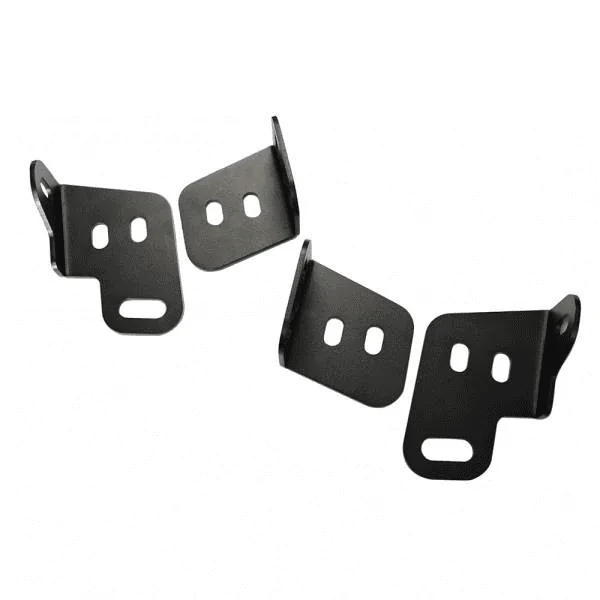

There are these additional bracket pieces available:
Ford Bronco IAG winch mount - anyone installed yet? 1693157485987
Ford Bronco IAG winch mount - anyone installed yet? 1693157446276
