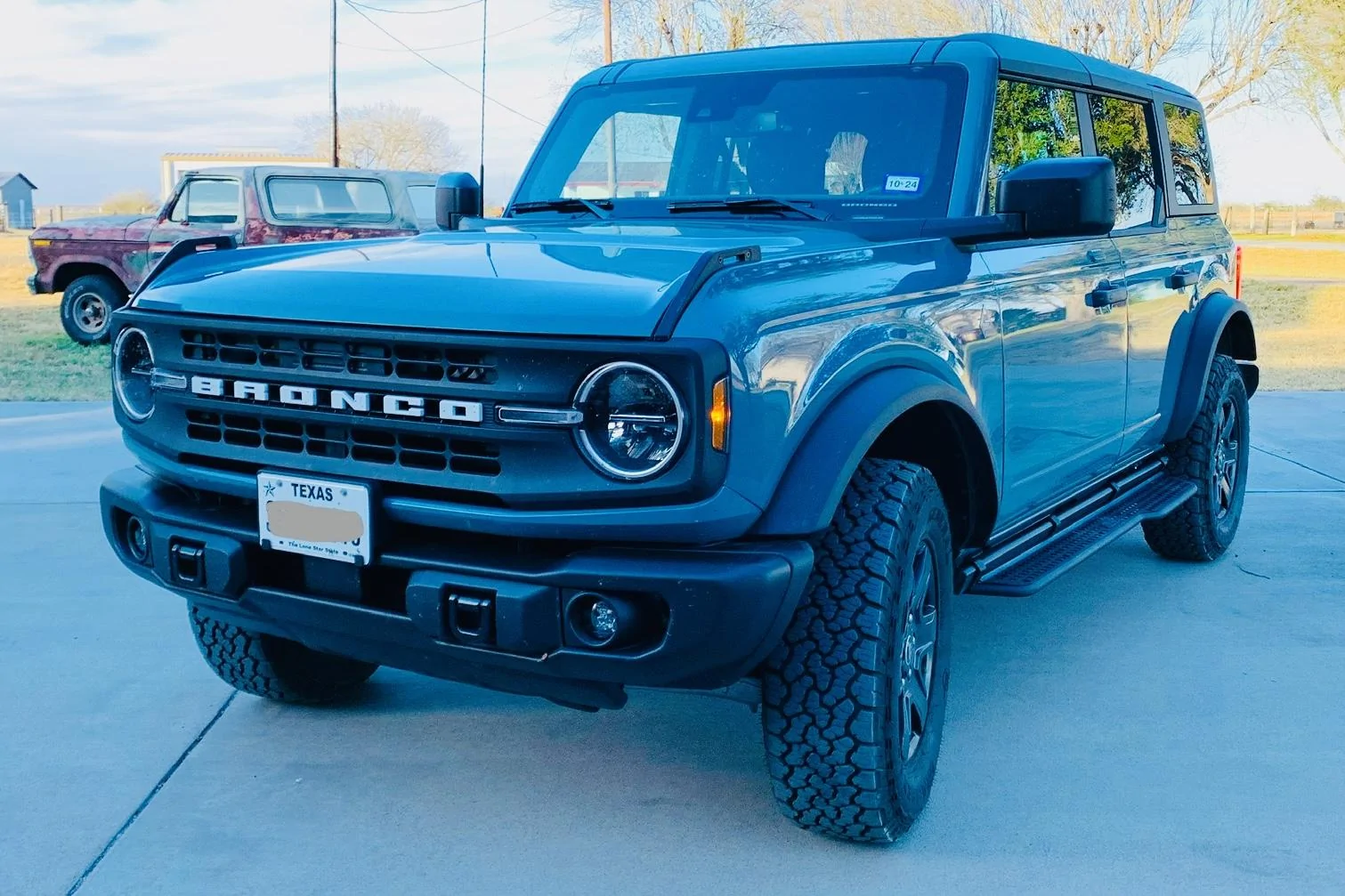

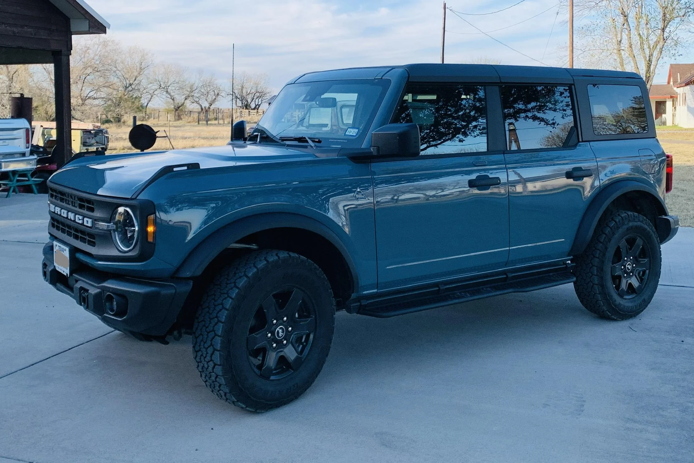

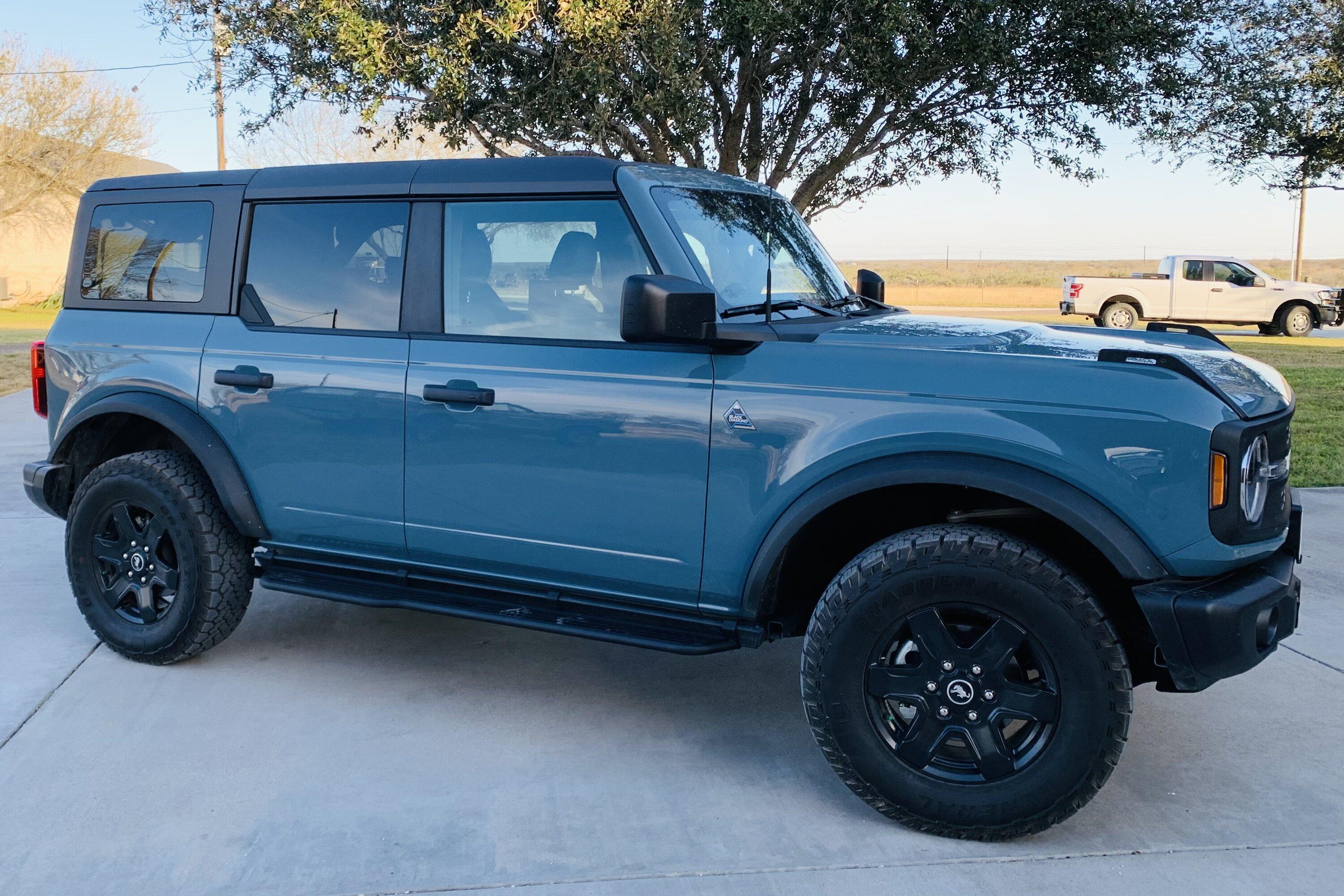

I went with the full length steps. I was worried they’d cause too much of a lowering effect on my stock BD, but I don’t think it made that much of a difference. They are definitely in the way of my husband (6’3) getting in and out. I’m 5’10, and while they aren’t in my way, they are a little awkward for me to use (they set me up too high when getting in, but they help prevent me from sliding off my seat when I get out). They are perfect for my girls (11 and 5 years old). I think they only thing I wish would’ve been different, appearance wise, would be to have them run the same width the whole way through.
