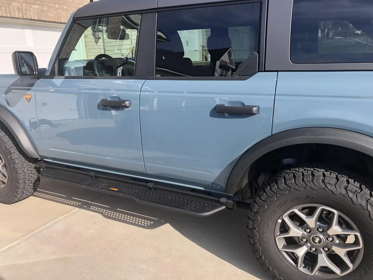

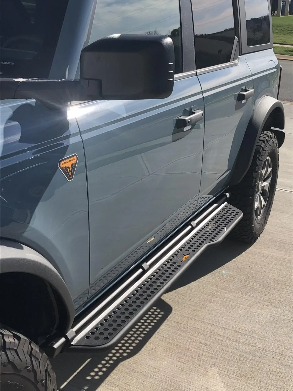

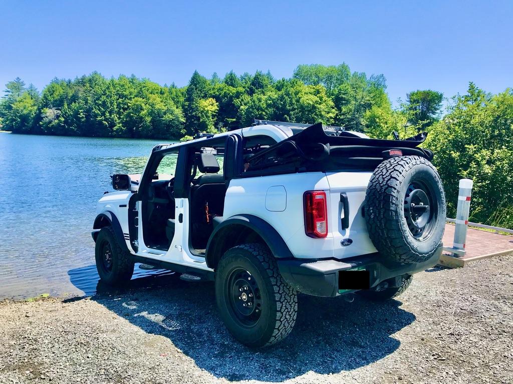

I’m not sure what the rail is called, but they attach to the OEM rock rails that come stock on the BD and BL trims.
70&22bronco
70&22bronco
Fallon
Feb 8, 2022
391
502
1970 Bronco

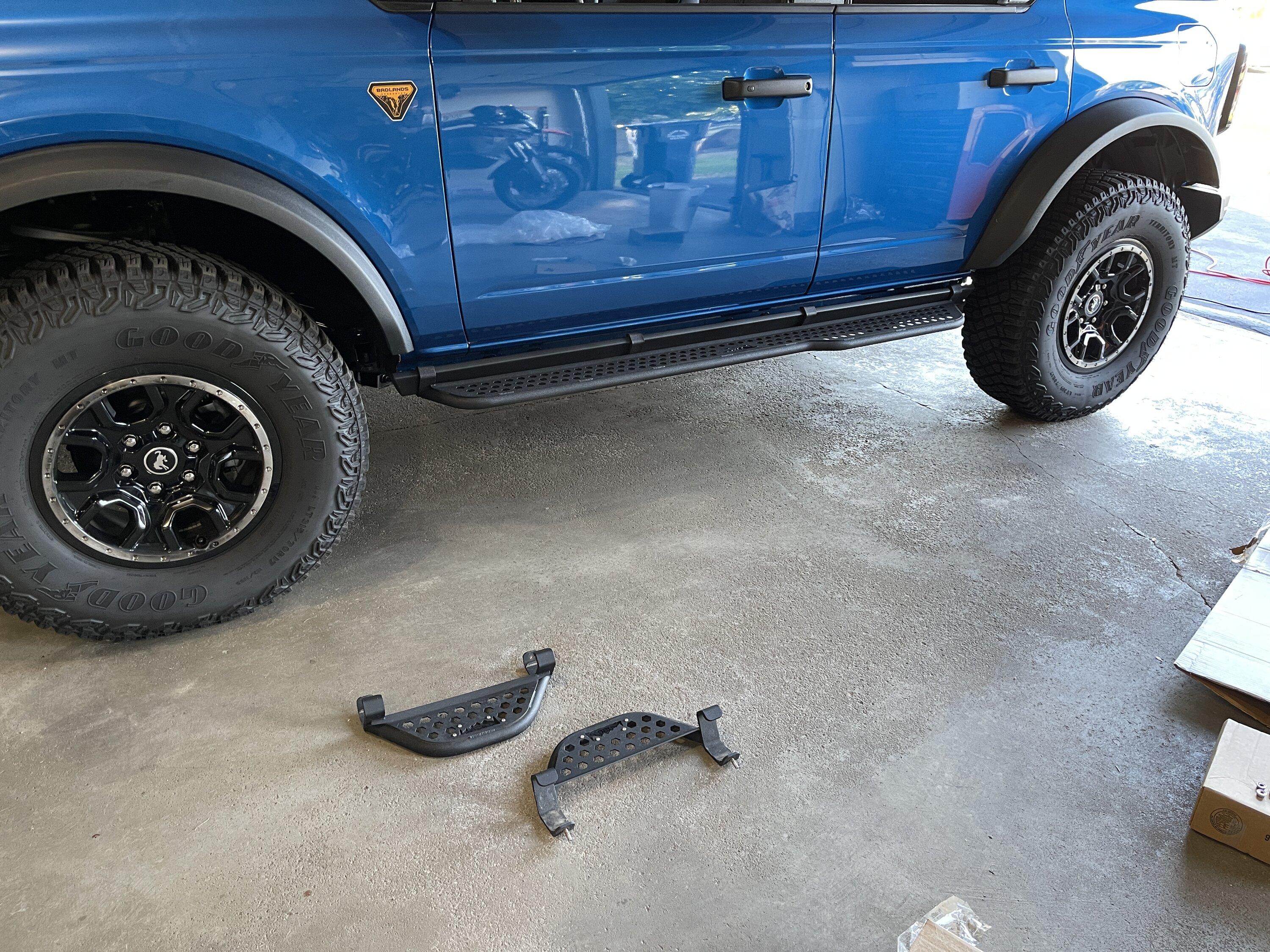

I edited my first post to add this information.

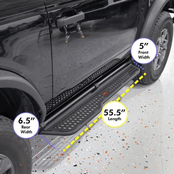

I went with the full length steps. I was worried they’d cause too much of a lowering effect on my stock BD, but I don’t think it made that much of a difference. They are definitely in the way of my husband (6’3) getting in and out. I’m 5’10, and while they aren’t in my way, they are a little awkward for me to use (they set me up too high when getting in, but they help prevent me from sliding off my seat when I get out). They are perfect for my girls (11 and 5 years old). I think they only thing I wish would’ve been different, appearance wise, would be to have them run the same width the whole way through.

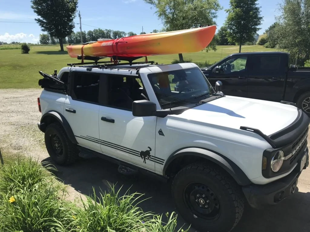

The screw will bite into the back side of the step. I fitted some stainless washers and neoprene washers where the screws hit the factory rock rails. I was concerned about rust over time.

I had this thought too. Haven't pulled the trigger on the steps yet. How did you arrange the washers to prevent the screw scratching through the powder coating?

The stainless washers were small enough that the studs securing the step could center on the washer hole but not go through. The neoprene washer went between the stainless washer and the factory step.

That's an excellent idea! Did you glue the washers together or just let pressure hold the neoprene in place?

Pressure was enough. When I removed the steps after some number of months to swap to the Greenlane aluminum steps there was no damage to the factory sliders.
