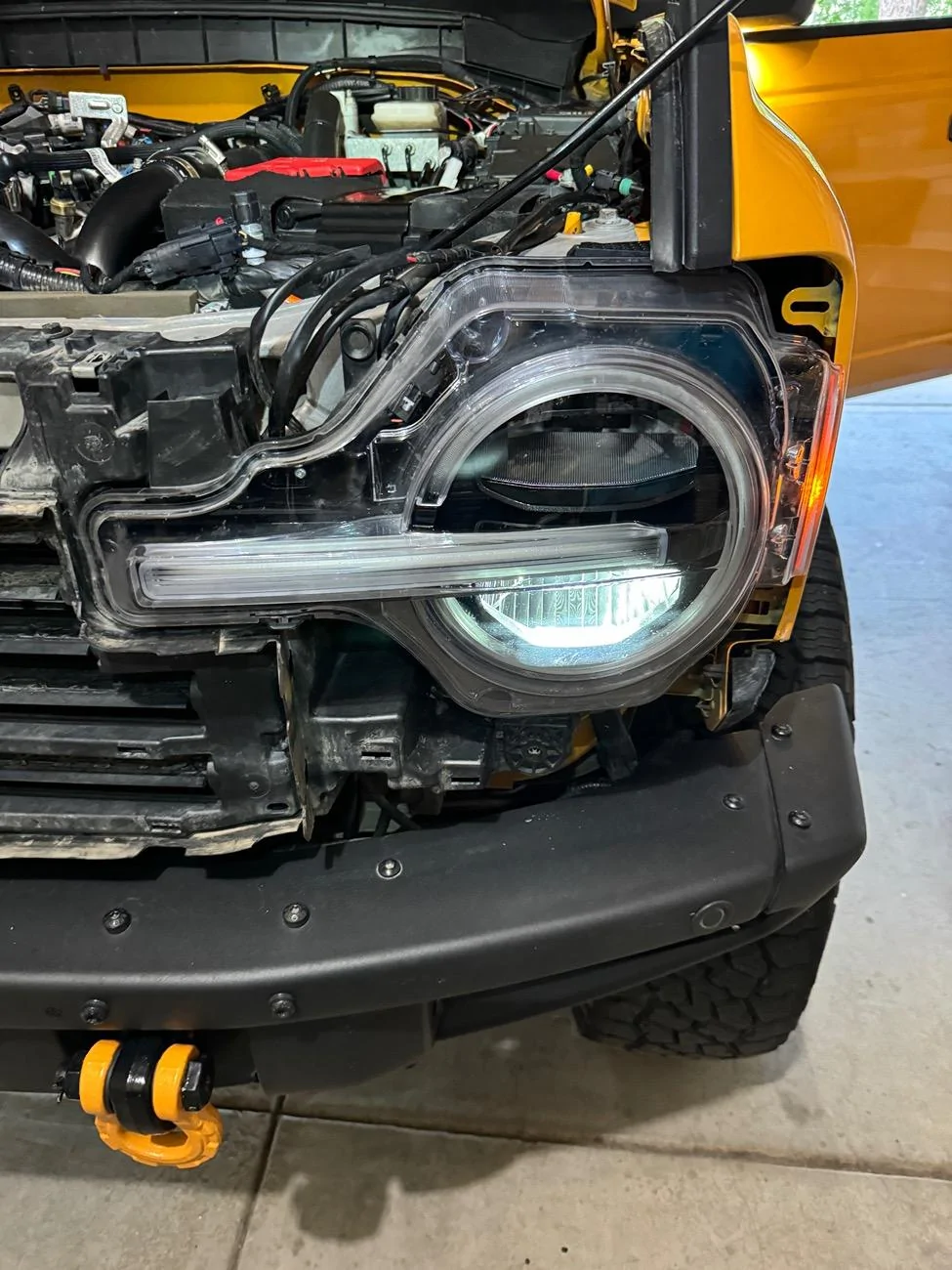

Last week, I purchased a set of Raptor headlights and put them in my Badlands Bronco. I plugged them in and they just worked. Then I took my Bronco to Firestone for an alignment and they rest the Body Control module to fix an issue with the steering wheel not being straight. Now the LEF rings and bars from the lights don’t light up, I get a fast cycle on the turn signals, and the low beam headlights are always on. What do I need to change to get my lights working again?

Do you mean they reset the module? They would be my first stop to ask what exactly they did. Did you have the signature lighting stock or the base lights? I would think in forscan you could switch it back to signature lighting and have them work again. There are also specific lines in forscan for the drl usage.

Did you ever figure out the issue? I’m having the same extract problem. My DRL’s only work when I turn my high beams on
