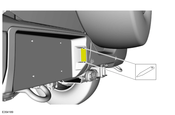

  1. Using a non-marring tool, release the tabs and position the license plate lamp out.
    Use the General Equipment: Interior Trim Remover

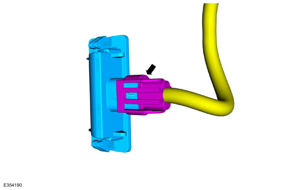

  1. Disconnect the electrical connector and remove the license plate lamp.
