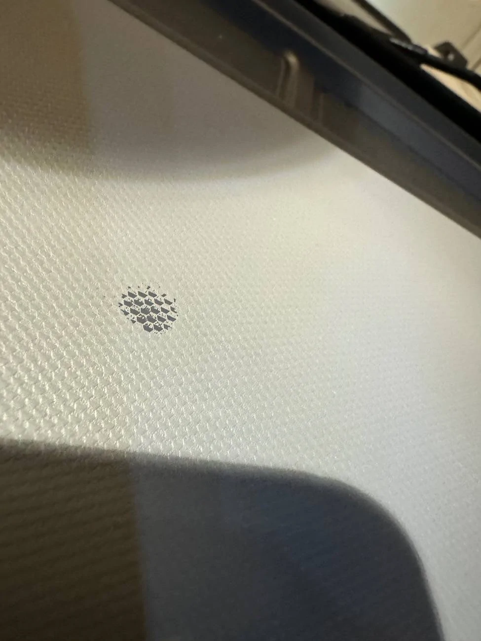

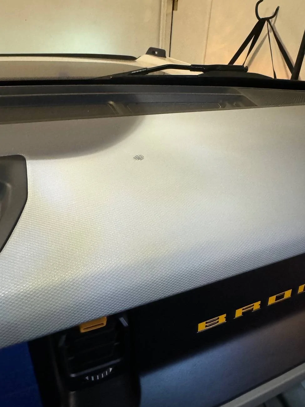

After over 40k miles, I finally had to get a new windshield.

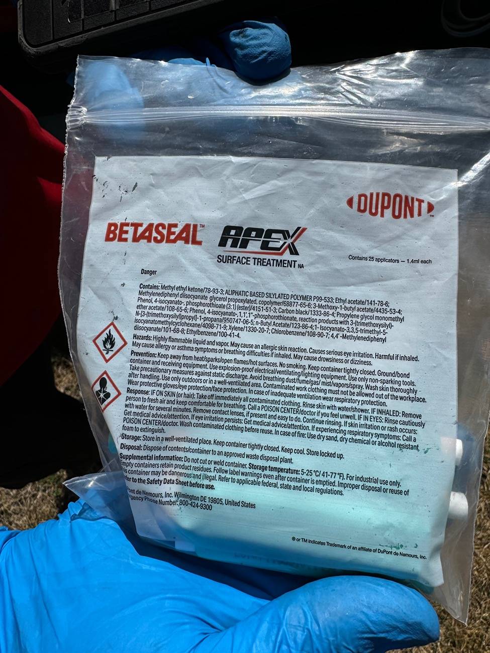

TLDR: The Safelite installer spilled one drop of Betaseal primer onto my luxurious plastic dashboard.
How do I get the spot out?
I'll add some pics here in a second. The installer was forthcoming and apologetic about the mistake, and hey... mistakes happen. I didn't have a cow on him or anything like that. I love my Bronco and would be happy to get the spot out. He said he tried wiping it off and using paint thinner. That made me cringe a little bit because I know plastics (like the dashboard) don't like solvents. The pic I'll post is what was left after his best efforts - and my effort with a wet microfiber cloth, some elbow grease, and then also a microfiber with isopropyl alcohol.

Find some touchup that matches and tiny brush? That's nasty shit and short of a getting in there with a dental pick or plastic razor blade and gently removing, no idea what type of chemical will take it off and not damage the plastic. Maybe start with isopropyl and see if that loosens it up any, I'd tape off around the spot in case it starts bleeding.

Just spoke with my body shop manager and he said there's nothing that takes Betaseal off including lacquer thinner. He said if it was fresh, they've had some luck using an aerosol named Fastball but best bet is tooth pick and try to get as much off as possible or replace it. Ironically, the folks we sublet our glass to just did a bronco windshield but dropped a tool and gashed the panel. Glass company at the dash.
Sorry about the gash, and thanks for a great idea! I appreciate it when someone who knows what he's talking about shares some feedback.
UPDATE: no luck with the toothpick.

Looks more like the factory color was removed during clean up. Repaint the dash. I’ve thought of doing black.

The closest thing I've seen that might match the dash color and sheen would be a rattle can grey primer. I'm redoing a '75 Ford 3000 tractor and using SEM etching primer which is pretty close to the grey dash and is flat instead of gloss. Rust-oleum has a grey primer that is pretty close too. You could spray a little in a cap and use a toothpick to strategically paint over the primer and at least make it a little less noticeable. The problem with things like this is once you see, you can't un-see it and will either piss you off every time you drive or eventually be able to ignore it.
