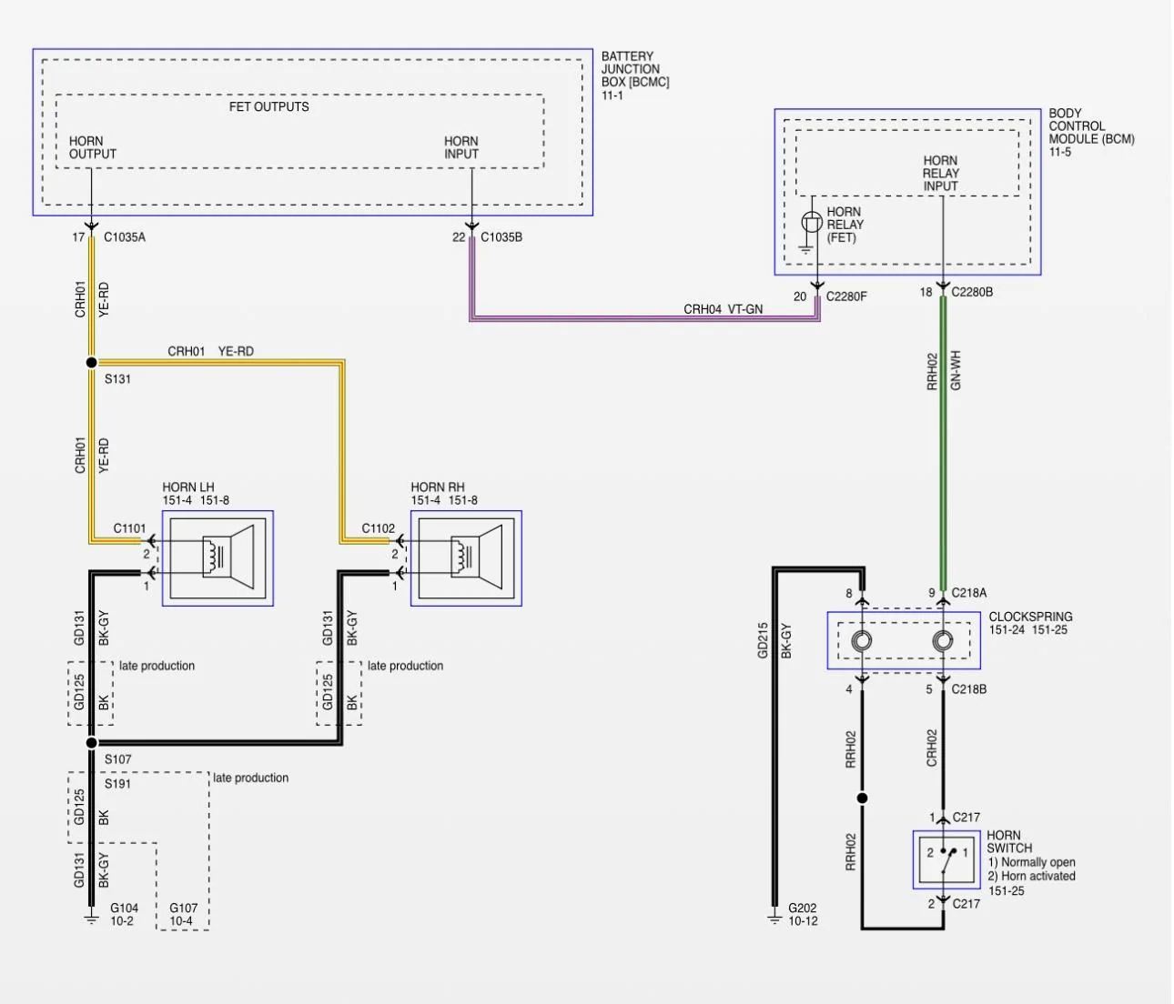

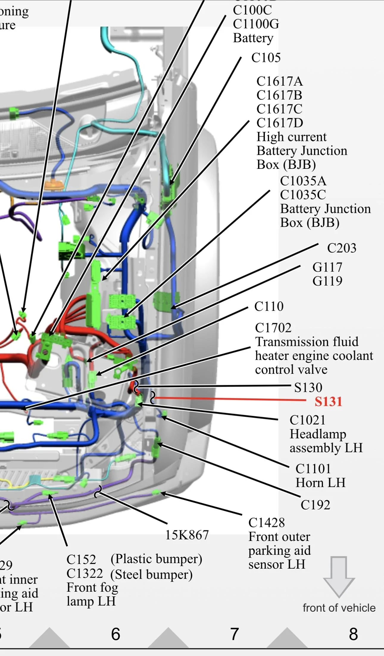

Does anyone know where I can access the main wire before it splits to the two horns? I want to add a switch to use either stock horn or aftermarket horn from the steering wheel.

Splice S131 is where it splits off. It’s near the LH horn. So it would need to be between that splice and where it comes out of the BJB.

It looks like it could be a lot of work to access the wire I need and where I need it. Might not be worth the work.

Yeah depending on where exactly the splice is in the harness, it doesn’t look like there is a whole lot of room to work with between it and the BJB
