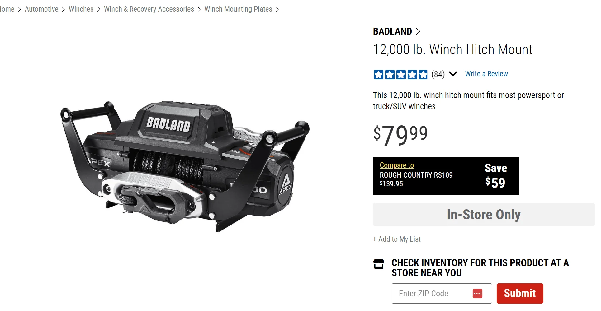

While cruising around looking at recovery gear options, I came across something I hadn't heard of before. A hitch mounted winch. What are the thoughts on this? Note, I have zero experience with any winch solution and am a noob to off roading in general.
Here is a link to the hitch mount that I stumbled across (winch not included).
https://www.harborfreight.com/12000-lb-winch-hitch-mount-57607.html

"Brought to you by the folks who invented the collapsing jack stand, we now offer you the hitch mounted winch!"
I don't see what could possibly go wrong.

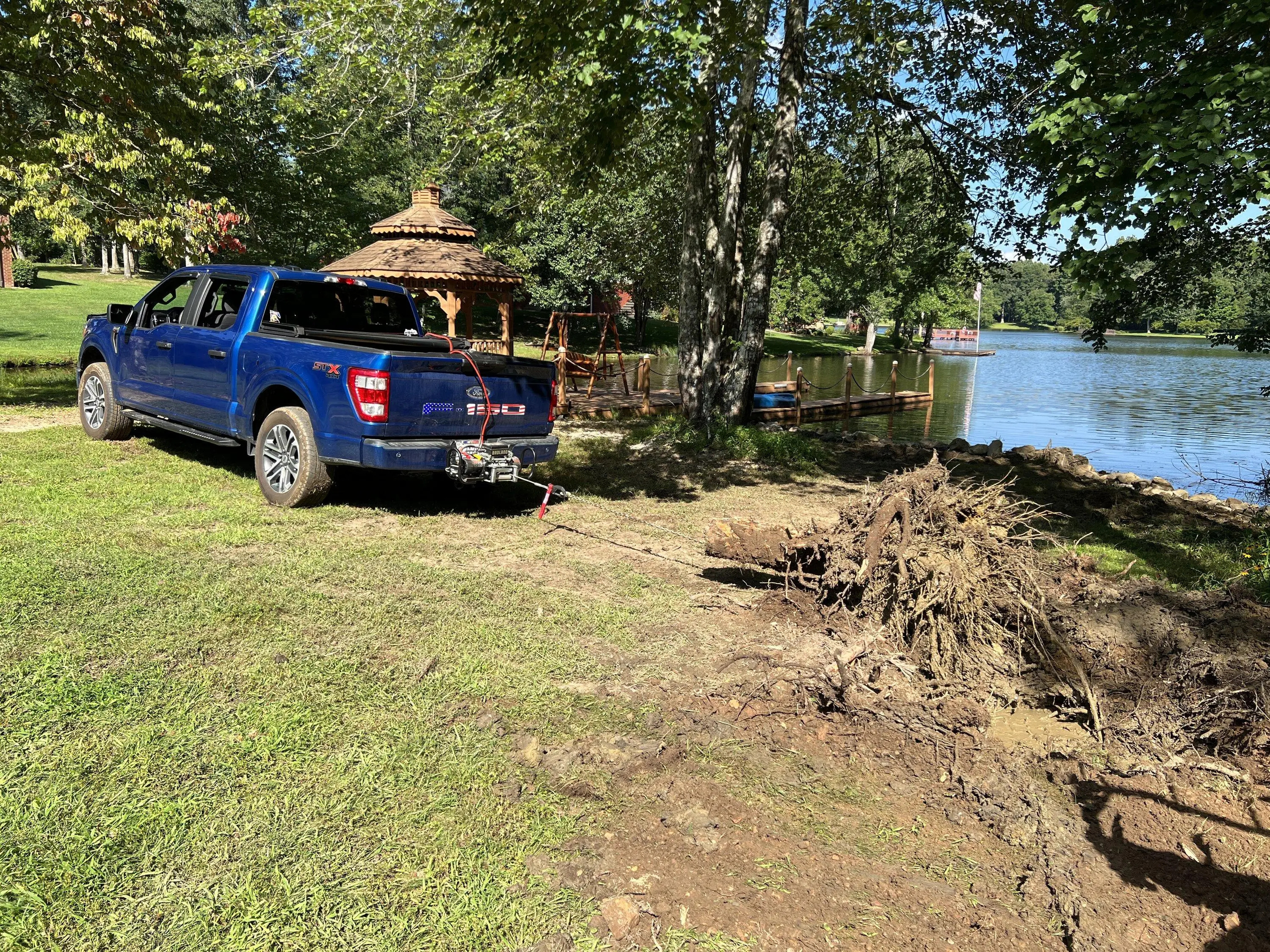

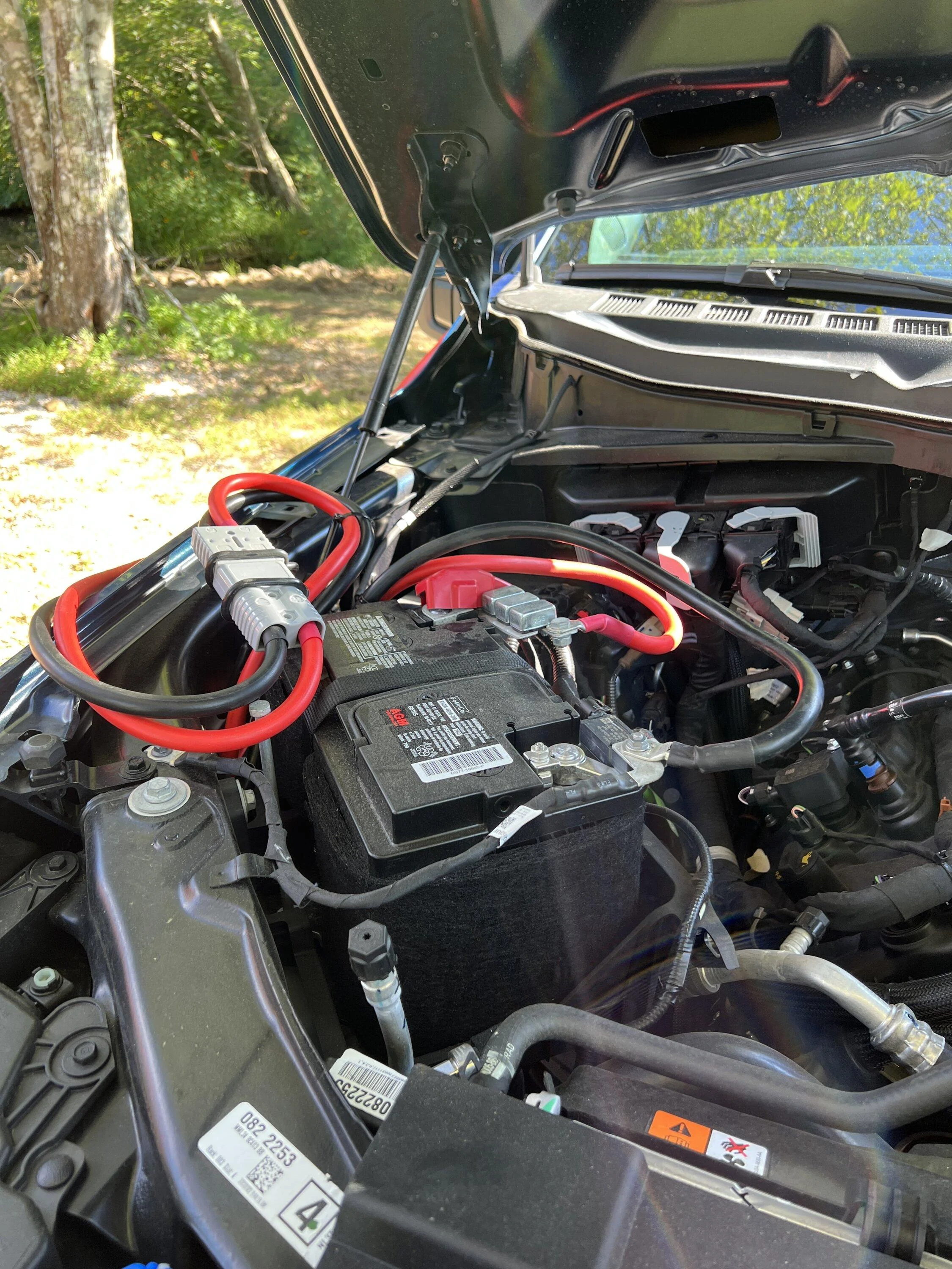

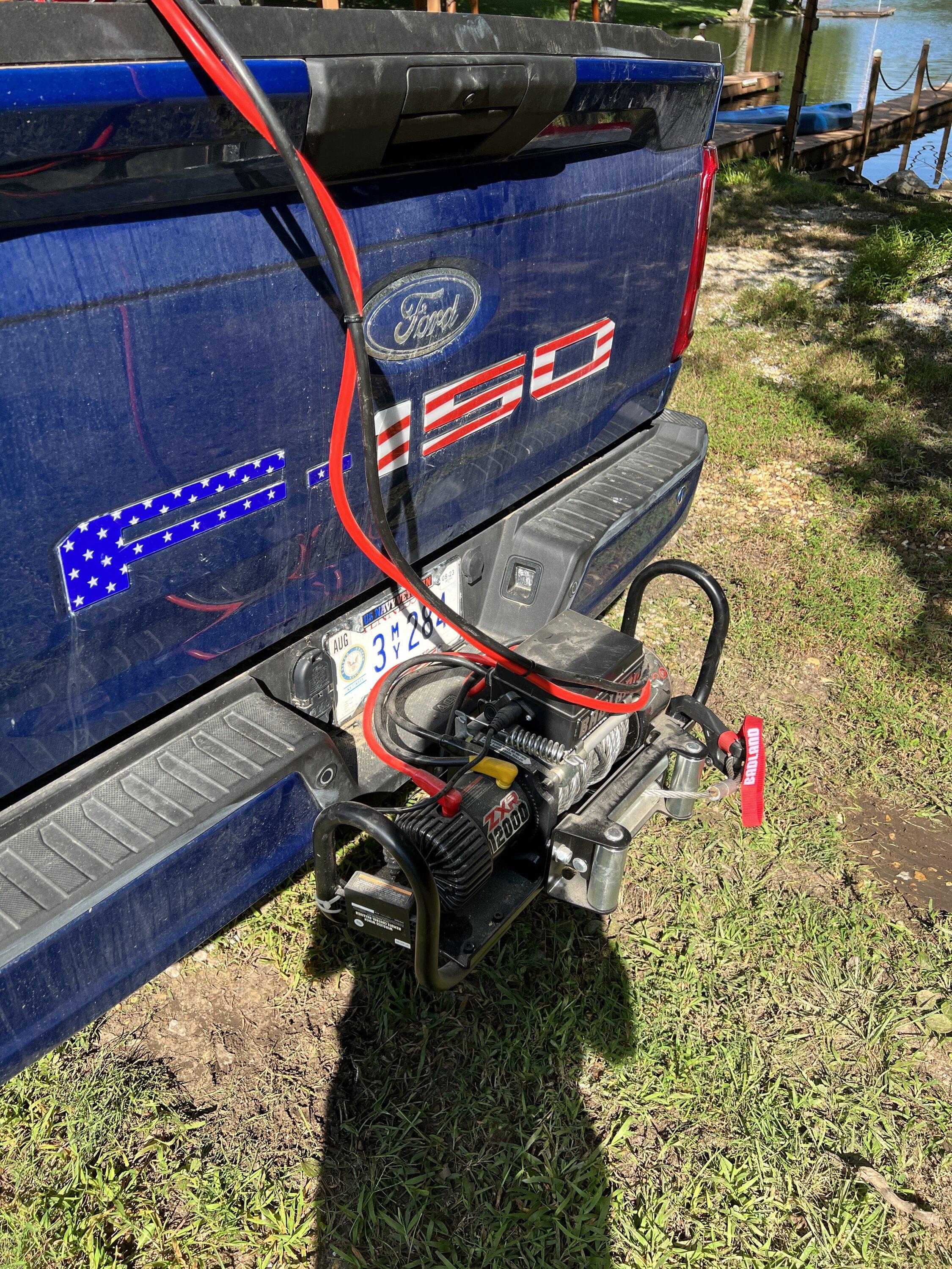

I have a different experience with them. I have pulled stumps with them also got my Kubota BX23 out of a pretty good mud hole with it. I didn't have the bucket on so I could push myself out.
If the stump is too big I use a tree saver and a snatch block to lessen the load on the winch. The trick to any tool is to know it's limits and when it will need help.
