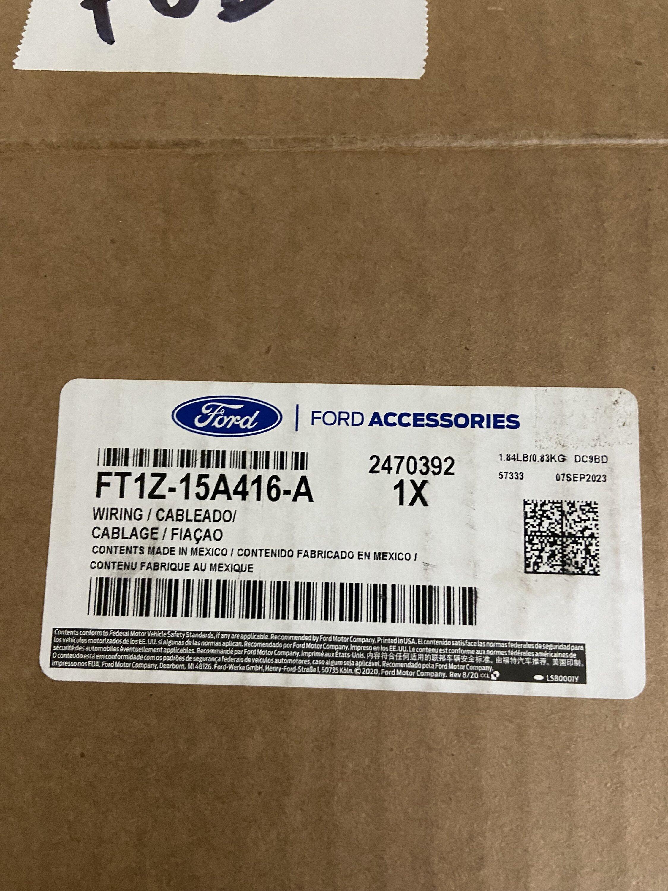

Dealer tried to install an incorrect hitch and wiring to the bronco. Appears it was a kit for a bronco sport. Still no hitch. This is the wiring harness they wanted to install.
Any idea what the correct wiring and hitch part numbers are?

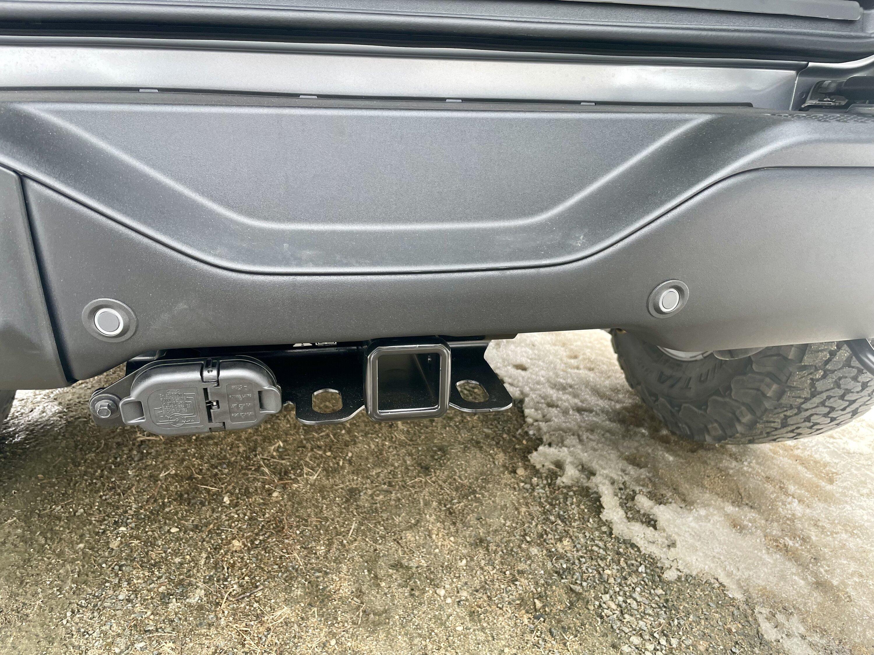

Good they prewired it. Is that standard on the Everglades? Will have to check mine to see if they prewired my WT.
It's not completely wired. I just installed one on a customer's Bronco yesterday and there is a little bit of wiring in the engine bay but all the long wiring has been run
Is there any instructions out there or how much of a pain is this? I picked up my Bronco 2.5 hours from me and they plan on sending me the hitch once it lands. It looks like it was prewired and I figured 4 bolts and the pigtail plugging in.
I picked it up on Jan 29th and still waiting on it.
https://www.bronco6g.com/forum/threads/tow-package.87351/page-2#post-2137009
No additional wiring according to the instructions. Basically install the receiver, plug in the trailer connector, install the module and then it needs to be programmed.
Really? Did you order the tow package when you ordered your Bronco. The cost of install is included. Or is it just because you don't want to make that long drive back and forth?
This exactly. I’ve been playing Uber for my daughter and didn’t want to wait to pick up the Bronco!
Was hoping it’s 4 bolts and done!
Its a little more than 4 bolts. You have to pull the left hand rear load space panel and install the tow module there. The wiring to that is already run, but then there is a connector in the left front wheel wheel that has to have a few wires added to and then it has to be programmed with FDRS
My understanding was the '24 came completely prewired and the above process was for the previous years.
