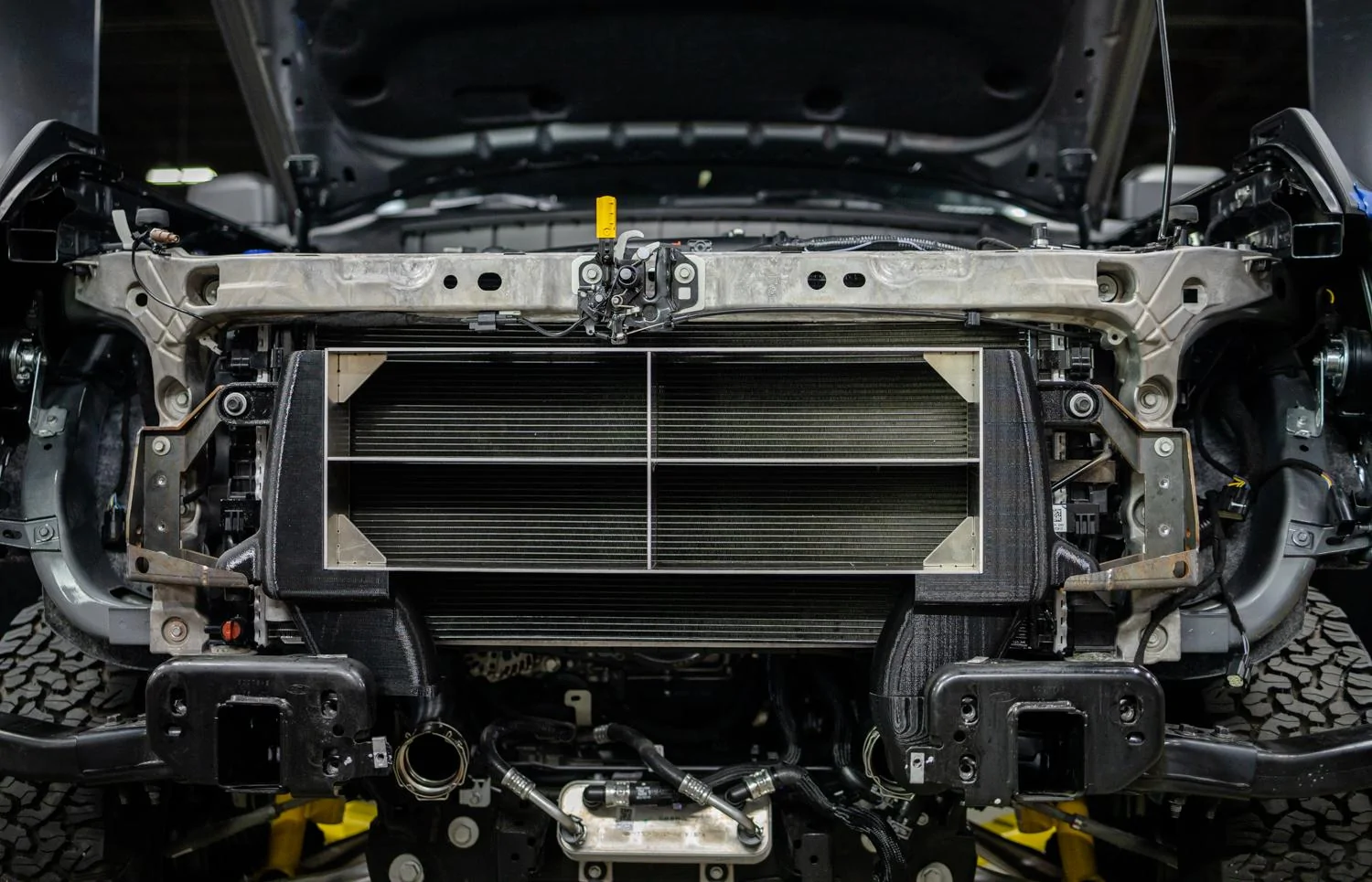

Agreed there is definitely very limited space. Though looking at pictures of Mishimoto’s progress on an intercooler for the Bronco I have been curious if it will be possible to just flip the cooler up and under the radiator more. Seems like it would work in theory but I haven’t really been messing about in the lower sections of Broncos in a while.

If I understand the Mishimoto thread correctly all the structure for the grille, shutters, top of the intercooler, etc. is all over in that area and when they moved the cooler to that position, they also needed to fab up structure to reattach the grille and the shutters they do not reuse.
I believe this is the best setup for a proper "hidden" winch. Tucked right between the frame rails and not sticking way out on the bumper as to not interfere with the intercooler.
Piece of plate from frame to frame and bolt the winch to it. Will work like a dream and not destroy your approach angle.
