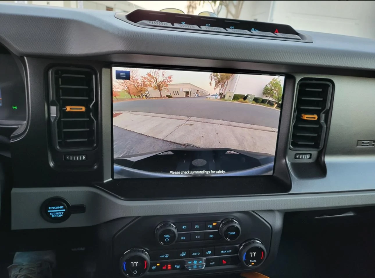

First pic shows no winch on camera view. This would be very similar if you had the winch and relocated the solenoid WITHOUT the bull bar or lights.

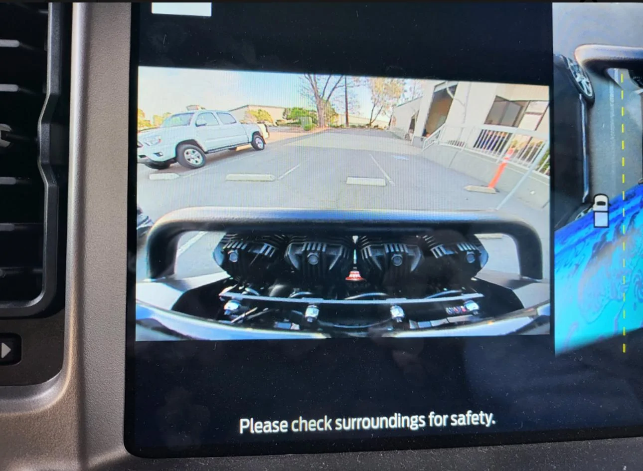

The second shows the bull bar and lights.

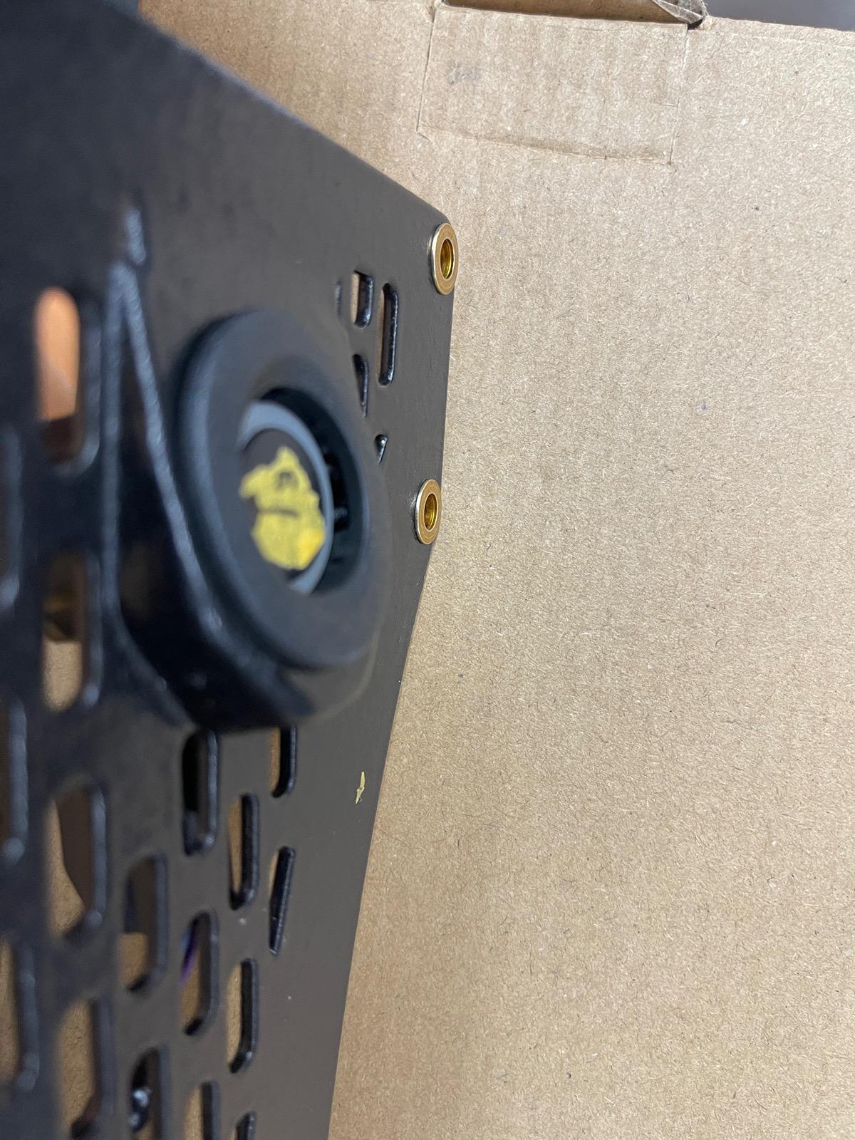

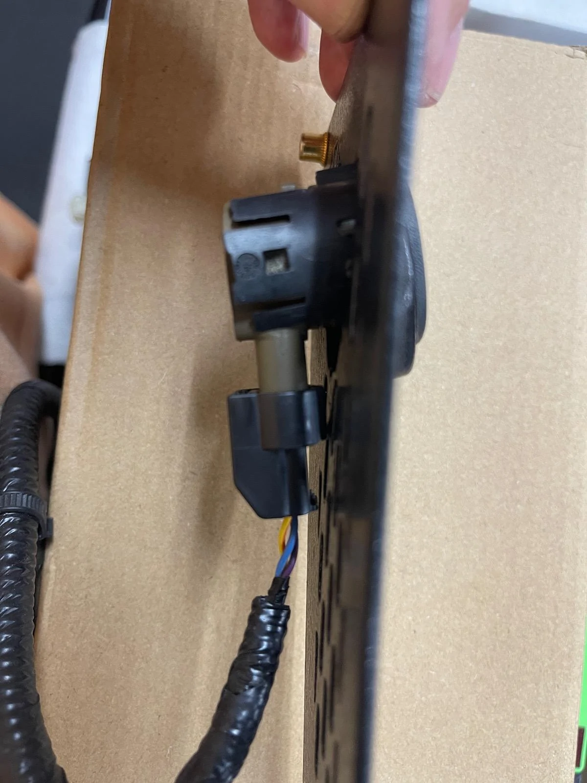

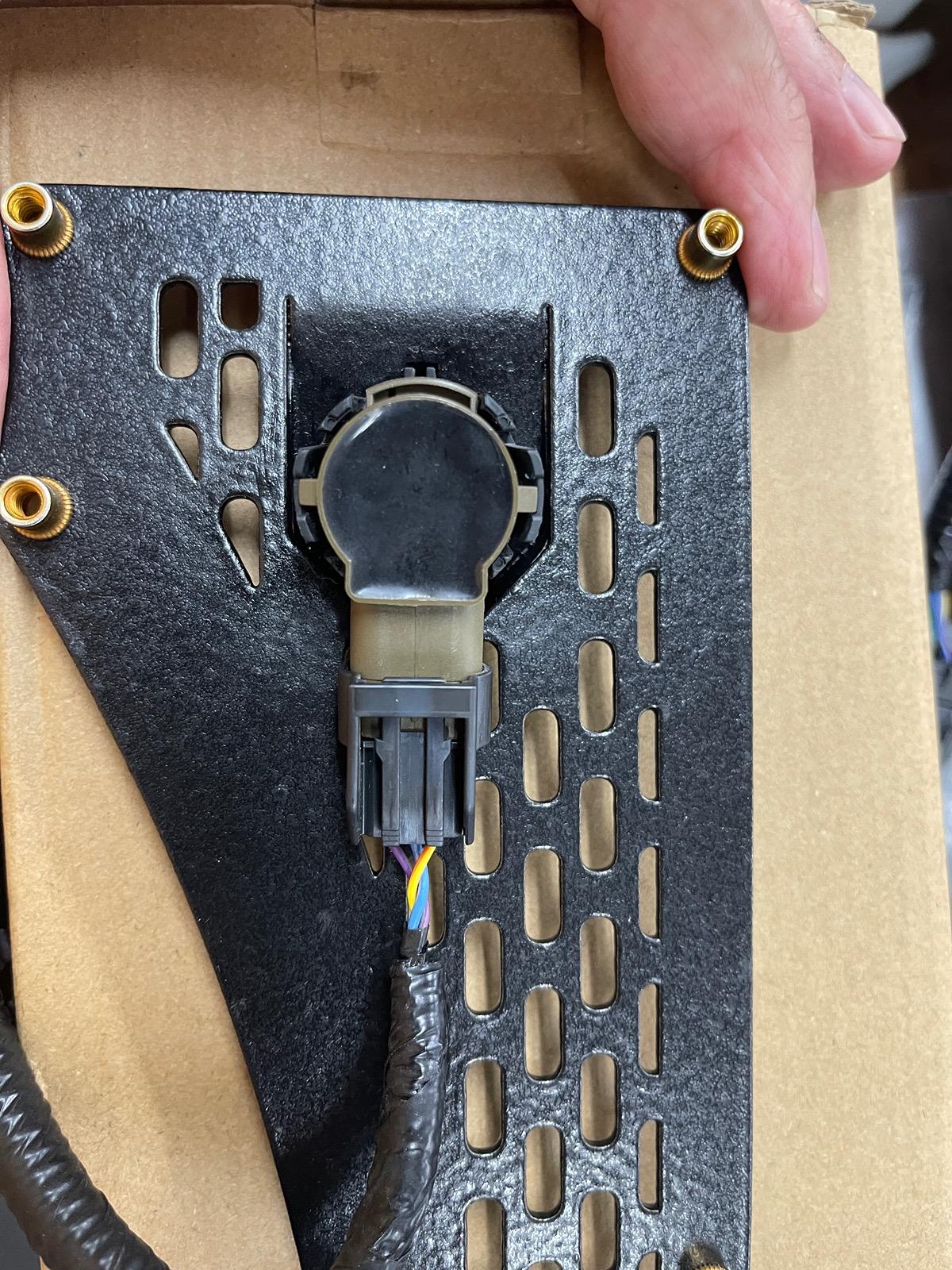

I was trying to fit sensor housings into bumper hardware and ran into issues. I marked each sensor on the face with tape showing vertical orientation when i removed them. The sensor only goes into housing one way. i am making an assumption that sensors are clocked so connector is to the right or to the left 90 degrees from vertical. If i try to install with same orientation, the sensor won’t seat into housing on inner sensor (see photos). If it can be rotated 180 From that position and function ok, then housing opening in bumper plate is keyed wrong and i will have to do some more filing. Sort of a mess. I don’t know if sensor clocking is critical to function. Hopefully someone reading this might know.

Jerry replied very quickly to my inquiry today. Apparently if you switch the housings around to fit BAMF keys they all fit. (I was trying match OEM Position) He said sensor connector can be to right or left.
All i have left is to “de-loom” and fit /rout harness into bumper.
