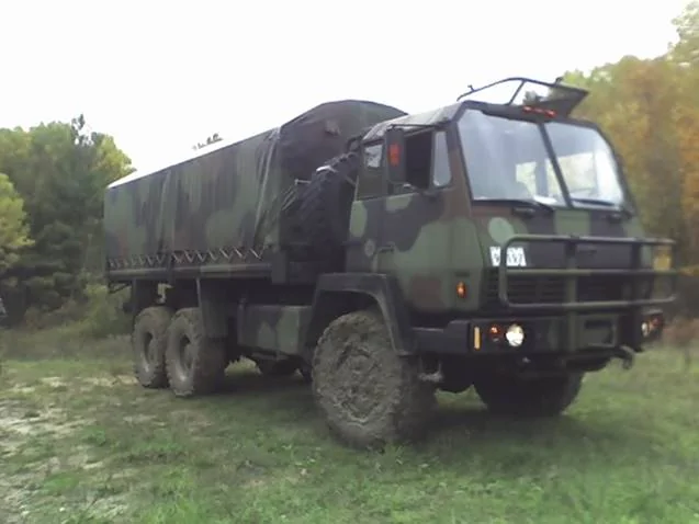

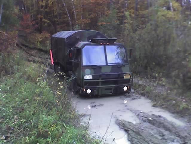

I have tried finding what's available in the world and searched quite a bit through this forum and can't find an answer. The vast bulk of my offloading experience comes from my career in the Canadian Armed Forces and our heavy cargo trucks (the HLVW) used a winching system that you could winch from either end of the truck. The winch was mounted behind the rear axle and had cable guides along the frame to Re-route to the front. We always found it was a very useful feature as we didn't have to screw around with snatch block setups to self recover or pull someone out of the slop. I've been looking at winches for the Bronco and was wondering if anyone knows of any manufacturer that makes such systems you can mount on our vehicles?
Pictures of the HLVW doing it's duty below. The tires on these monsters were almost 4 feet high so the few times we did get stuck, you were F!#cking Stuck!!!! Lol!
Ford Bronco Question for winch Gods HLVW Before
Ford Bronco Question for winch Gods HLVW After

It was a PTO Operated winch but the cable rerouting system was shit simple and low maintenance other than regular lubrication. The cable routing only consisted of "U" Shaped Brackets along the frame to suspend the cable, 2 freewheeling pulleys near the spool and four roller pins on either end of the truck and that was it. Like I said it was a very useful feature. All of the moving parts were maintained with grease fittings of course but it was part of the job to keep it functional.
