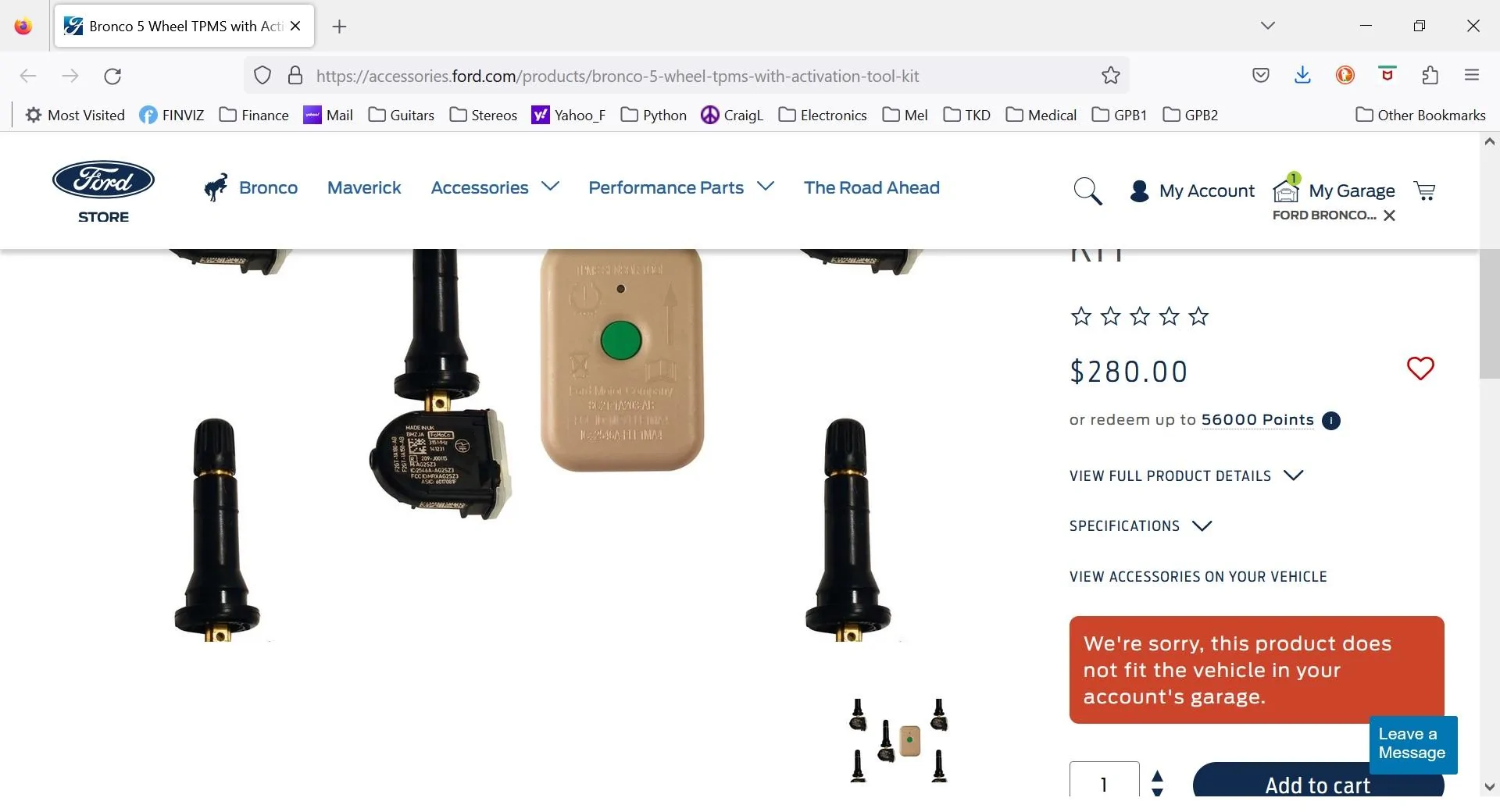

Well, that is the Ford relearn tool. I've seen that enough on Amazon for like $13.00
Looking at the URL itself it looks like the part no. for the TPMS itself is: F2GT-1A180-AB (and) F2GT-1A150-AB and does say 315MHz (141231) and also has a number (8MZJA)
Summary: Seems like your TPMS are correct, but look at the comment I got when I put "2022 Bronco" in to their "garage".
(see attached)
Not sure what is going on... go to that website, put in that part number, and enter in "your garage" what model you have.
(see attached)

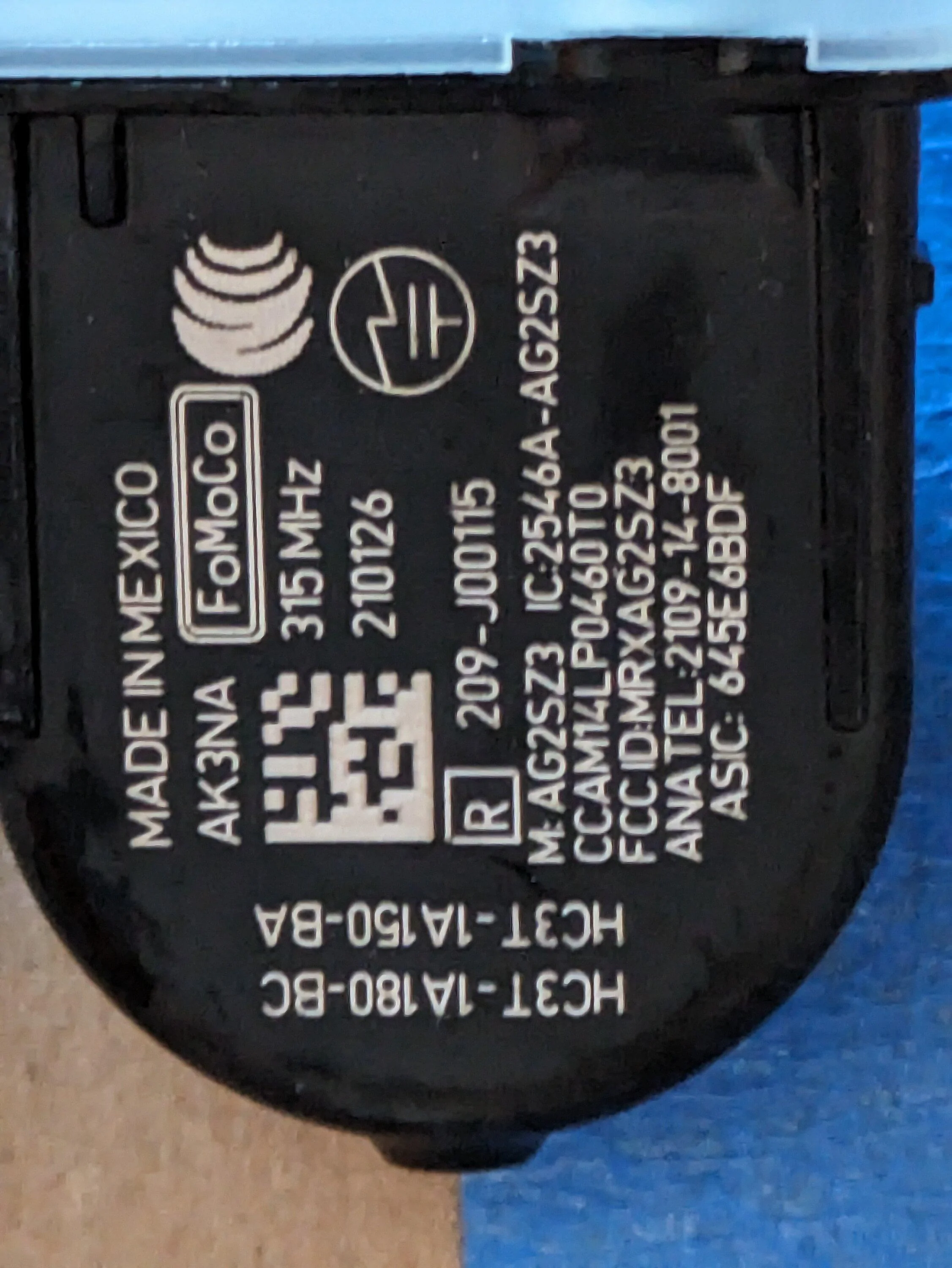

Out of the box I have this is what was in it. I have my new wheels at home prolly swap them tomorrow morning when it's not 95 out.
it was 111f this noon in Riyadh
(see attached)
Oh boy, I get the same message :(

@faris Just want to report back, that after putting the new wheels on my 23 Braptor picked them up right away, I didn't have to use anything to activate them. For once it worked the way it should.
