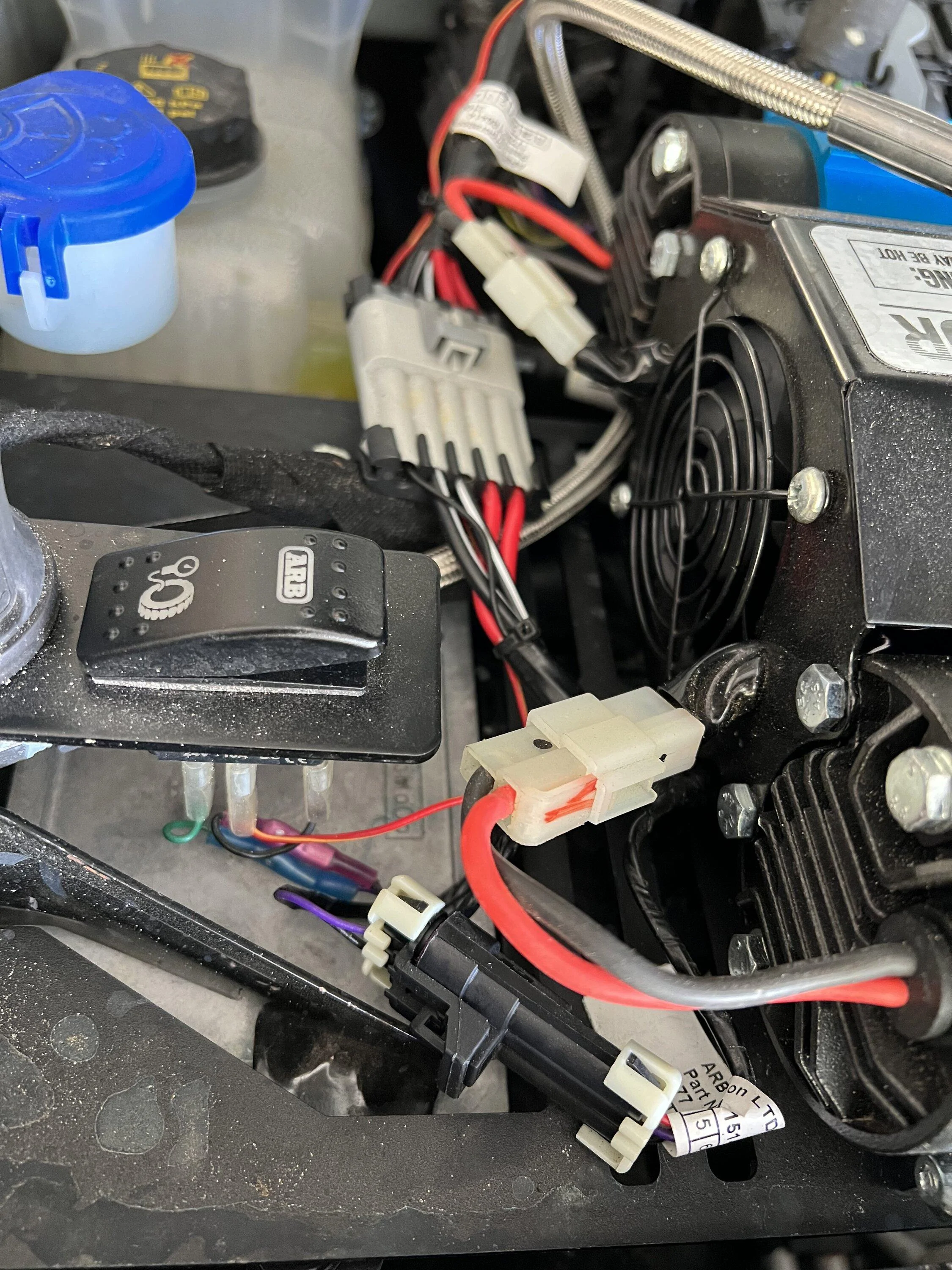

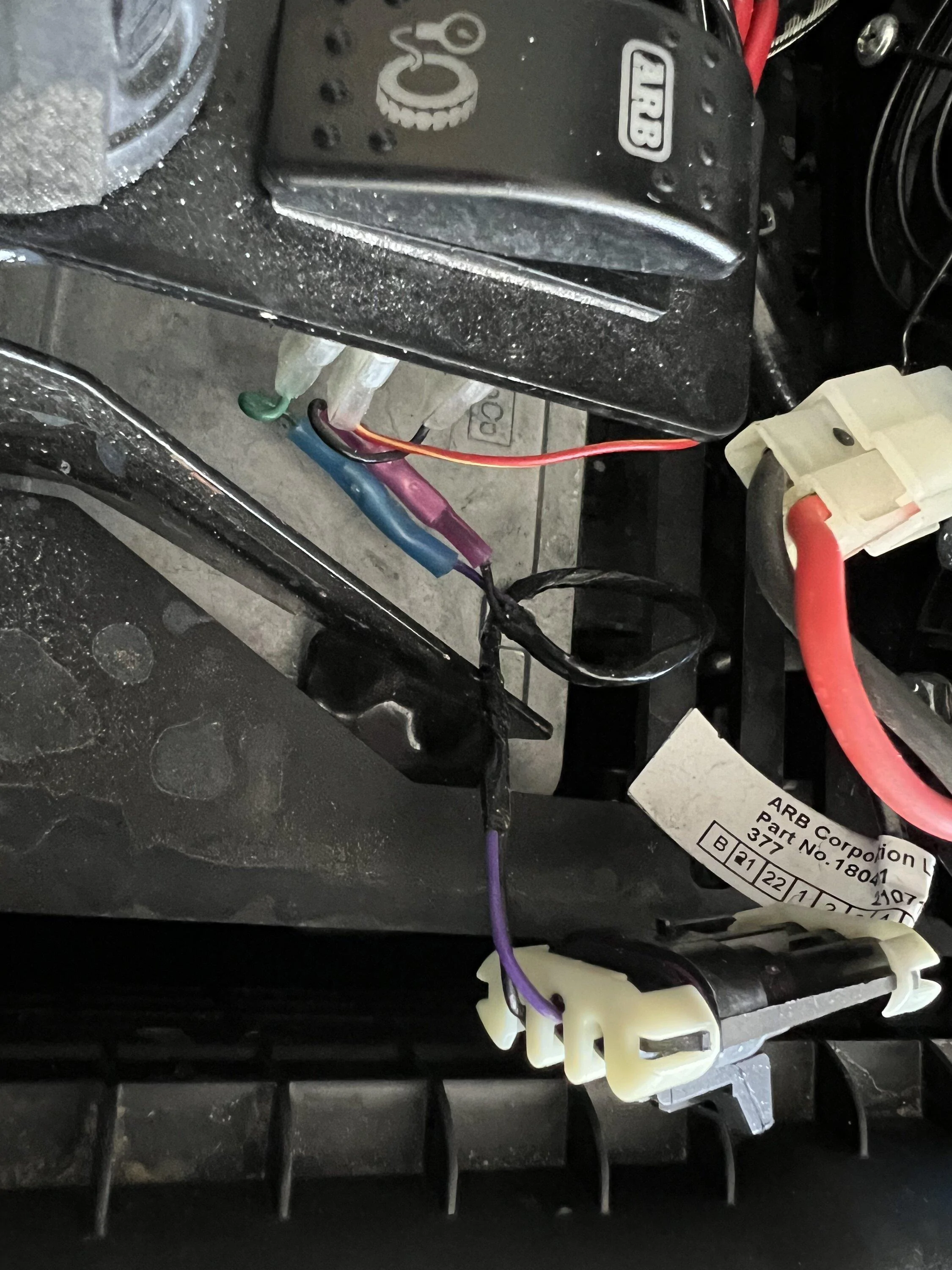

I just looked at a photo I took yesterday. I had the purple and black wires switched… 🤦🏼‍♂️ So that sketch was actually what I intended to do, not what I actually did…
Hopefully I’ll be able to get it fixed this weekend.

I was about to reply that your diagram looks correct. In my setup I have the purple wire going to pin 2 3 of the switch and the black wire going to pins 7 & 8 - I didn't connect red/yellow.
