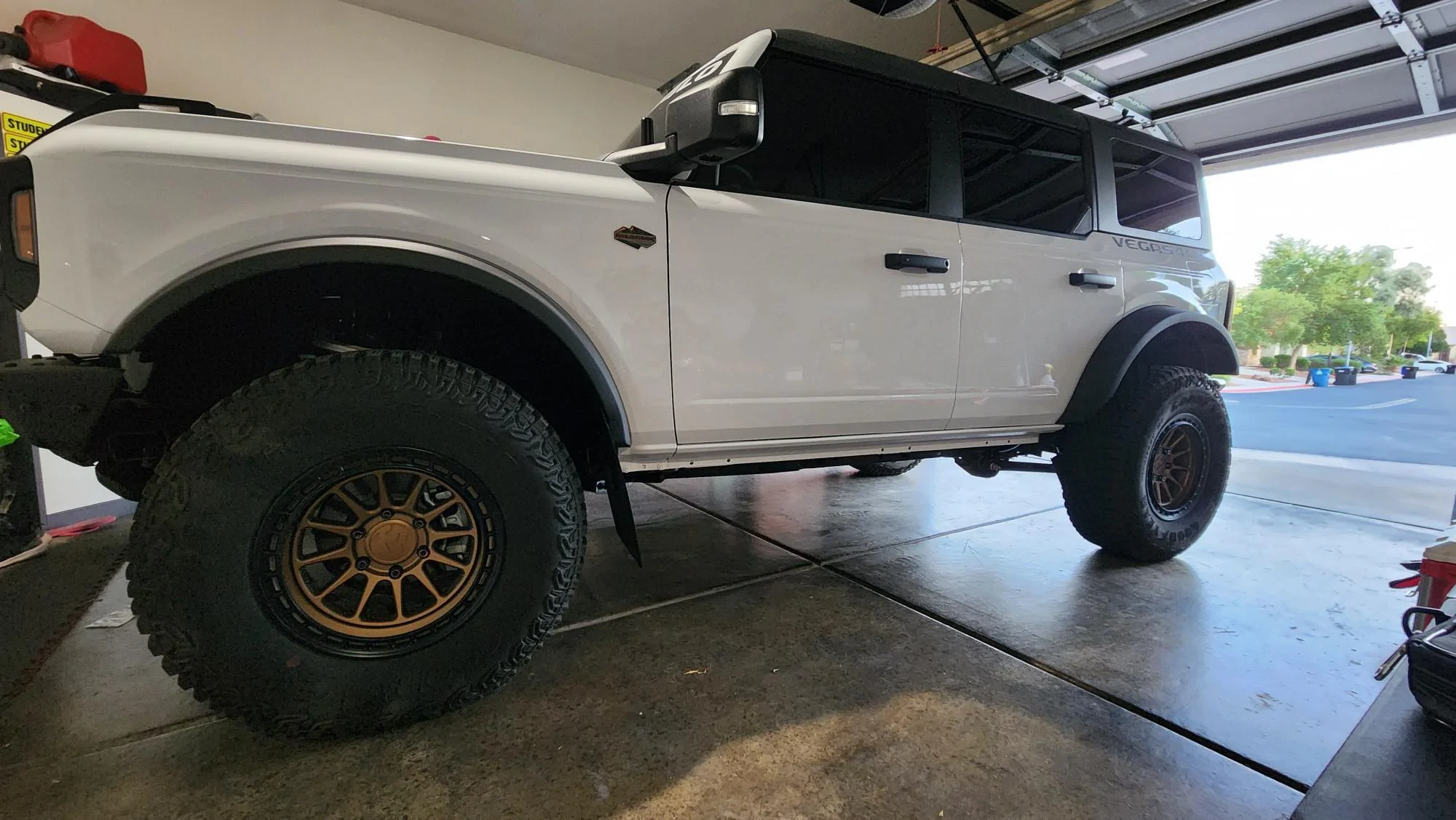

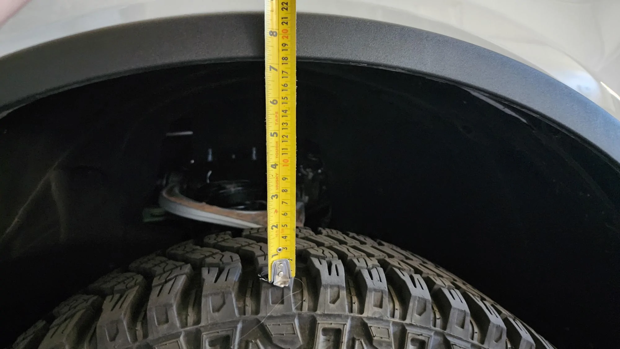

Alright so the install for the Hoss 3.0 RPG perch collar happened yesterday. Ordered the 3" in black, and here is how the bronco sits so far as it's a month old.
Bronco is still very new so haven't had much seat time, just 1500 miles which has 2 trails somewhere in between there. Not new to offroading.
17x8.5 ET0 wheels on stock tires (34 lbs on road)
Rockjock Antirock added to wildtrak
slightly weighted down as a daily, but heavy with full gear on weekends. Only additions as a daily in the rear is Metalcloak bumper and arb twin setup in the cargo area.
Drive home was a mix of highway vs roads, did noticed it being firmer as expected but was a very good drive. Still feels extremely planted to the road. However, the test will be in the dirt. I have a run on Saturday that I "may" take the bronco out on which will show me how it reacts but theres a chance the Jeep will see dirt this weekend instead.
For asphalt, it was not overly firm, even over the more harsher abrupt jogs/potholes, felt pretty much the same.
Will try to get this into the dirt before I make the switch to 37's but that may not happen as well as tires are already ordered through Discount Tire.
First pic is before the perch collars.
Ford Bronco Has anyone RPGd their HOSS 3.0? FB_IMG_1694398168650
On stock tires with collars
Ford Bronco Has anyone RPGd their HOSS 3.0? 20231003_181558
Front gap tire to fender, sorry, didnt get measurements before, should have though.
Ford Bronco Has anyone RPGd their HOSS 3.0? 20231004_090336
Front view - sorry not sorry for being dirty
Ford Bronco Has anyone RPGd their HOSS 3.0? 20231004_090224
Rear gap tire to fender
Ford Bronco Has anyone RPGd their HOSS 3.0? 20231004_090345
Rear view

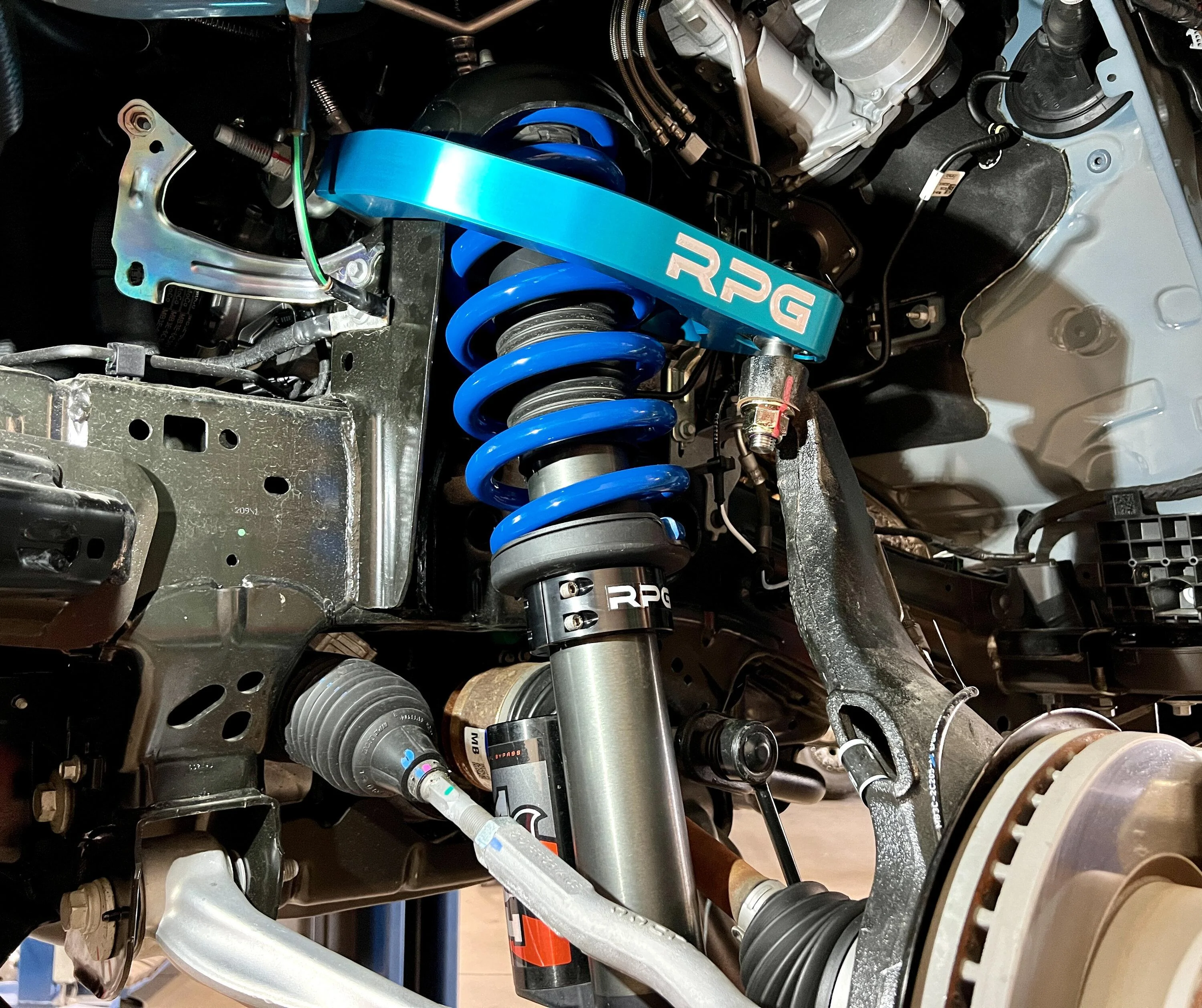

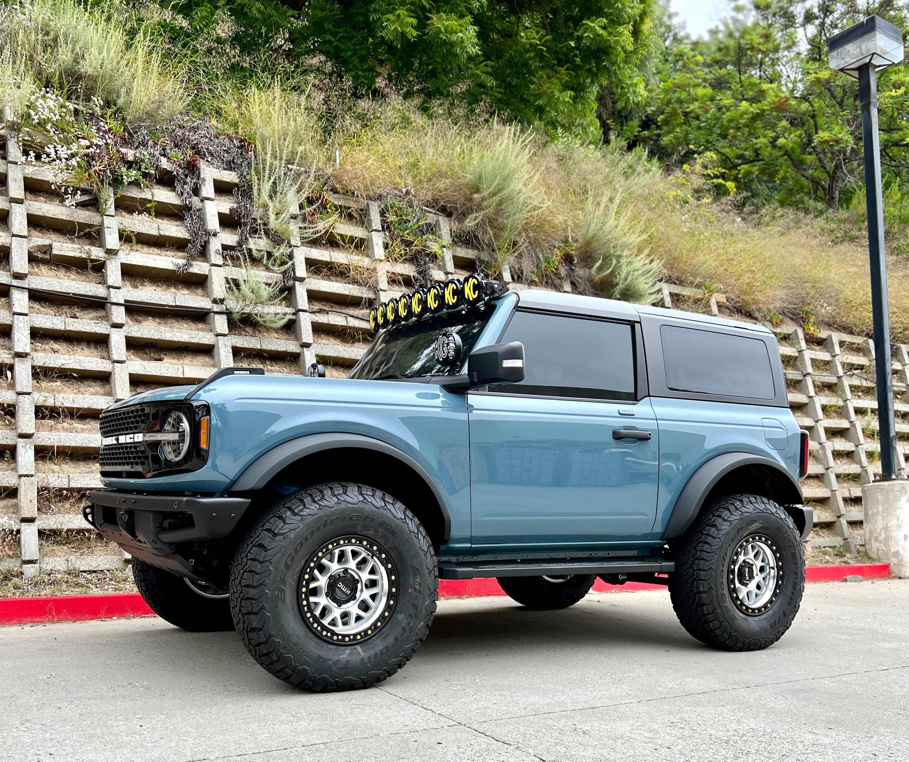

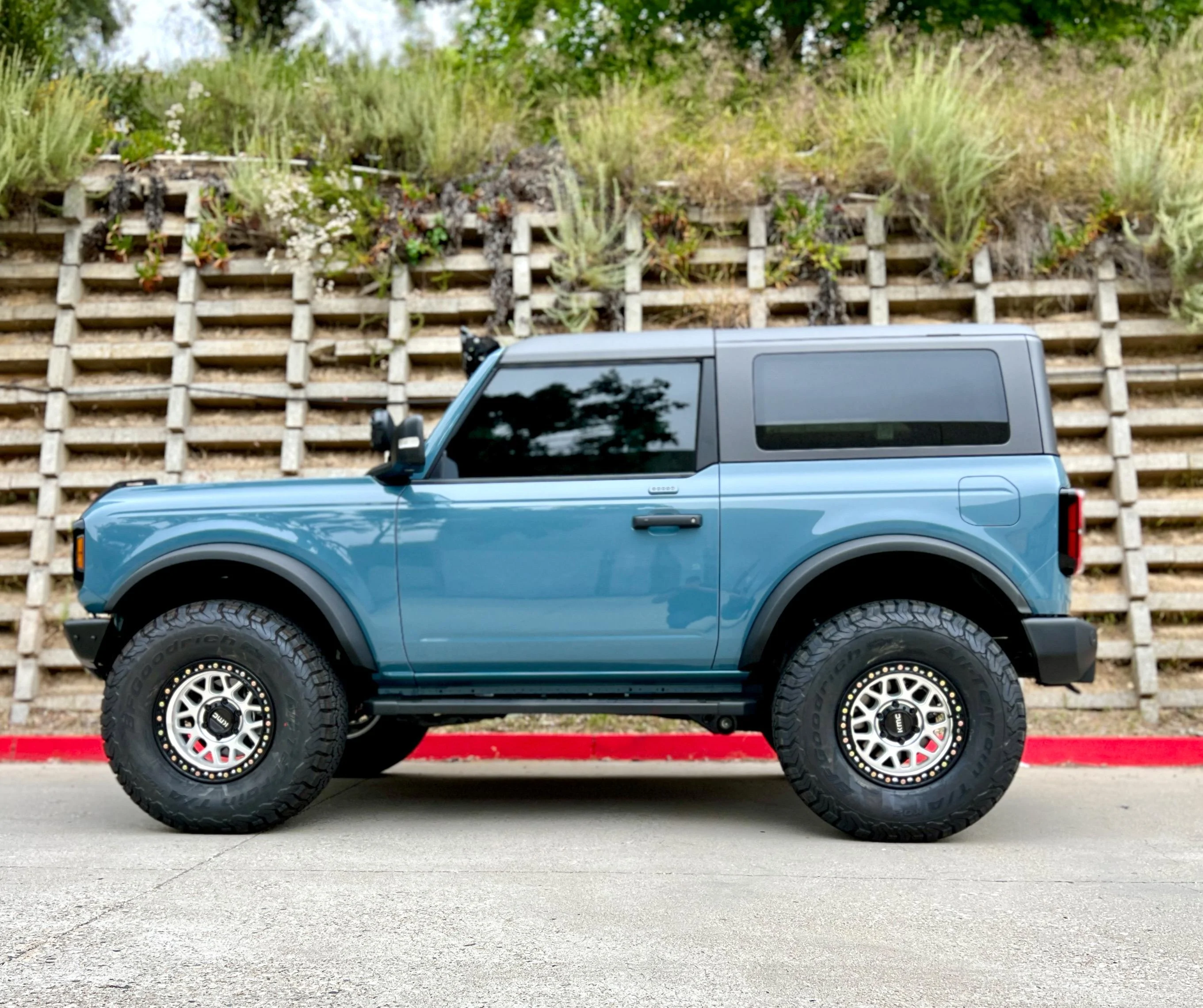

We recently finished a 2-door Wildtrak for a customer with RPG 3.0" / 2.25" collars.
I would say that it slightly changed the way the truck rode from stock due to the additional preload on the springs. The truck still rides great, very acceptable for street and long trips, but I personally noticed a difference in the ride. The customer says they love the way it rides now.
KMC GRS Wheels - 17" x 9" 0mm Offset
37 x 12.5 BFG All Terrains
RPG UCA / 3.0" & 2.25" Collars
Powder Coated Blue Springs

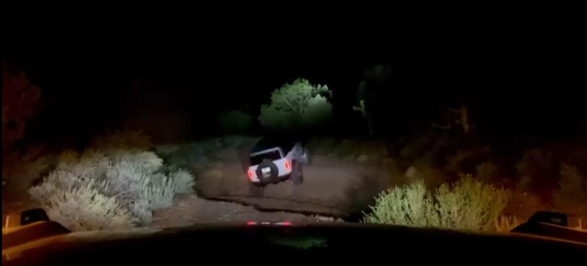

So I did get out on the stock tires with the 3" RPG last Friday night. Wildtrak paired with rockjock antirock on 14lbs tire pressure was absolutely fine in the dirt whether it was slight washboards, or crawling down into and out of ditches.
Used rear lockers one time on a short and steep ditch but that was more from me testing to see just how the bronco would handle it and didnt realign once I started slipping.
Would I go this route again, absolutely. Rides awesome on the highway and great in the dirt still. And I also have a pretty well modified Jeep that I am used to. The only thing I am going to order in the immediate future is an adjustable trackbar and bracket to get it more level. Not a huge difference but its off at an angle and I want it levelled out.
Eventually will have the entire suspension swapped out, but that'll come later in 2024 as budget is tight. Nothing like dumping $$$ into 2 separate rigs. 37's going on Friday or sooner. Will get dirt time on Sat.
Apologies for the poor quality pics, it's all I was able to get off a buddies video. Pics/vids weren't priority as we faced a couple of closed trails and eventually found one that was open in the area.
