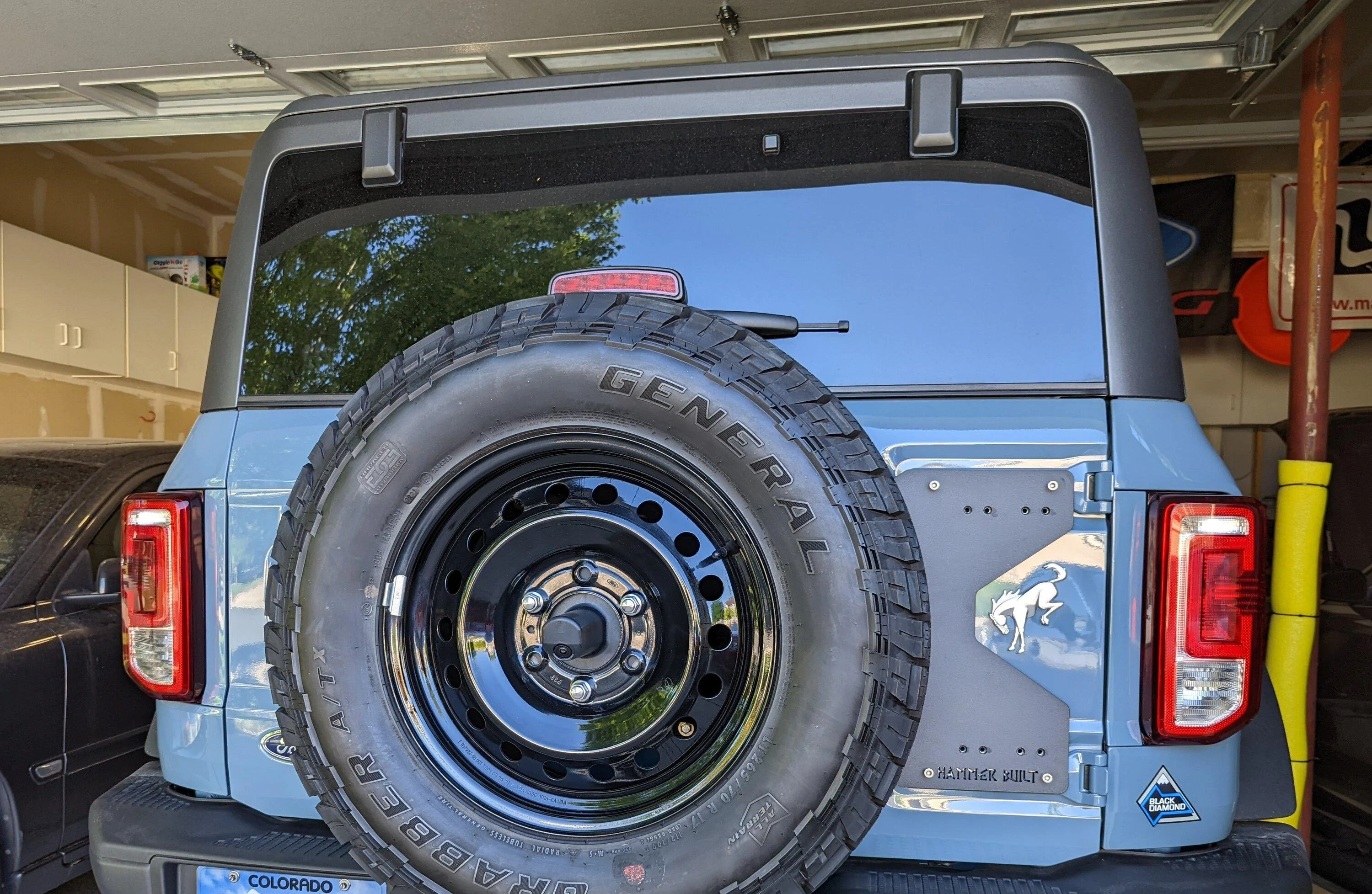

Just as more info after some digging around. This made the rear door so much more solid, and it closes with a solid feeling now where it didn't before. It has also eliminated all of the creaks and squeaks I was hearing from the gate. Great product!

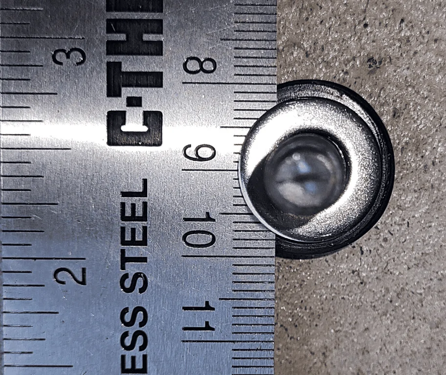

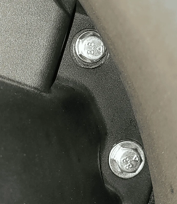

I used some washers that were left over from installing skid plates. They are M8x20mm washers. So, a bit under an inch OD. I only had 6, so I used 2 of the supplied washers that came with the tailgate support. You can see the difference in OD in the pictures. The top is the supplied washer and the bottom is the 20mm washer I used. I've also included a picture with the original bolt and the supplied washer. You can see the size difference. It probably wouldn't have been an issue if the holes in the plastic carrier weren't a bit larger than expected. I'm assuming it's to compensate for slight variations in the plastic mold.

checking into this as we speak...
Can you to see if the bolt holes in your tire carrier much larger than the bolts threads? if so what was the prodution date of your bronco?
The larger indented circles around the bolt holes on the oem tire carrier are from the plastic injection molding process..
thank you for brining it to our attention

My spare tire is back on the vehicle and the larger washers are on, so I can't see directly. But, I do remember that on a few of the holes that the supplied washers didn't quite cover the bolt holes. They holes were definitely a bit larger than expected. My build date was early December 2021.

strangly enough we have the same build date. I don't recall mine having holes larger than the bolts..
Coincidently I will point out that our latest hardware has larger diameter washers for the tire carrier so this won't be an issue for anyone in the future...
@Stonetree feedback like this is crucial to developing new products, if anybody else has any suggestions or comments at all, Please reach out! I want the community to be as involved as possible in the parts we bring to market!

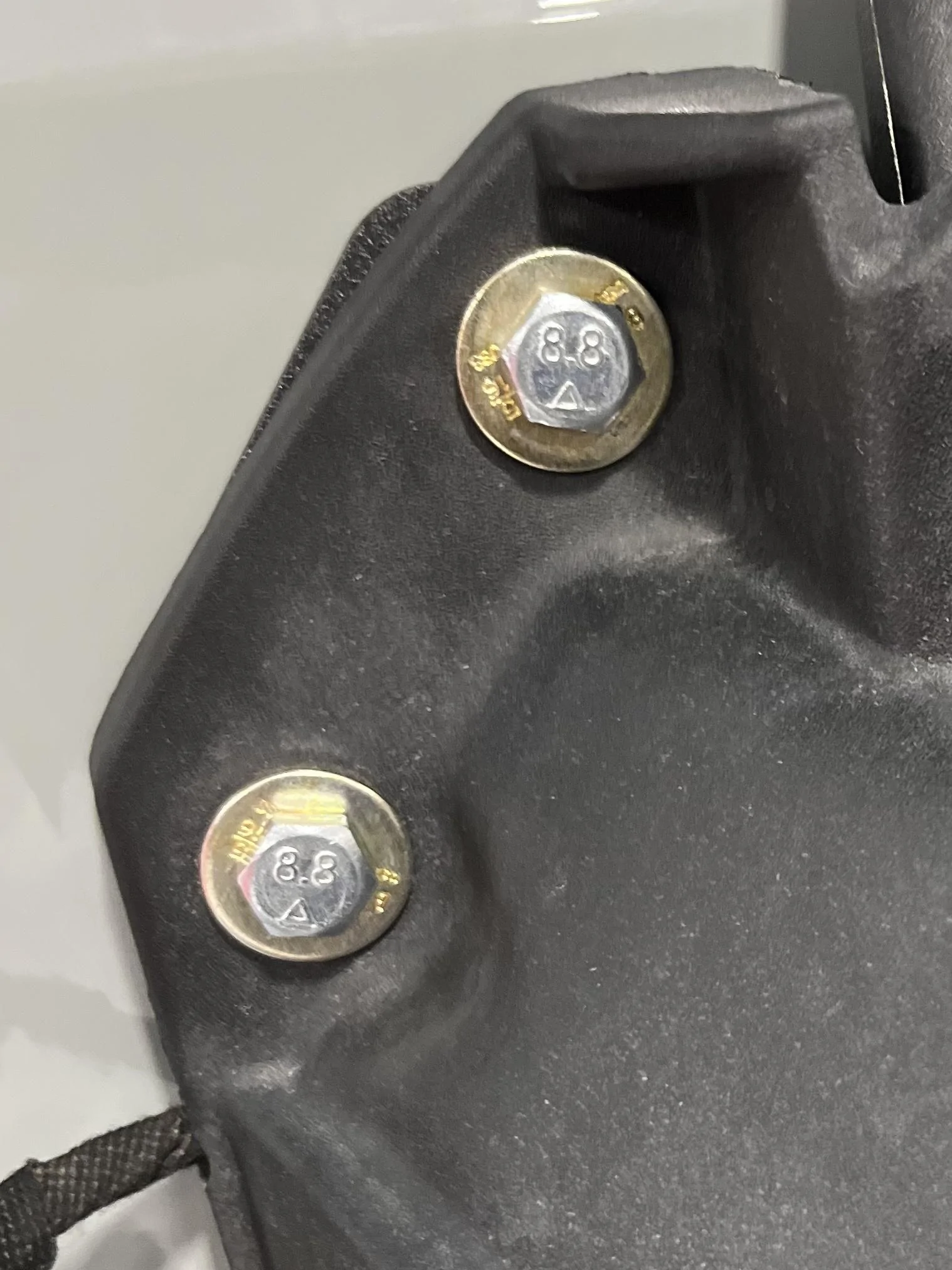

Here is the hardware our latest batch was sent out with.
if any body has an issue with the tire carrier holes being almost the same size as the washer, we’ll get you taken care of.
