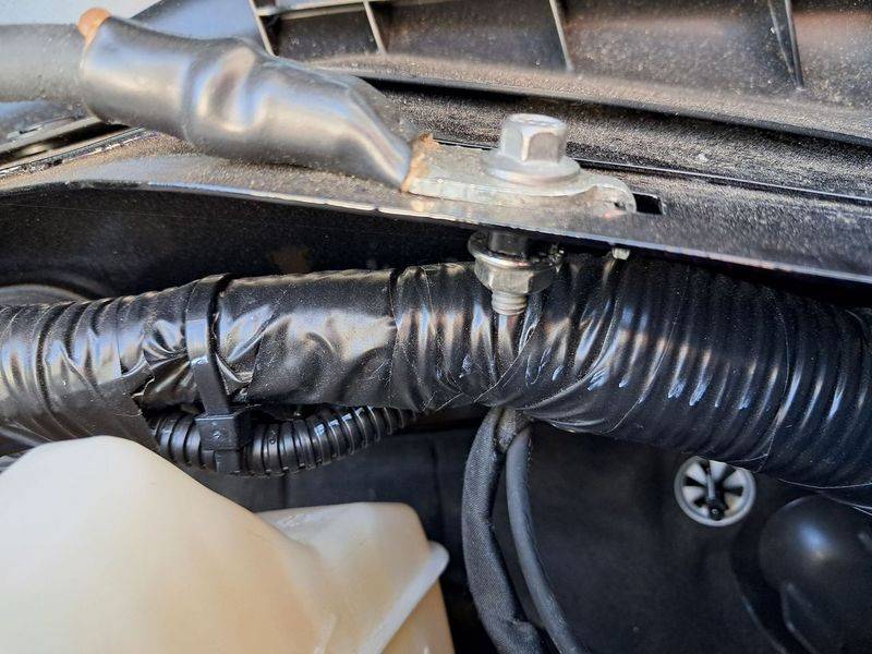

I noticed there is already a ground wire running to the fender so I can connect there. I am running 1/0 power wire so I won't double it but the power line is fused and the ground isn't.
If you use a factory ground point consider doing this. Put a nut on the underside of the ground bolt and use the extra threads sticking out as a stud. Double nut it if you want a good flat surface on both sides for your ground lug to mate with. This way you aren't interfering with the factory connection at all. I think they are standard pitch metric, either M5 if 8mm or M6 if 10mm.
The only downside may be confusion to an unwitting technician that needs to unbolt the factory ground.

I like this idea. I would like to assume a technician who sees a huge ground wire coming off the nut and sees a similar power wire coming off the battery may put 2 and 2 together.
