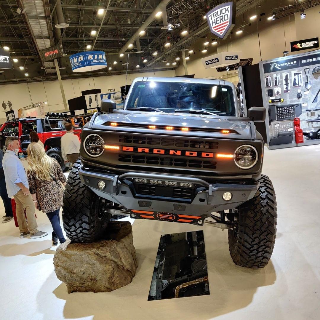

Yep. Best I can tell it hasn’t come out yet, but iirc that’s the right conpany. The Bronco pictured is Havoc offroad’s 2021 Sema build.

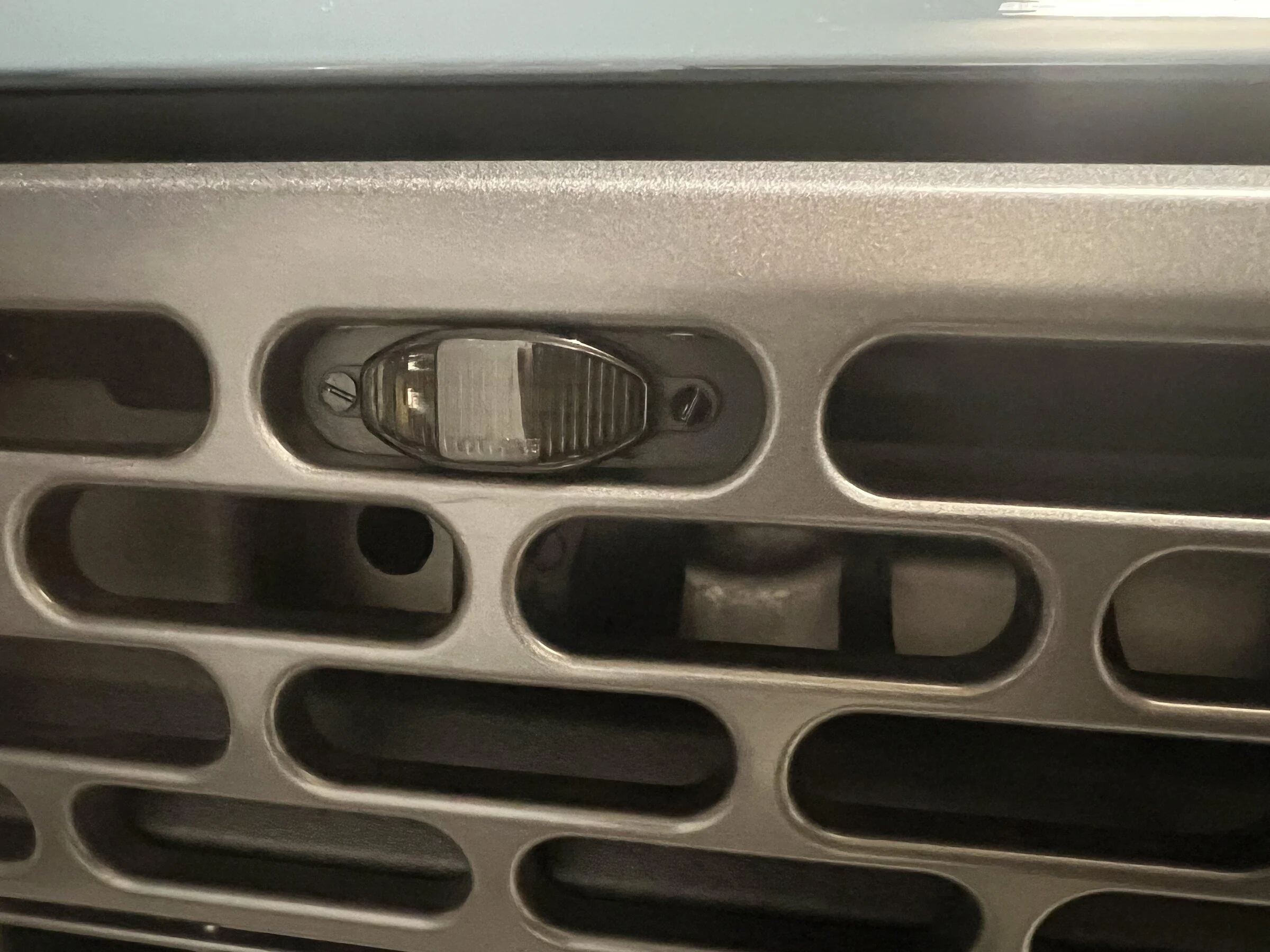

You got a picture of yours how did you mount them?
I purchased this black plastic stock(way more than Needed). Cut small piece to fit behind the grill holes, cut out to fit the lights, bolted them in and dabbed glue on the black plastic to back of the grill. This way if they ever burn out or get damaged I can just unscrew them to replace. I trimmed the plastic with an exacto knife to match the hole so you can only see it the hole where the light is mounted.

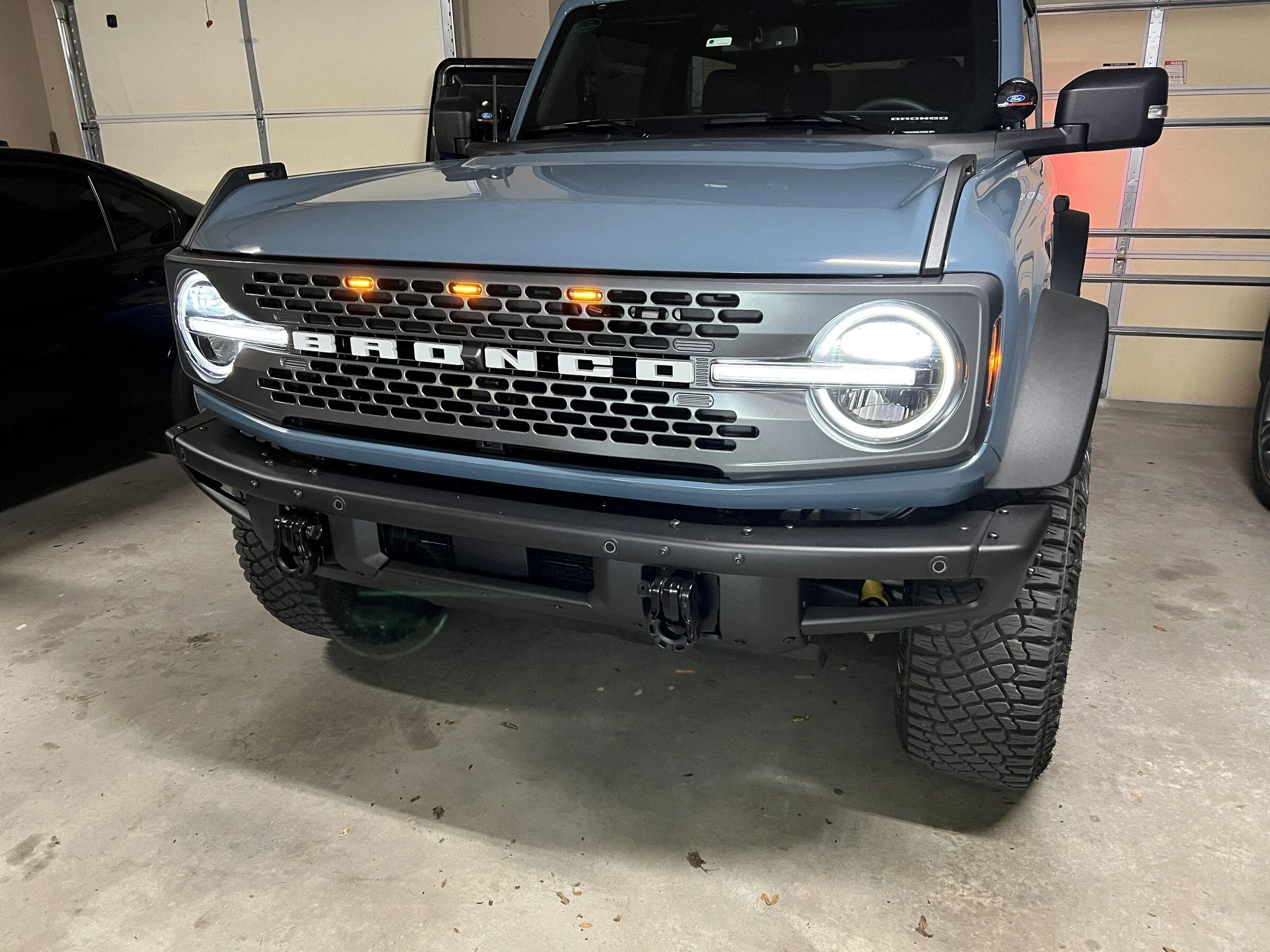

I forgot here is a pic with them on.

where did you hook them up to?
To one of the 6 pre installed switches. I leave the switch on all the time, since power is disrupted when the ignition goes off they are only on when the Bronco is running. Makes them DRLs.

They look cool - but they'll get made fun of by the Raptor guys. I had a Raptor and it's comical seeing all the 4Runners and Tacomas running around with these lights slapped in there.
They're on the Raptor because of the width of the truck.

Will they need an mailing address or just an email to write about their feelings? Just kidding, but who cares what some raptor owner thinks , it is just a light, albeit serves no purpose.
