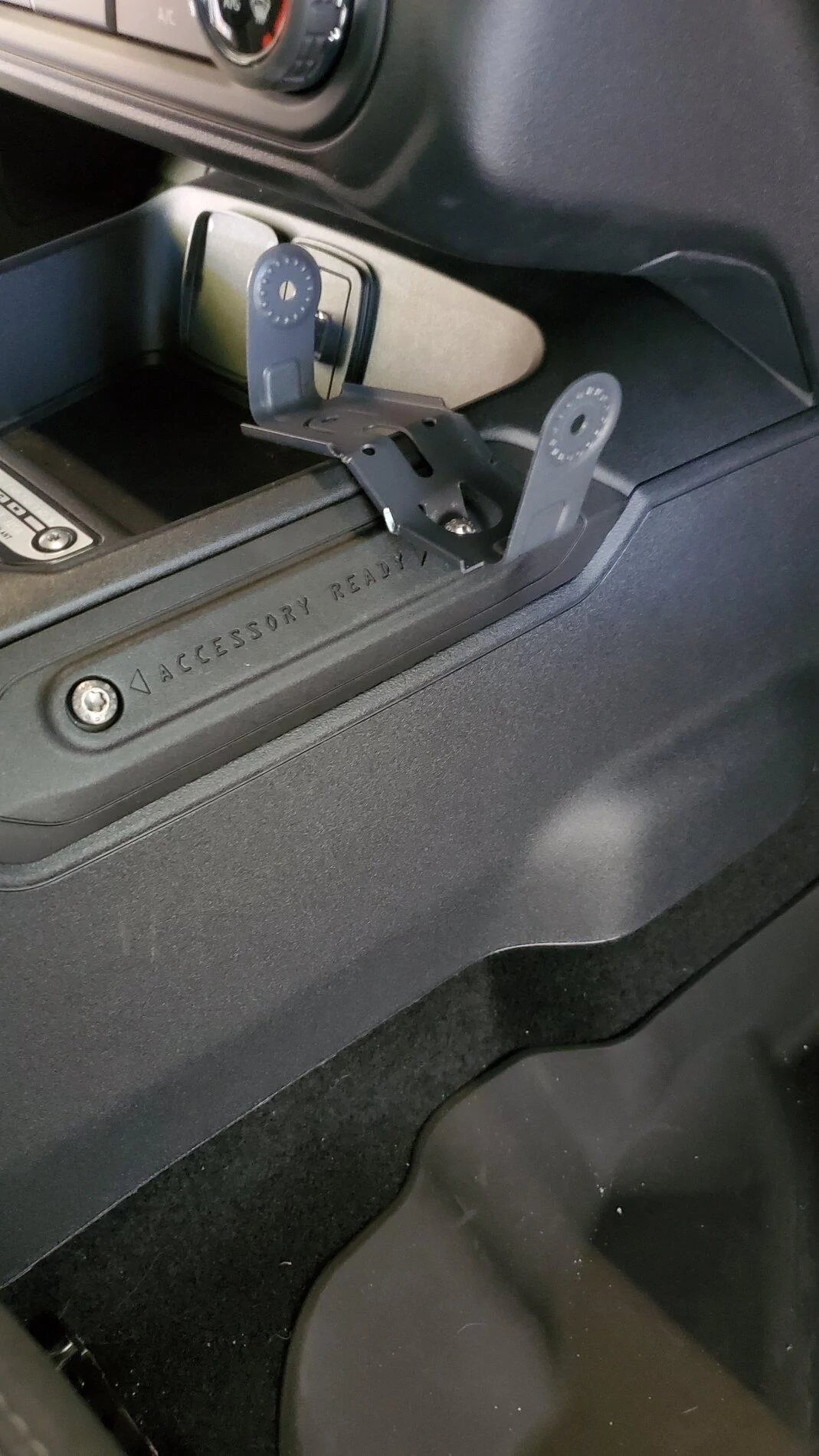

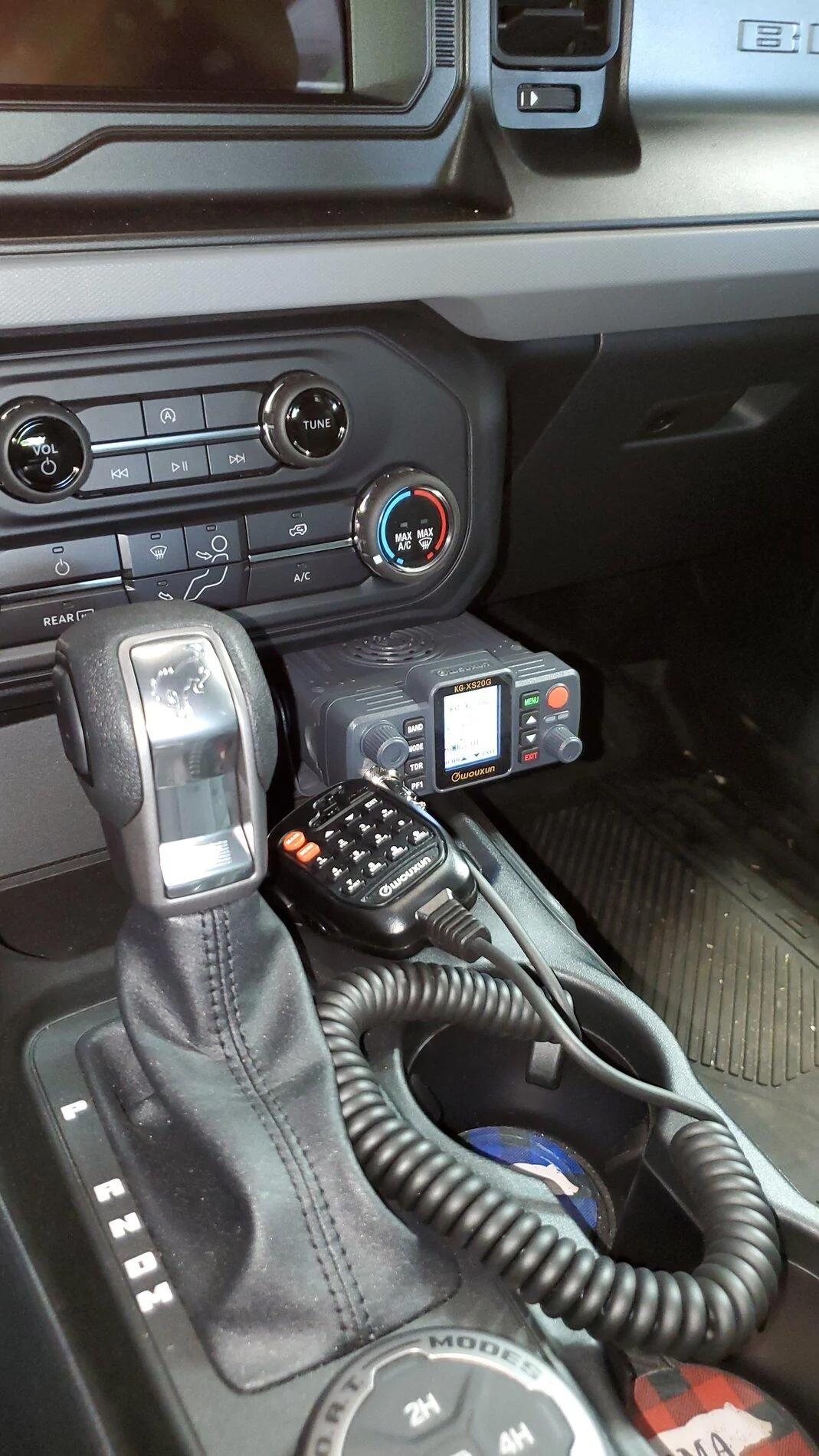

This is not meant to be a how to, best approach, or even a good solution. This is just what I did. I’ve been taking info from the forum for over a year, so I try to contribute when I have something others might find interesting.

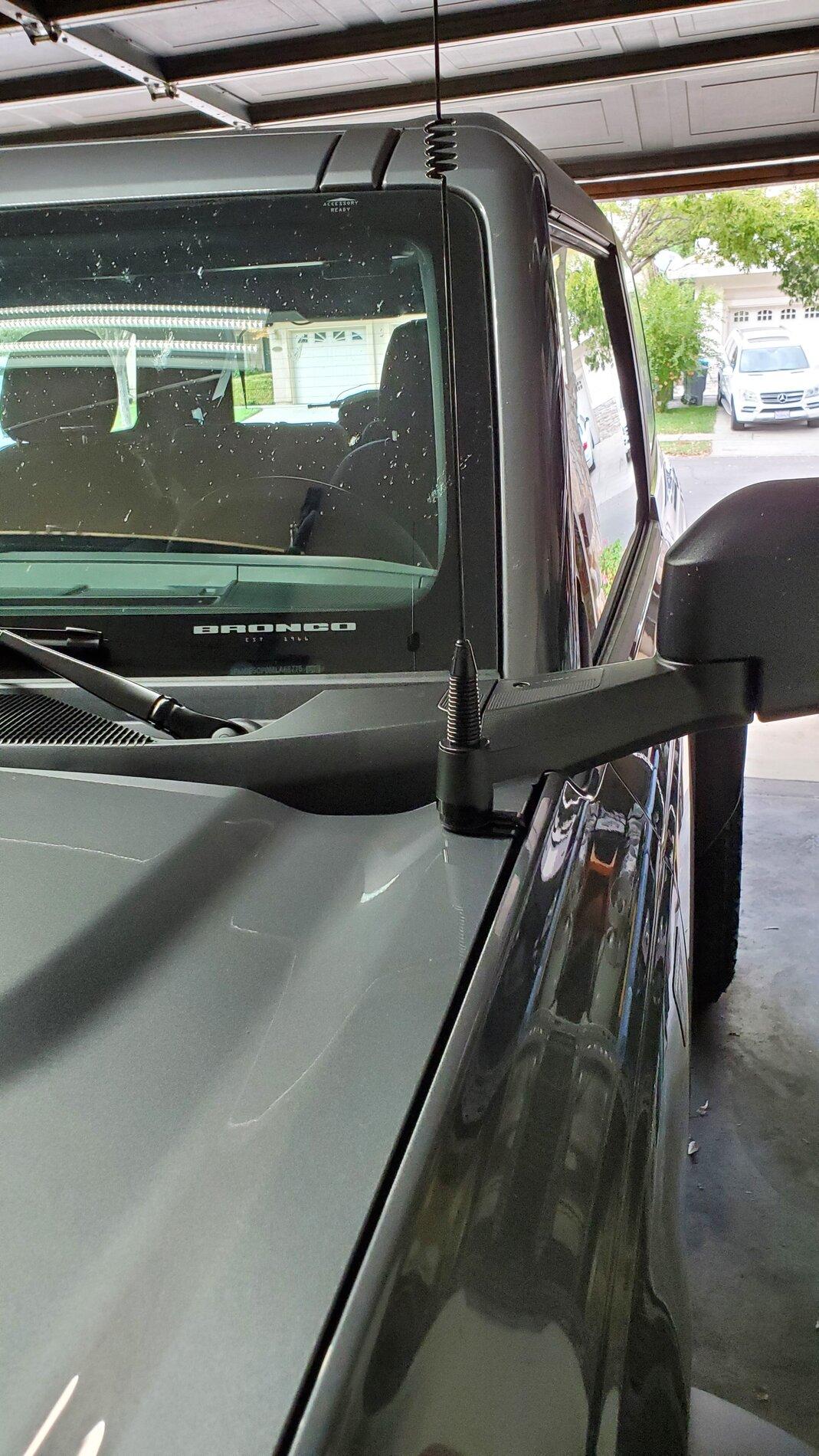

I am returning the midland antenna, it is too short out of the box, I did NOT cut it. I am unable to tune below 2.0:1 SWR. Extending it to max gives 2.0, sliding to shortest without cutting gives me a 2.2:1. I ordered a Browning off Amazon just in case it takes weeks to return/replace the midland, it will be here on Tuesday.

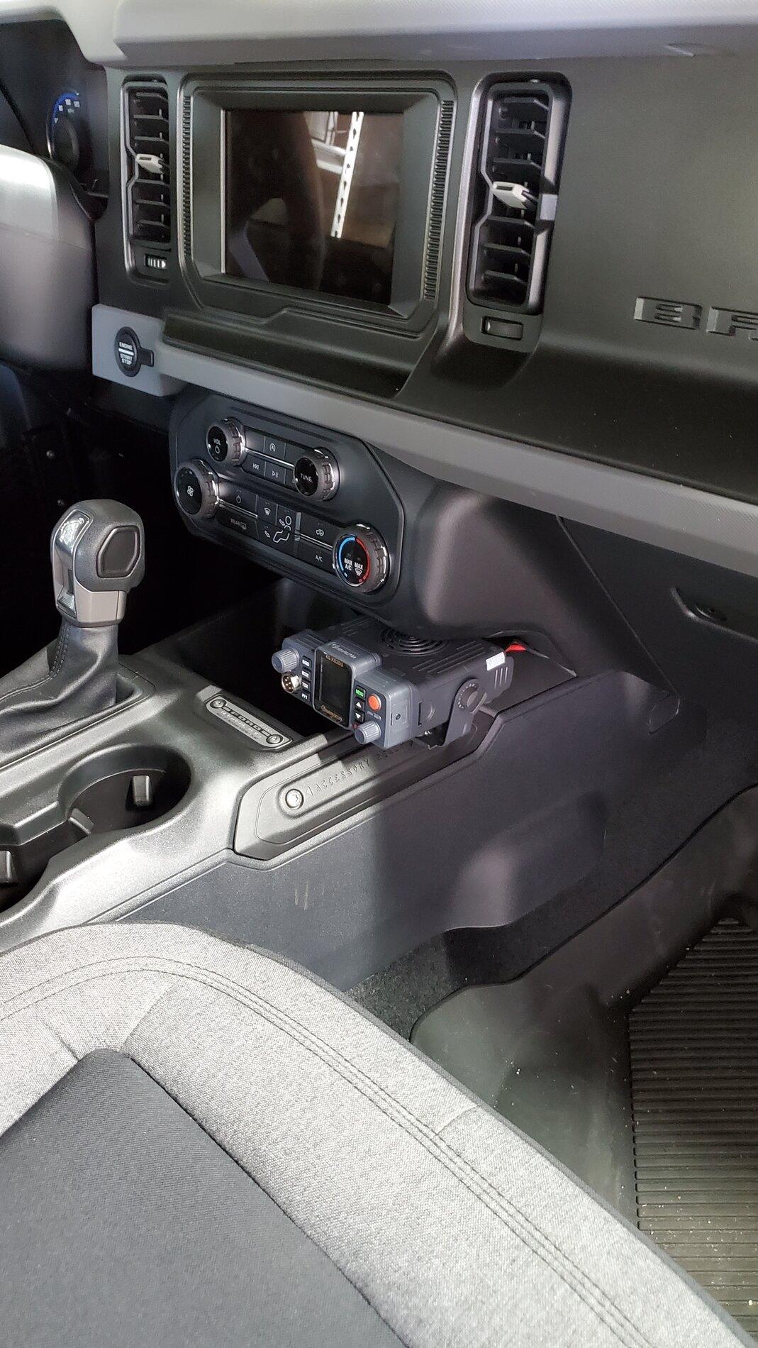

I connected directly to the battery for power, I want it to work with ACC off and it doesn’t make sense to waste a switch on a radio. Wiring and antenna cable were ran through the grommet near the accessory wiring on the driver side.

Customized radio bracket
Antenna Mount
Attempting to revive a dead thread here.... but any chance you remember where you got that radio bracket from? This is the exact mounting point I'm wanting to put my radio, but can't find a bracket similar to that anywhere
Antenna Mount

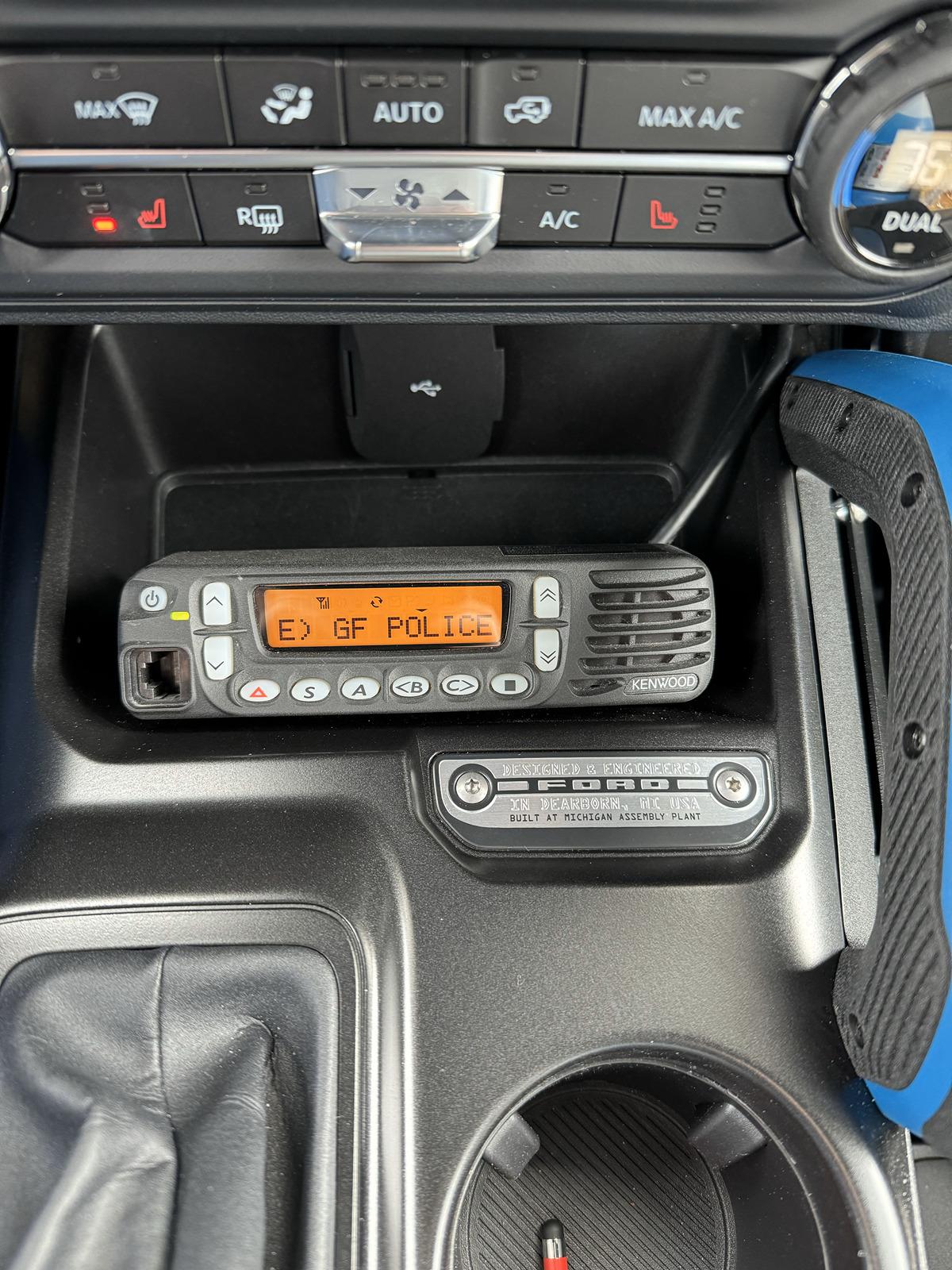

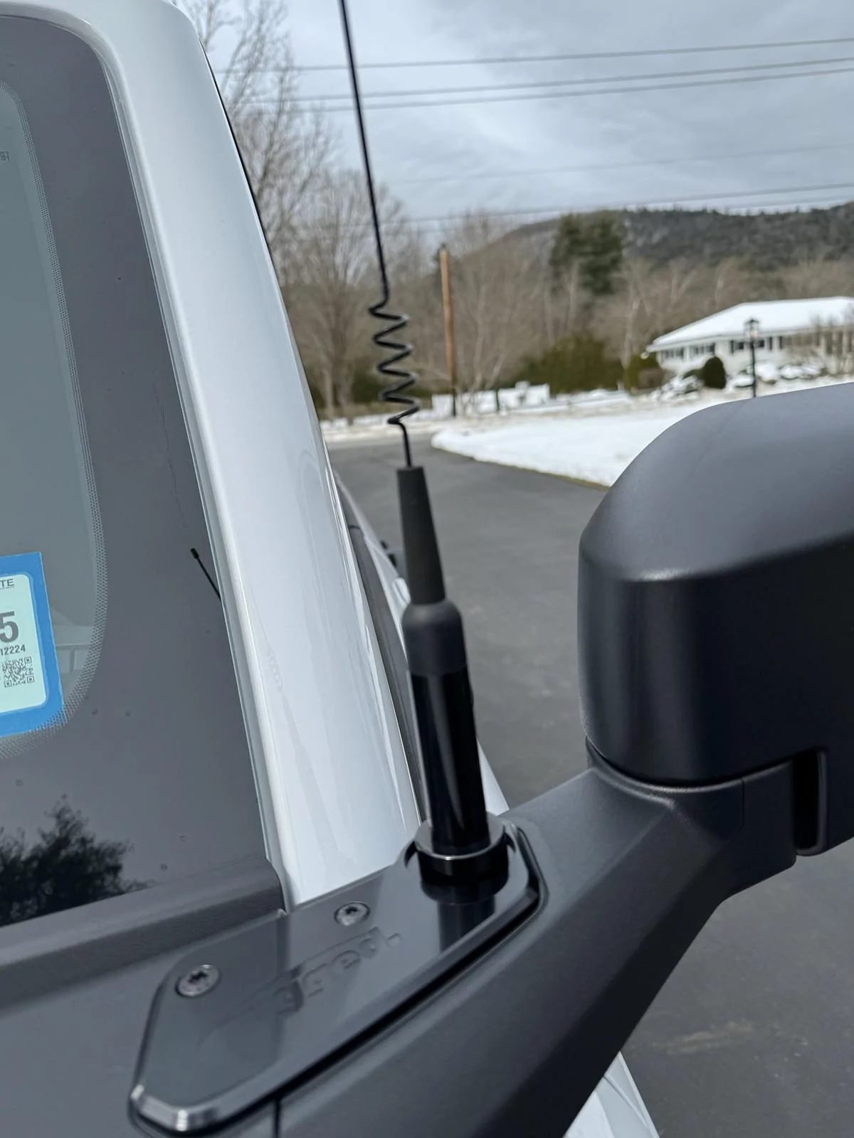

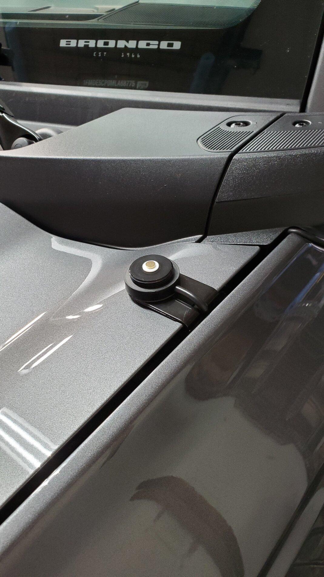

Gotta do what works for you. I am very, very pleased with the radio mount and NMO antenna mount that I got from Rugged Radios. I have a Kenwood TK-7180H with a remote head mount. Radio head is mounted in the center stack under the climate controls with gorilla grip velcro (no holes), radio is mounted with their mounting bracket using the two bolts that secure the passenger grab handle (no additional holes), antenna is mounting using their mounting plate attached to the driver's sdie mirror (no holes).

How does the antenna mount in there? Where's the cable go?
The plate has an opening for the NMO mount. Take out the factory bolts, loosely secure the plate with the bolts, mark the plastic cover to line it up, then the only thing that needs to be drilled is the plastic. Cable routes through the opening near the hood hinge and down to the grommet for access through the firewall. Took me longer to tweak the plastic than it did to mount the antenna.
