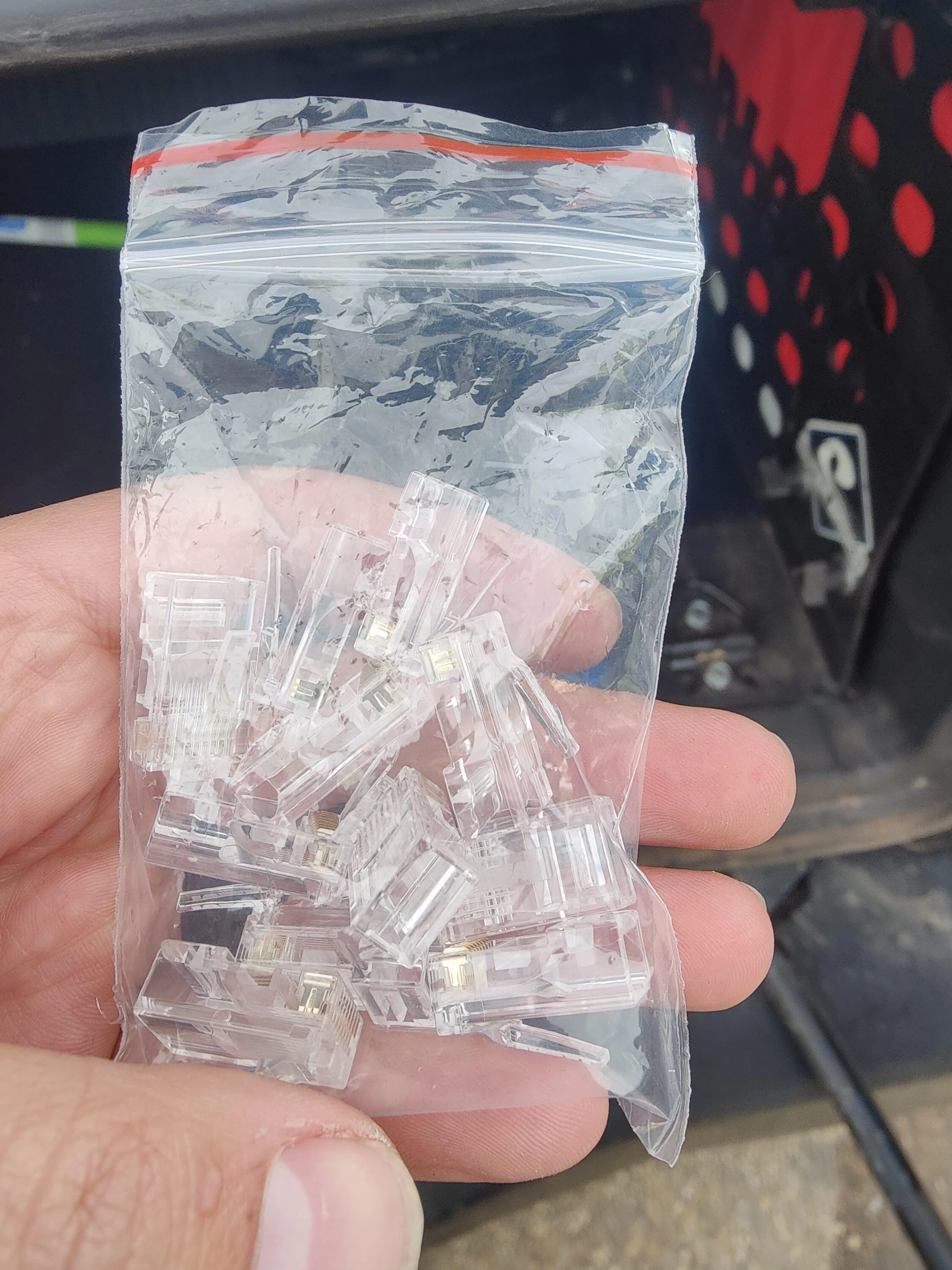

@Bmadda I ordered the identical connector to @UtahBrandon and the cable did not work. Messed with it a bit and the connector that went into the main radio was not working. Bought a new connector, cut the bad one off and replaced it and it works like a charm.
PSA: If you buy one of these extension cables, maybe buy a few to make sure you get a good one and then return.
Ford Bronco GMRS Radio IMG20230526184143
