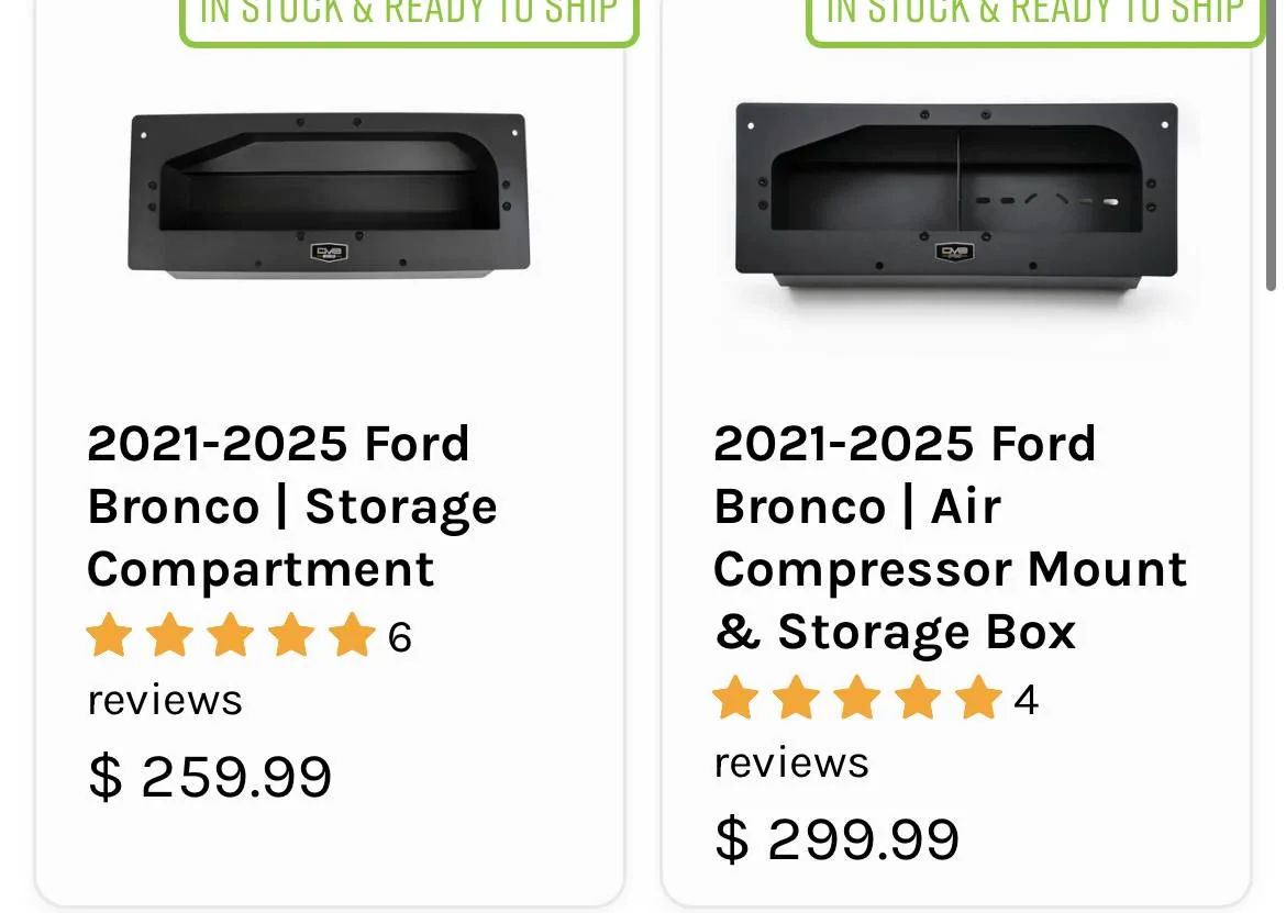

1) I’m looking into this dv8 storage for the back and it says it works with the stock exhaust.

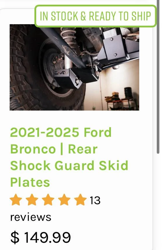

2) I’m wanting to get some skids for my rear shocks as well also from dv8, anyone have any thoughts on how you like it?

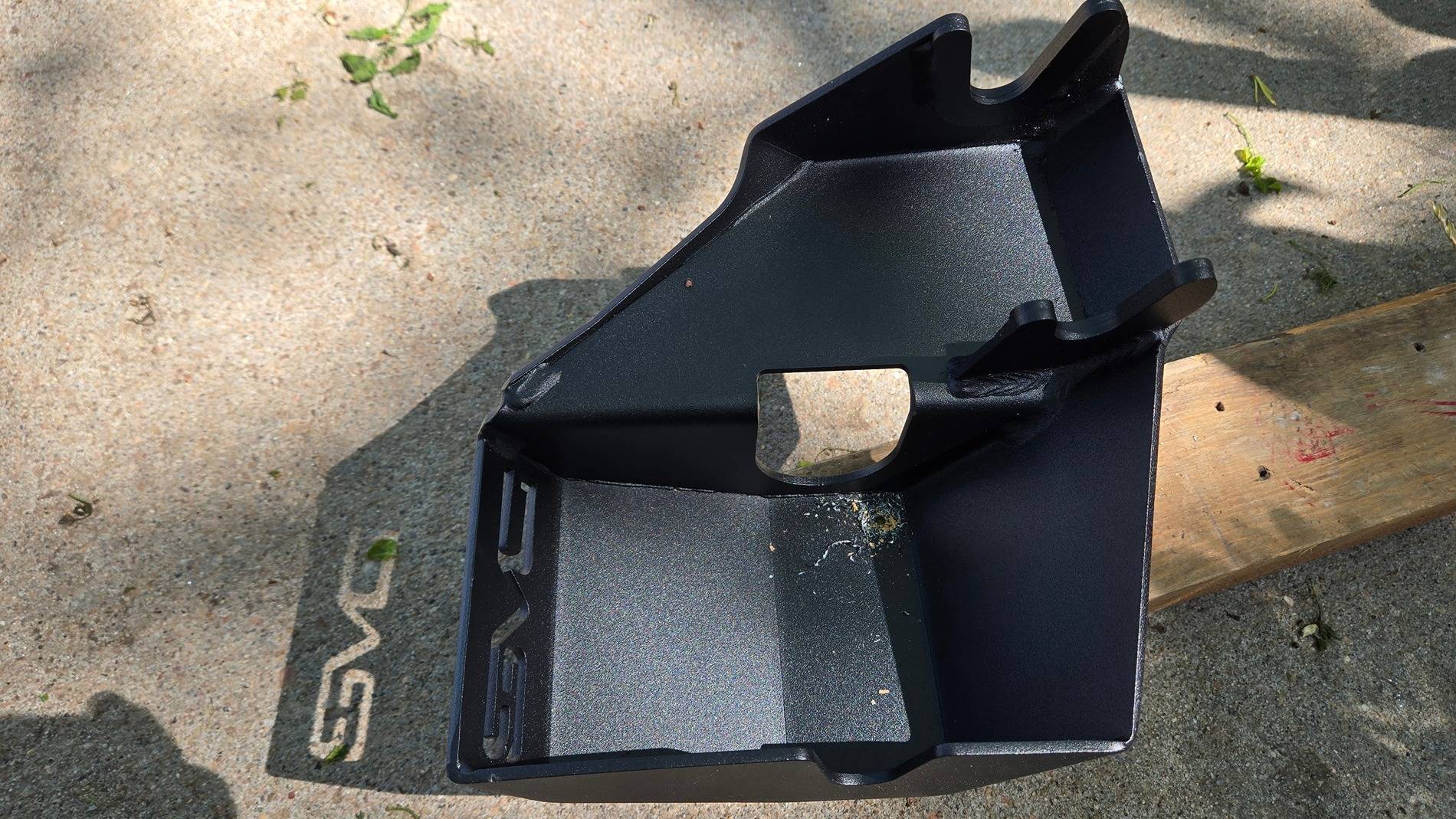

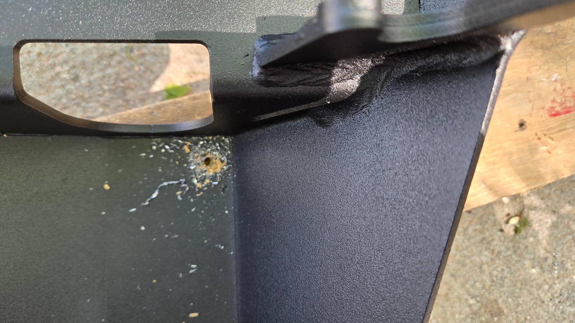

I have a 24 two door Badsquatch. I installed the DV8 rear shock skid. I chose it for the 1 piece coverage of the shock and lower control arm/trailing arm(?). Also you dont need to remove the shock bolt, just loosen it. The torque value on that bolt is something like 320 or 360 ft/lbs, so be prepared for that. And the size of the two bolts was like 24 an 27mm I think. So, a little finicky to install. The bottom of the skid is solid, I decided to drill two holes for water drainage. It is a beefy unit. I like it.
