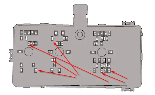

I believe that the labels cover you even if you don't have the switches. Those locations (#60-65) will just not have fuses. From the Owners Manual.
