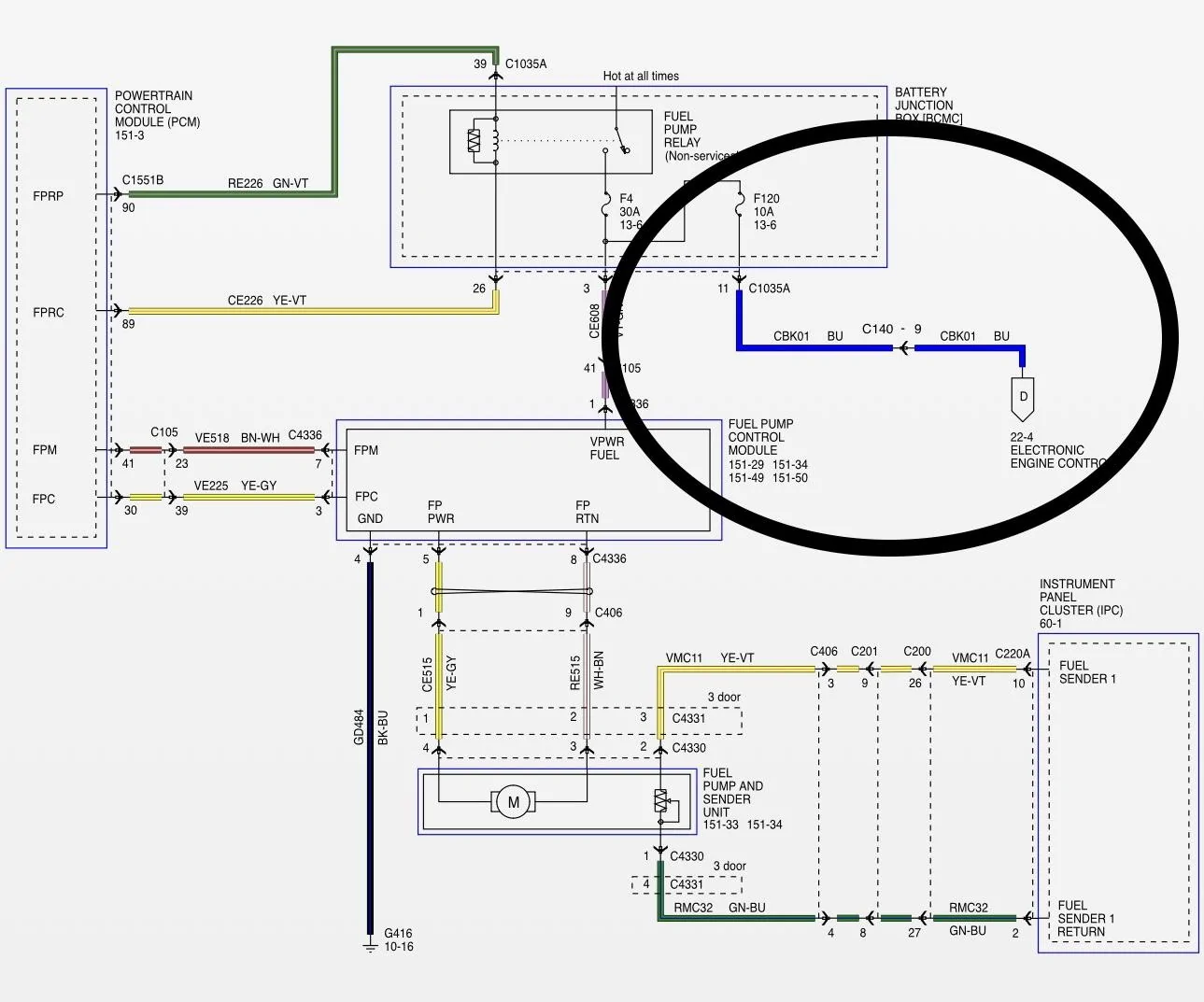

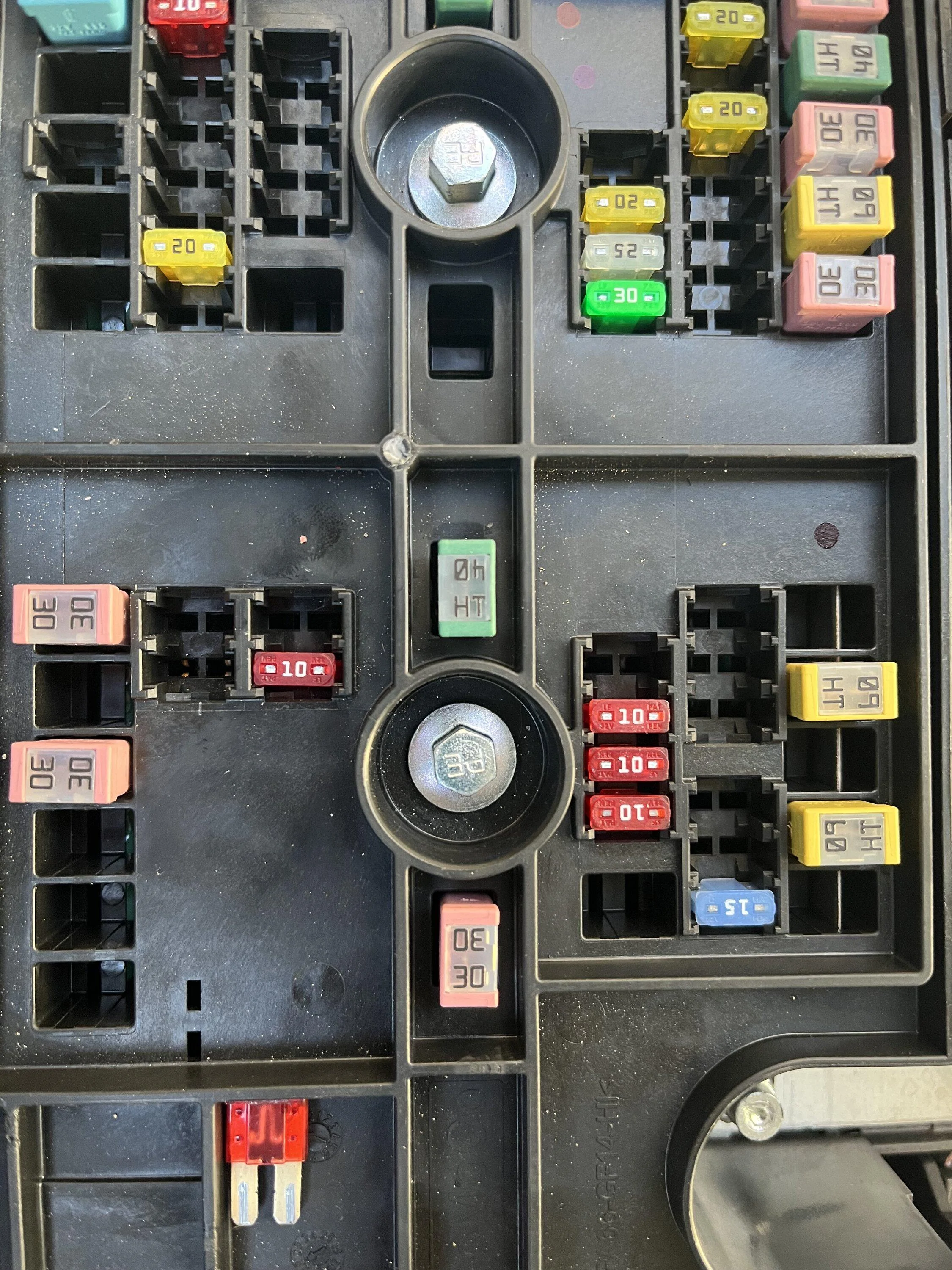

I’m putting on Mabett’s fuse box cover this afternoon and I noticed fuse #120 is not empty. What the hell does this fuse do for those of us with a 2.3?
Ford Bronco Fuse #120 IMG_5607
Ford Bronco Fuse #120 1689466874025

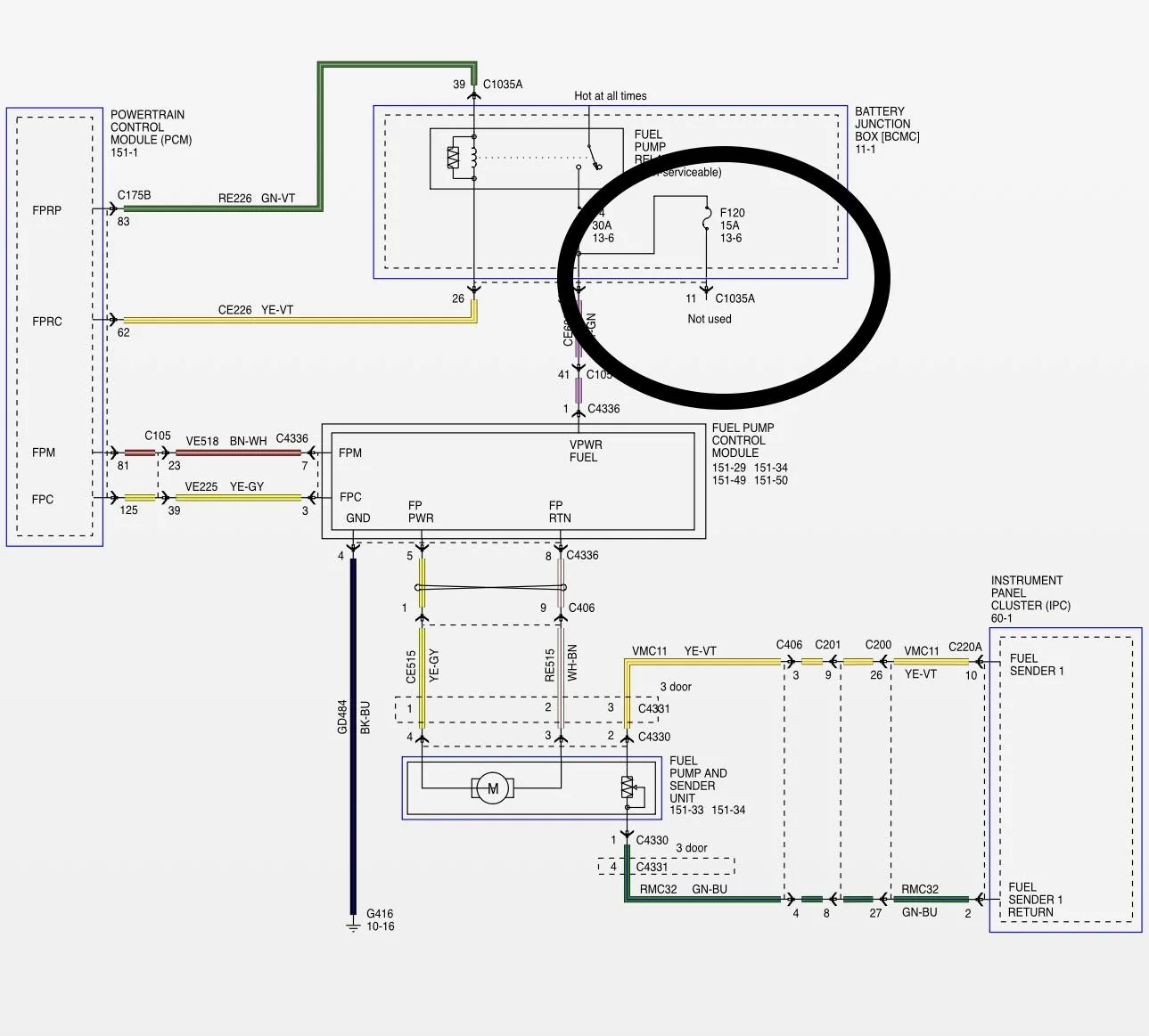

I don’t see a “Fuel Injectors“ listed for the 2.3 anywhere else on the sticker. I can’t imagine it being the only engine not needing one. I wonder if it is just an omission that never got caught? 🤷‍♂️
Funnily enough, I had that same thought so I pulled the fuse as an experiment. She fired right up.
Is there a contact in both ports? Might just have a fuse stuck in there as a spare. Can peek at mine tomorrow.
