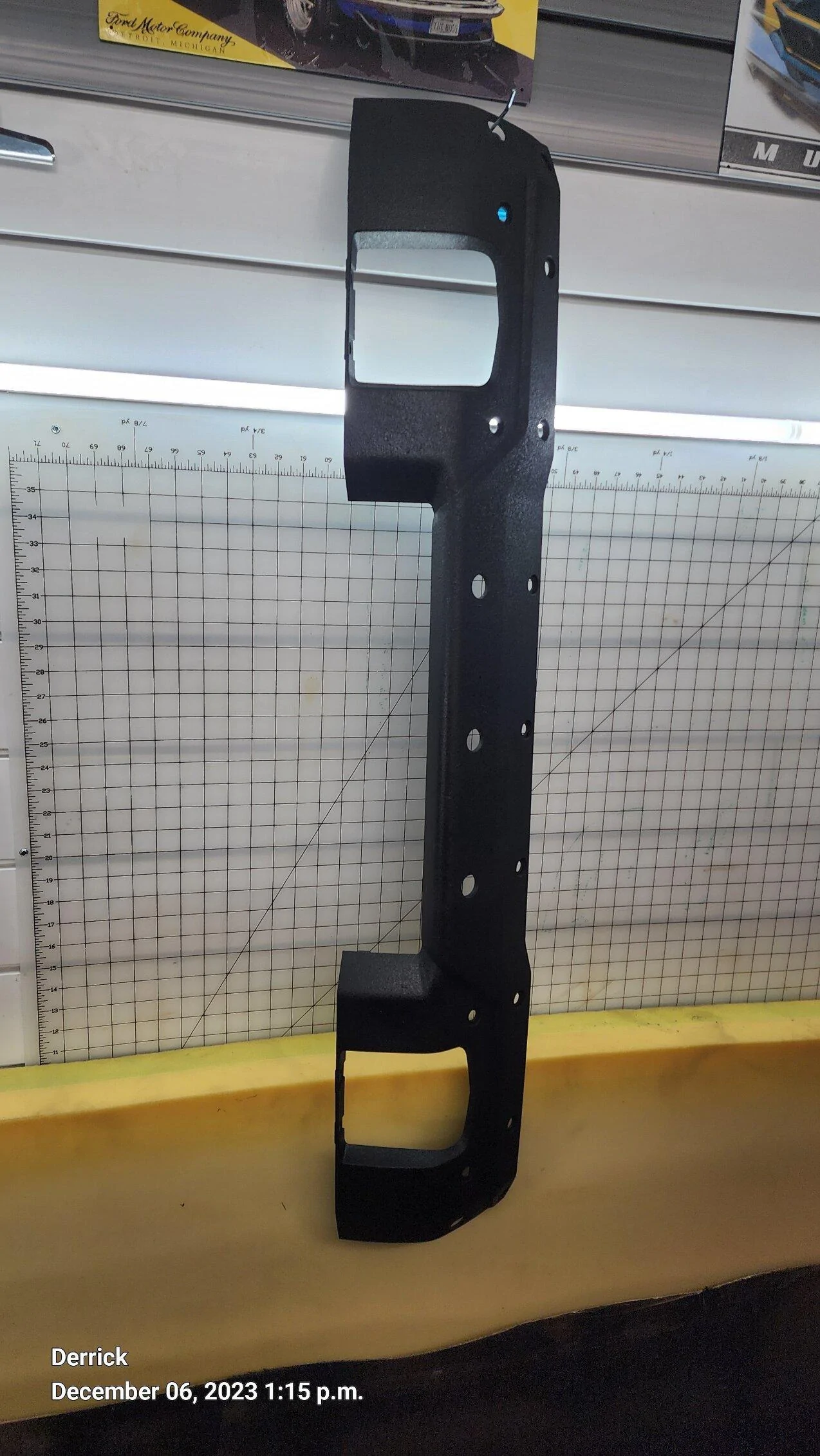

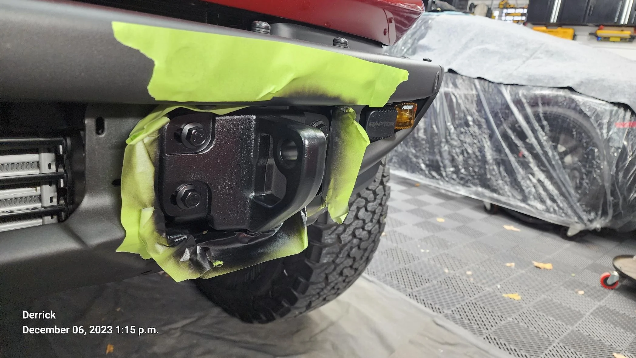

The front plastic cover and lower shield came off quite easy. I wanted to remove the hooks but to get them off the bumper has to come off to access a bolt on the inside to be able to remove the hook, so I decided to mask around it and I spray painted.
The hook paint has a little more shine then I like but will see how it looks later.
Ford Bronco Front Blackout - Bronco Raptor HOOK

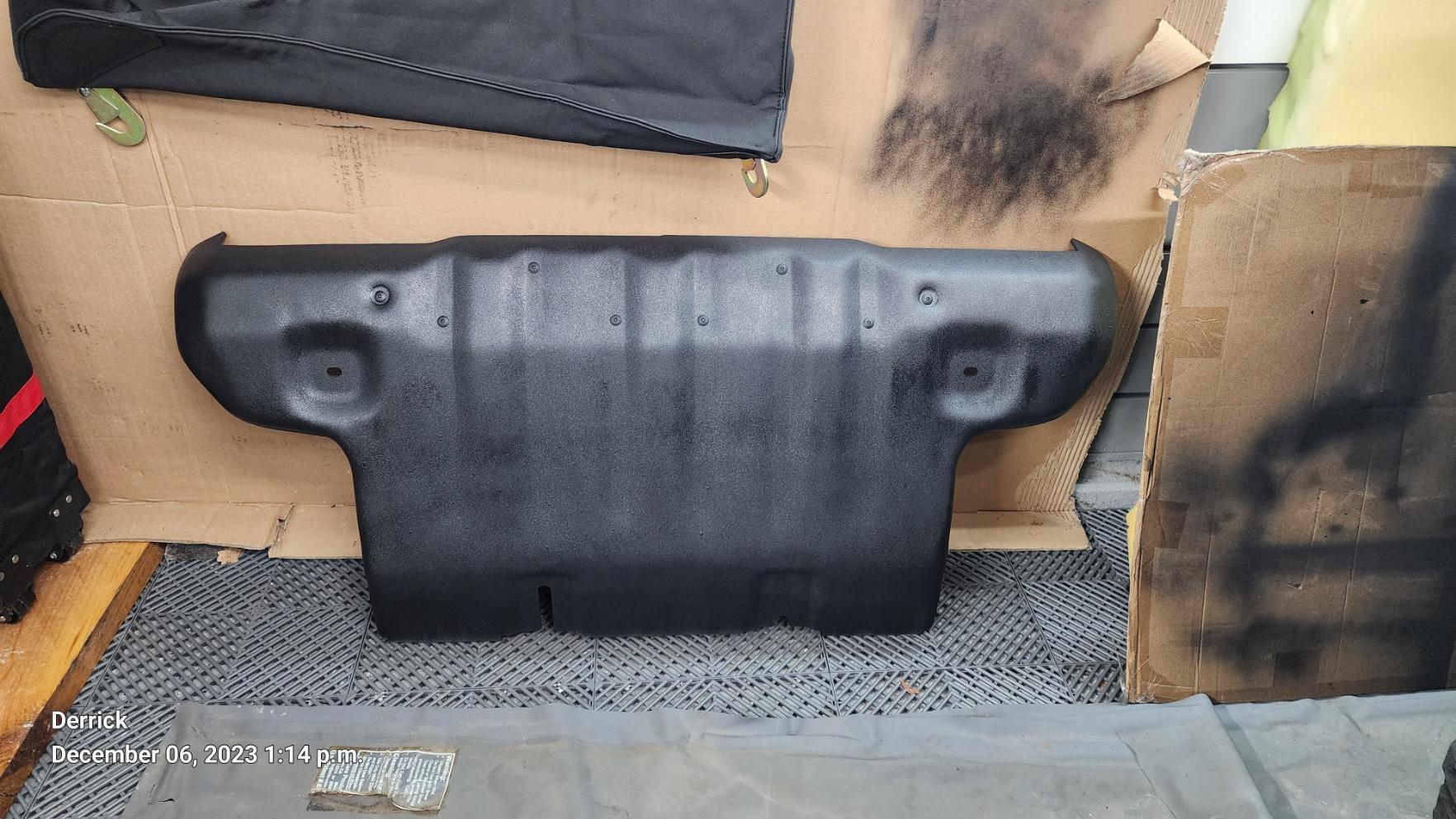

I used Raptor K1 liner paint after a sanding to make the paint stick. I setup the pieces vertically so I didn't have to point the can down to avoid spitting, but it did anyways. So to fix that I allowed the partially dry then dabbed the drips with a paint brush. Worked out great.
Just have to wait for the parts to dry and install later today. Will post finish pics.
Ford Bronco Front Blackout - Bronco Raptor bumper 1
Ford Bronco Front Blackout - Bronco Raptor lowerguard
