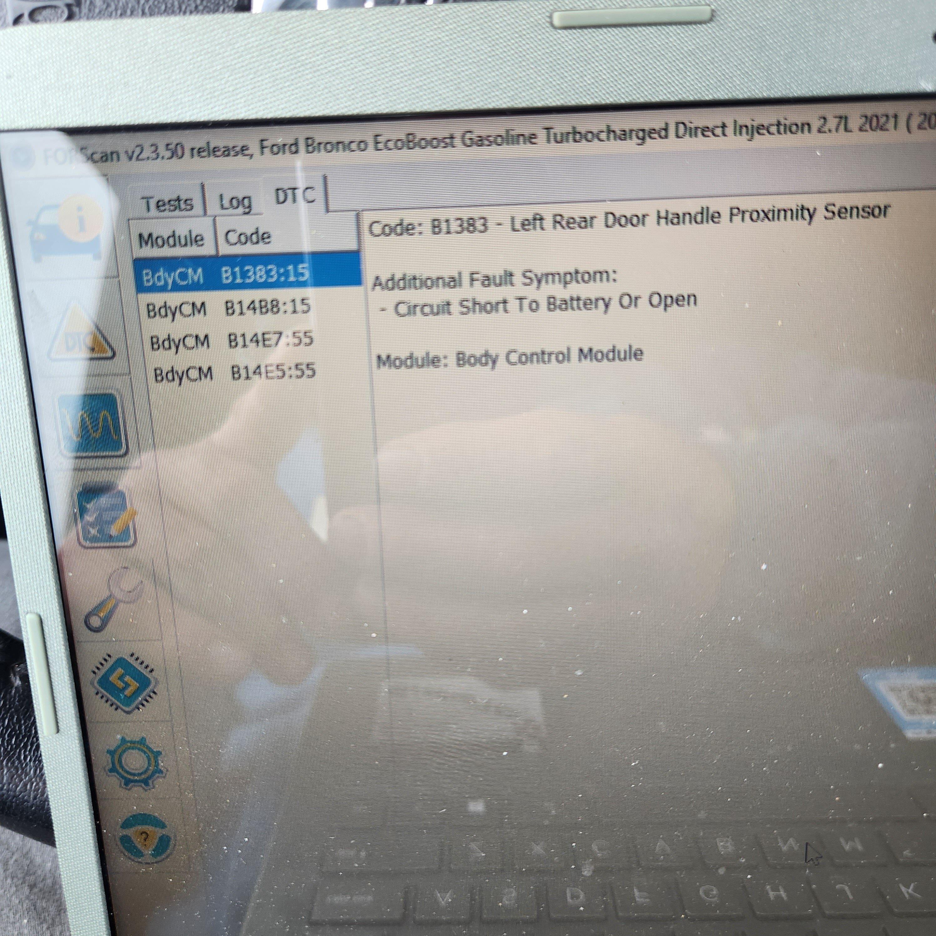

Mine shows this also....don't seem to matter....anyone know what EXACTLY this means or how to clear it?
Which module is reporting that DTC?
Ducati1098
3,806
7,648
Midwest
2022 Bronco Wildtrak, 2012 Ford Fusion
Uh....ABS says UO256
PCM ..... UO422
BdyCM has 3 code
B14B8
B14E5
B14B7
ABS doesn't even list that DTC in the workshop manual, so I'm a little confused there lol
PCM U0422 is invalid data received from the BCM, most likely caused by a change in tire size if you have done that. Wont affect anything, but you wont be able to clear it.
B14B8 and B14B7 Also aren't listed anywhere in the workshop manual.
B14E5 is Left Front Enhanced Exterior Lighting System - A common DTC when the headlights have been changed to aftermarket replacements. Also wont affect anything, but cannot be cleared. Mine has this same DTC after switching to Morimoto's

@Ducati1098 any idea where to search for the fix for this??? This seems to be the rear door proximity issue for me and probably others too.
Weird thing is I only see the code forscan when I run a module test....

Weird thing is I only see the code forscan when I run a module test.... but then this module don't show up in the list...
I’m not sure I understand what you mean by this.
Also, don’t you have a 2 door? I’m confused how it’s even throwing that code.
Correct 2dr FE...I'm confused also. I figured ford mis-named this for the rear gate proximity sensor. Especially since my rear door sensor is broken or damaged or the code is wrong.
The proximity sensor on rear gate door dose not unlock or lock as it's supposed to with fob nearby.
Ducati1098
3,806
7,648
Midwest
Ahh, okay I get it now. If the tailgate passive entry is INOP it just directs you to the same pinpoint test as any of the other ones. So it’s probably just a generic code generated letting you know that one or more passive entry handle isn’t working.
So your tailgate won’t unlock with the passive feature. But I’m assuming it still unlocks and locks correctly using the fob?

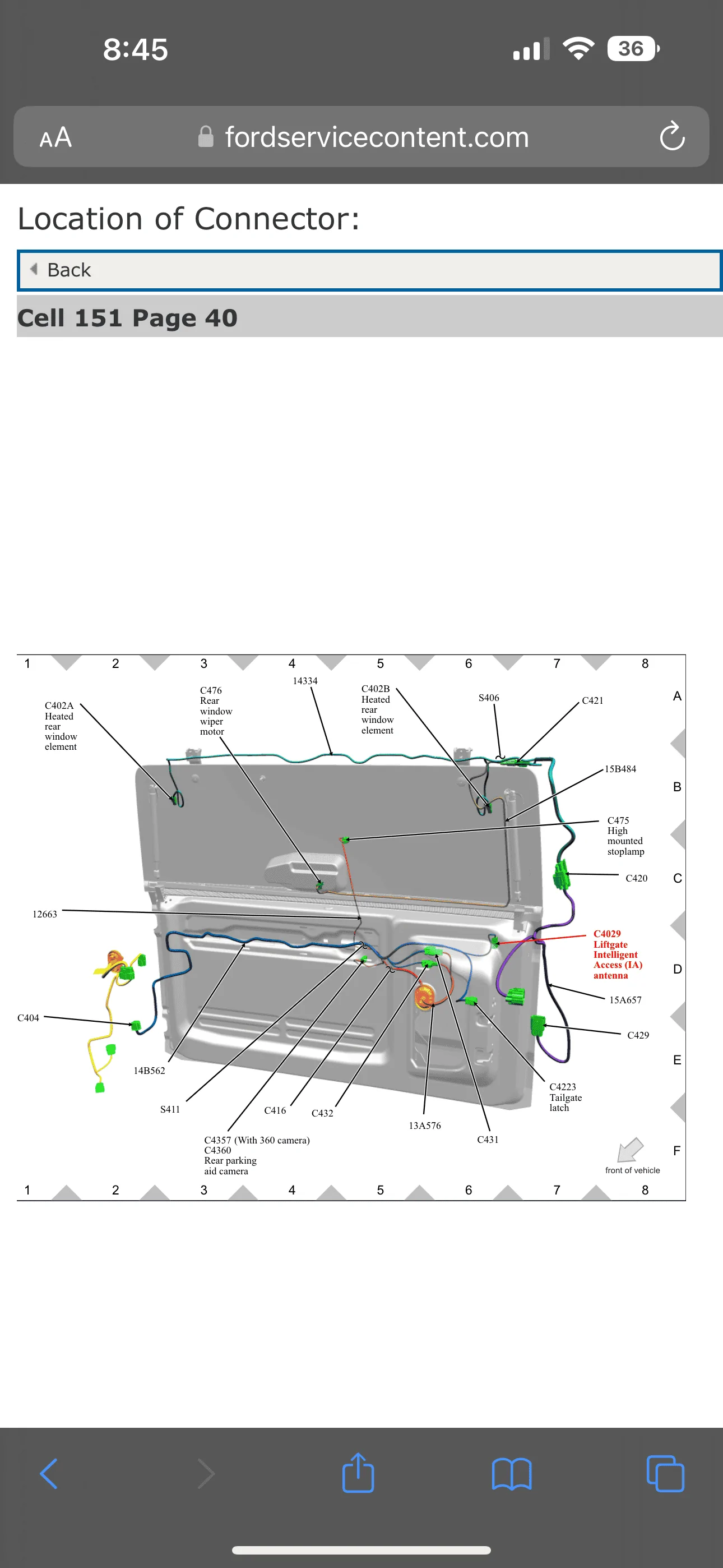

Correct so the locking mechanism is functioning and gets power and ground but this proximity sensor is faulty I think or got wet in my pickup situation...but I'm having trouble even locating it. I know where the fronts are but not the rear gate sensor.
Ducati1098
3,806
7,648
Midwest
The proximity sensor is part of the tailgate handle. There should be a connector that attaches to the tailgate handle, which is what I would inspect. You can get to it by removing the plastic panel on the inside of the tailgate.
Ford Bronco Forscan unlocks all GOAT modes with any Bronco model trim! How-to DIY instructions 35D8F79C-D1EE-4121-AF7E-2B5A15859B5C
Out searching the door now thanks 😊
