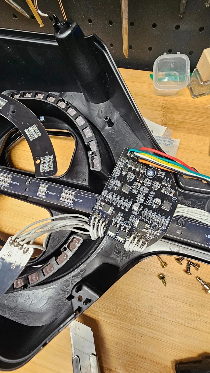

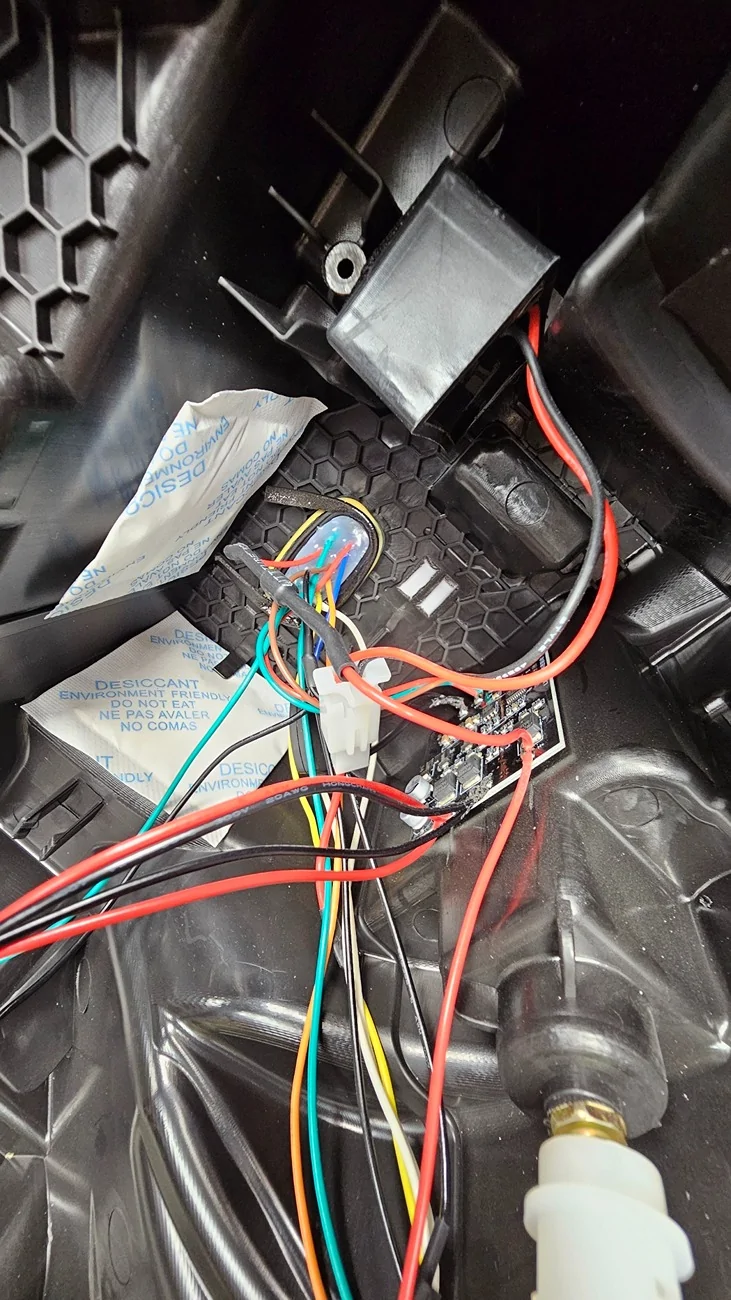

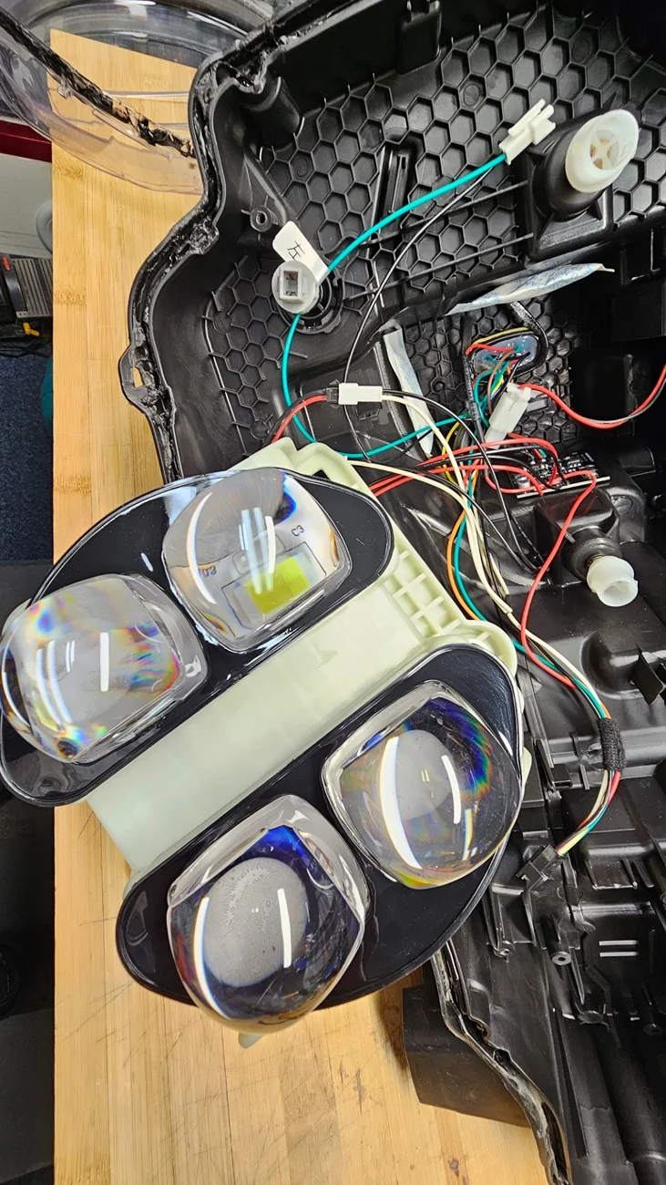

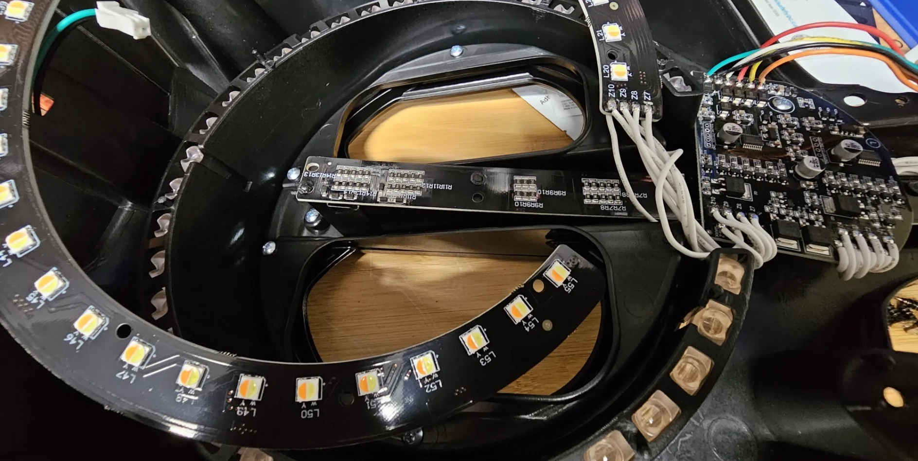

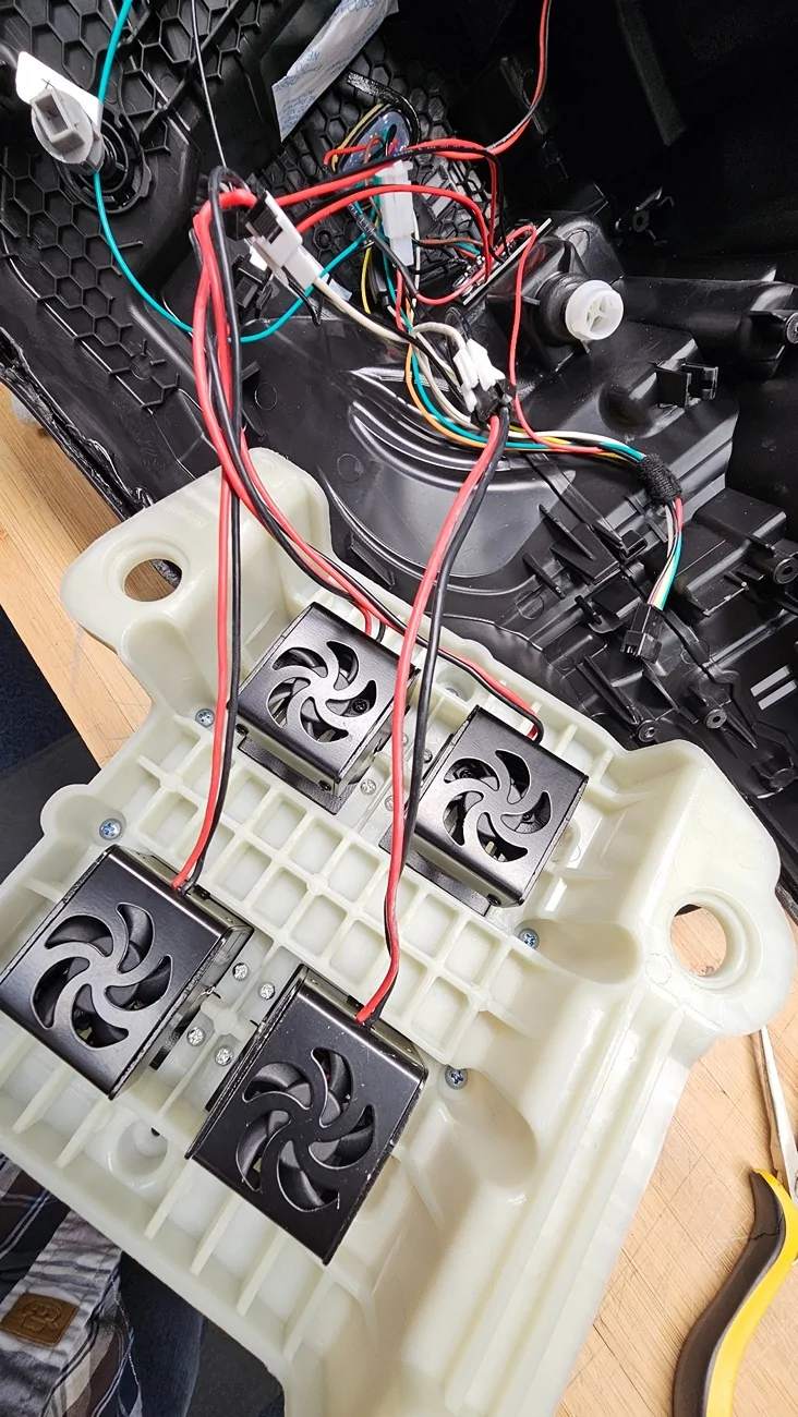

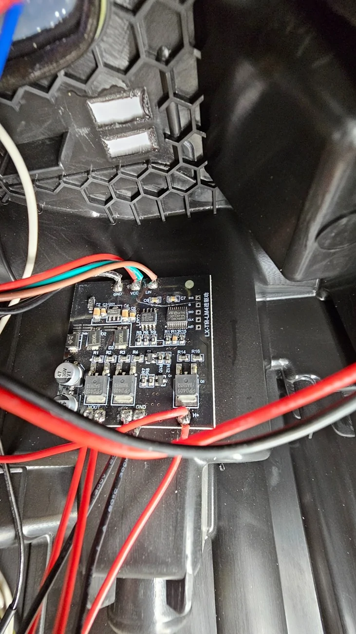

I have installed my OEM's because this set of Form's did not make it through this winter. There's still a couple months of winter left and the turn signal on the passenger side was almost totally out. I had no signal light at all. Dangerous.
I decided to rip them apart before tossing them and I didn't see any diode dynamics labels or logo inside. They are pretty cheaply made inside IMO. There are two main boards. The first one looks like it talks to the bronco and runs the headlights. The second looks like it runs the halos and the start-up sequence. The halos have shaped boards behind them with dual color led's. None of these boards have any conformal coating or PCB glue. They are exposed components so any moisture that is in there is going to get on the electronics. The headlights all have fans behind each projector so its no wonder I kept getting condensation in them. There are two large packets of desiccant stuck on the inside of the housing so I guess they were trying to prevent moisture but it didnt work for the climate here. I'm not sure if these release moisture in the heat or once they absorb all they can they just stop working. Either way my experiance hasn't been good with them. I just dont believe Diode dynamics actually makes these. I think they are rebranded.

Well isn't that interesting. I wonder what became of that?
I decided to rip them apart before tossing them and I didn't see any diode dynamics labels or logo inside. They are pretty cheaply made inside IMO. There are two main boards. The first one looks like it talks to the bronco and runs the headlights. The second looks like it runs the halos and the start-up sequence. The halos have shaped boards behind them with dual color led's. None of these boards have any conformal coating or PCB glue. They are exposed components so any moisture that is in there is going to get on the electronics. The headlights all have fans behind each projector so it’s no wonder I kept getting condensation in them. There are two large packets of desiccant stuck on the inside of the housing so I guess they were trying to prevent moisture but it didnt work for the climate here. I'm not sure if these release moisture in the heat or once they absorb all they can they just stop working. Either way my experiance hasn't been good with them. I just dont believe Diode dynamics actually makes these. I think they are rebranded.

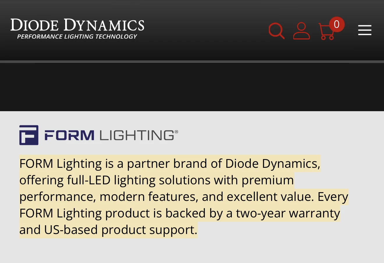

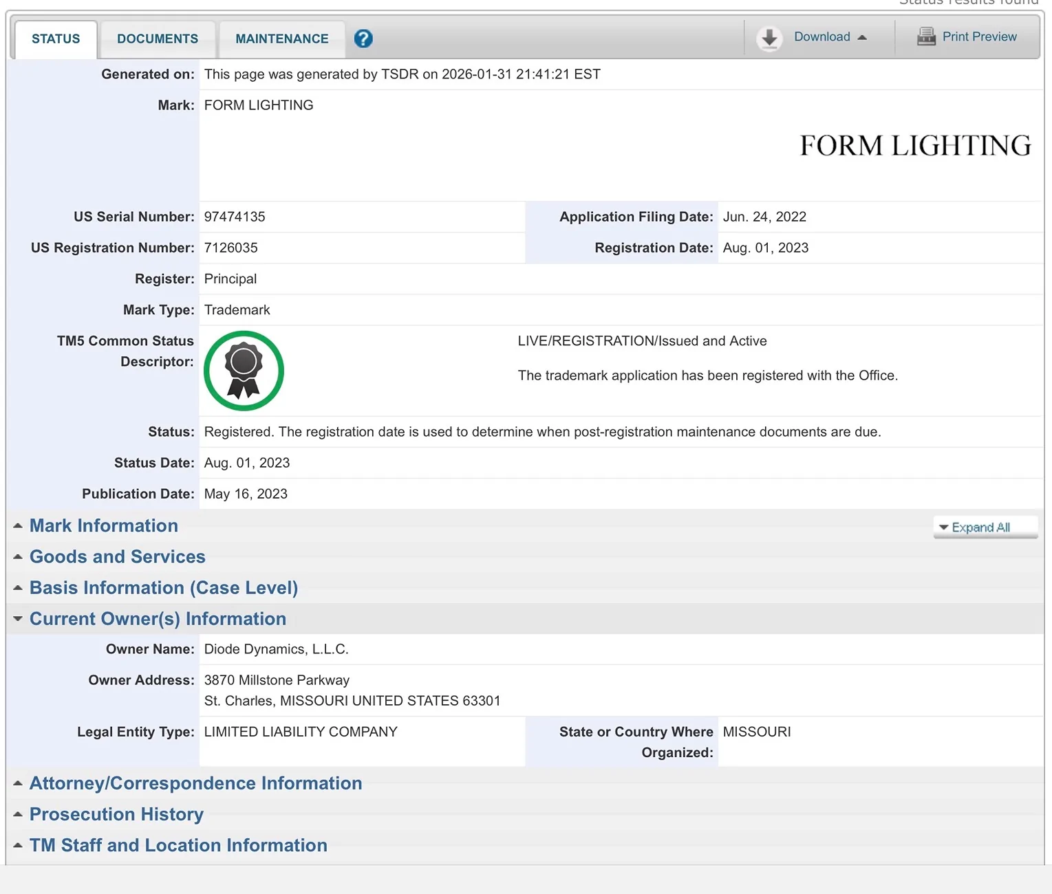

Diode dynamics may not make them necessarily, but Form lighting is their “partner brand” (whatever that means) according to their website.
Ford Bronco Form Headlights falling apart after 2 years... IMG_9651
DarthLincoln
Chuck
Feb 11, 2022
1,053
2,677
Northern California - Contra Costa County
1999 BMW M coupe, 2023 Ford Bronco Badlands 2dr
Also, Diode Dynamics does own the trademark for Form Lighting.

I absolutely agree with you on their support. They are fantastic to deal with. A couple pictures and a new one is sent out right away.
I just wish for their price point they would weatherproof the electronics. I think that is a good probability as to why they kept failing. As soon as it got cold, the condensation would build up on the inside. Shortly after, I started having issues. They just couldn't handle the winter here.
It's upsetting because not only am I out the cost, but also going back to the OEM's there is much less light than the Form light.
