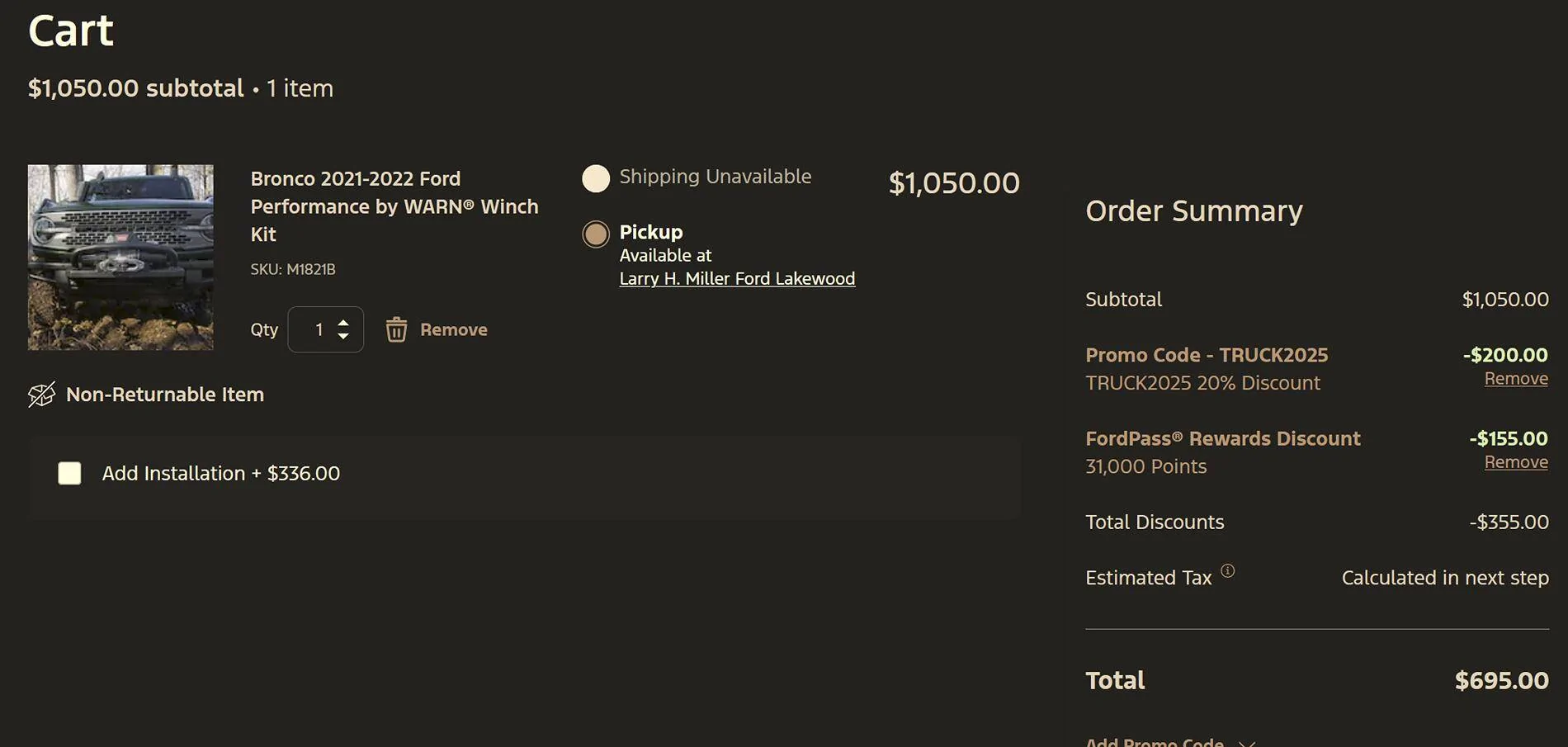

Hey guys I went deep into the winch rabbit hole and then it occurred to me that the Ford kit is available with the 20% discount and I can apply my points towards the purchase giving this kit an insane value. I can't think of any reason not to do send it - anyone have any negative feelings/experiences with this kit? Is there any other winch setup that comes close to this price?

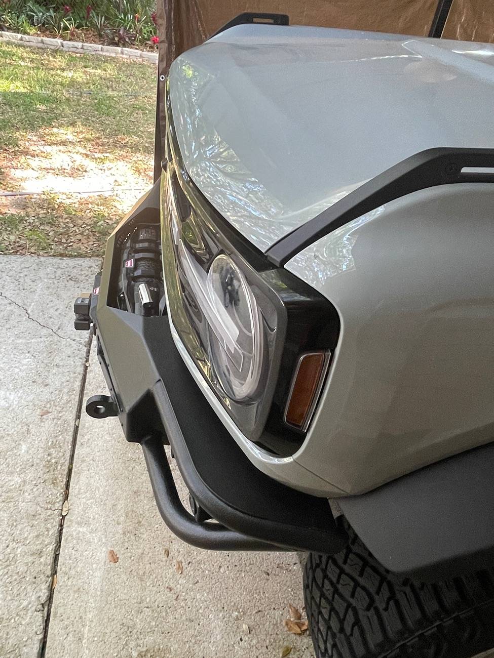

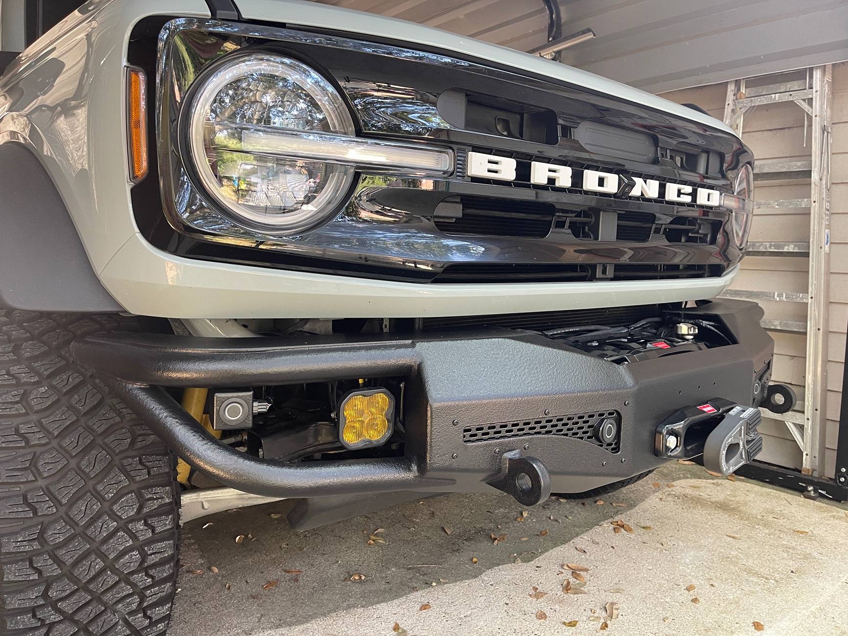

i got a BAMF winch bumper and a Warn EVO VR 10 S winch from Amazon (680), both were on sale. Less than $2000 Total. Bumper is a beast compared to modular bumper and my camera isn't blocked. The park sensors and harness were moved to holes in BAMF bumper. ACC can be relocated too if you have it. Winch is in line with frame and is a clean install. i can sell the modular bumper for $500-600, so it brings cost down.

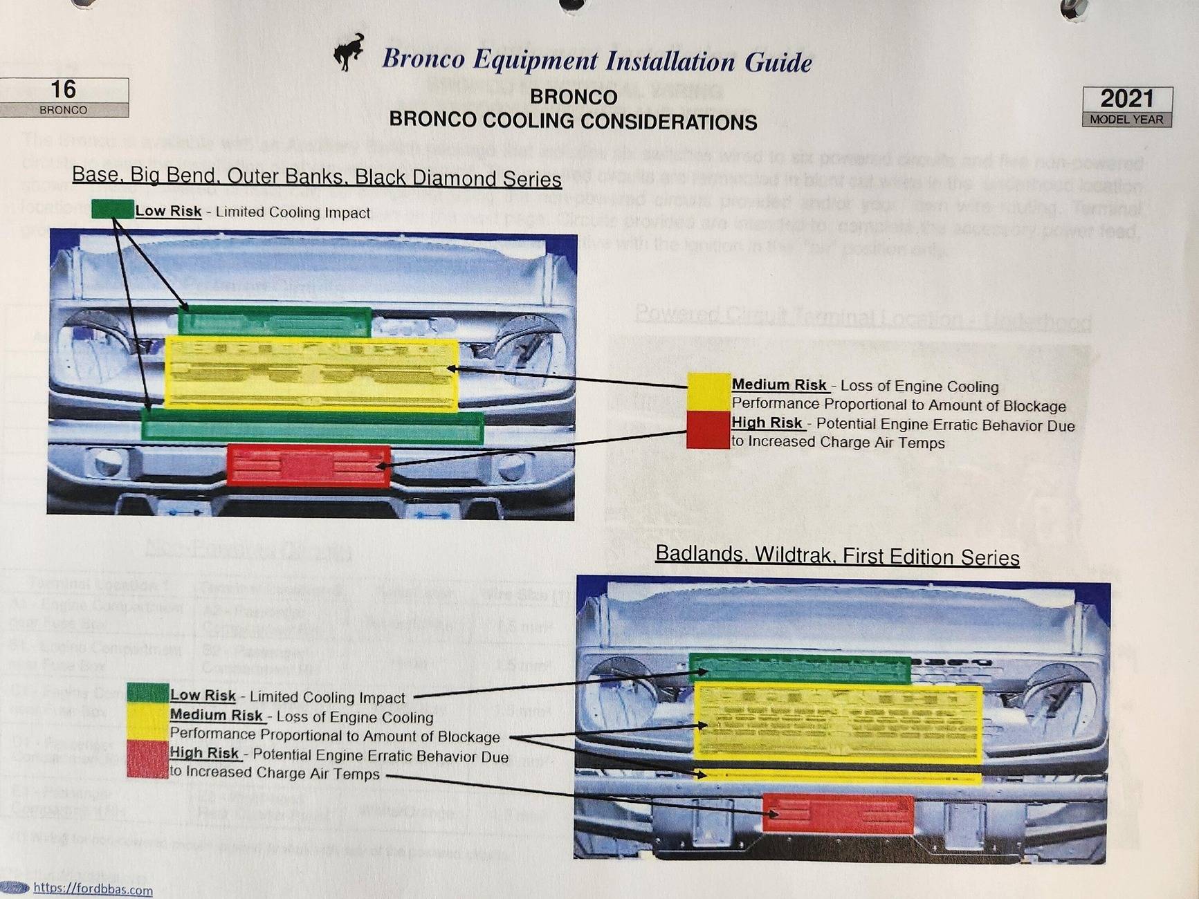

That's interesting since it directly conflicts with pretty much any winch installation, including their own Ford one.
It does block a good portion of what they consider medium risk, however it avoids the high risk that many winch kits, almost completely, if not entirely block. Many don't know or don't care about Ford's advice in regards to the winch placement, but it sure looks like they took it into account with the Everglades design. And with it being a Ford part, it shouldn't effect any warranty with regards to the cooling system/engine, which you may run into with the other kits.

I was initially concerned about blocking intercooler with my BAMF / winch but temps stay in 180-190 range on water & oil. I live in Florida. I took a road trip to northeast along rte 81 up and down steep parts of Virginia and Maryland with cruise control set at 75. Nothing out of the green temp-wise. There is enough airflow through vents and around winch For cooling.

Solid real world data. Appreciate that!
