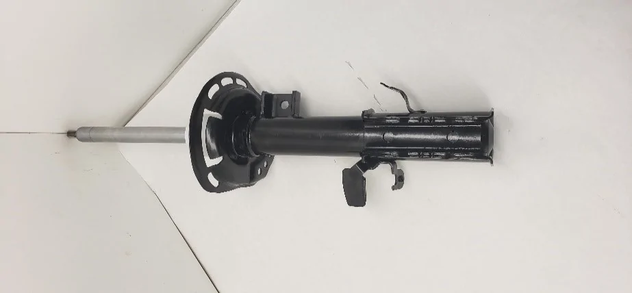

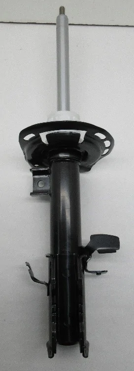

So, the Bronco Sport and Escape share the same platform, but the suspension is actually one of the significant differences between the two chassis. I suspect the Ranger/Bronco will be similar, as even if the Ranger went to rear coil suspension, it's not going to be tuned and setup for such heavy-duty off-roading. The Ranger Raptor will likely be the closest between the two, with maybe similar hardware but tweaked for the differences in both anticipated duty and weight distribution.
I actually just finished the comparison of the shocks and struts for both the Bronco Sport and the Escape. Both have the same design shock and struts, with very minimal differences. My assumption is that the aftermarket will consolidate.

I completely understand what Motor Trend has written, but having physically tested and measured the bare struts and shocks I can say without a doubt they are identical with very slight differences, mainly about a 1/4 inch extended and collapsed length difference.
Not the rest of the suspension such as the Coil Spring and Jounce Bumper itself may be tuned differently in order to accommodate Ride Height and Handling changes. Not quite there yet, but soon.
Still, my money is on the aftermarket consolidating the Shock and Strut.

I understand the application quite well It has nothing to do with the vehicle currently in my garage. Not sure why insulting what I have in my garage has to do with the topic, but to each their own. Look, I mean no disrespect and I am sorry that I have seem to upset you. That is not my intention.
This argument has simply to do with the geometry of the parts themselves. Specifically it was the Ranger vs the Bronco.
However, since we are digging further into this let me explain my position on the Escape and Bronco Sport more so that it does not get misinterpreted.
For the Bronco Sport and the Escape you can physically measure just the Bare Strut and the Shock and line them up. However, as stated before this is just the bare strut and the shock, which Motor Trend states in their article are similar. Their notation is on the Coil Springs and other areas of the suspension that have the changes. Something that I have never denied. Have not physically had those in my hands in order to show the comparison.
I would be more than happy to discuss the finer details of the struts themselves for the Bronco Sport and Escape. However, l would rather not distract from the Ranger to Bronco discussion. There has been some great information shared that I believe is great to read.
