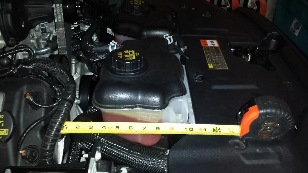

Should fit in an S197 too, 10" between the head and radiator.
That would likely be a bit tougher... based on bore spacing and diameter alone, the Godzilla is about 5" longer than the coyote... not to mention, on the Coyote, the crank pulley sits nearly flush with the front of the heads, whereas on the Godzilla, the crank pulley is a few inches from the heads. I'd guess all in all its probably almost 10" longer than a Yote, not to mention the height difference
Correct the front engine dress on a MOD motor is nearly flush from cam(valve) covers to oil pan. The 5-OH (old school) and the 'ZILLA front share the same architecture, engine block then timing chain but not running all the way up to the covers and then water pump it does add about that to the "front of the cover to the crank pulley" dimension . It looks like the 7.3 also has variable valve timing as well.

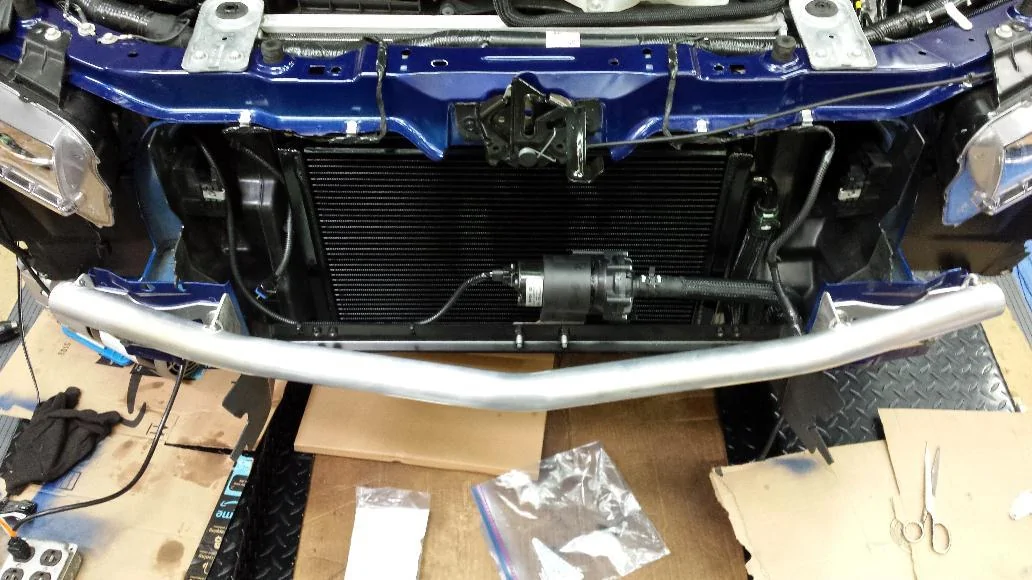

OX1
May 25, 2017
1,333
1,337
jackson nj
59 Brd, 70, 78, 79 Brncs, 84 LTD 331, 86 Cpri 5.0 Trbo, 17 Fsion Sprt, 21 GT 500
I get 4.317 from Bore and BS differences, so 5 seems reasonable. Plenty of room in front of rad support, especially
with aftermarket bumper support. So might be some fab work, but plenty of space to work with
Ford Bronco Ford posts official Bronco mule off-road testing video 20170527_151120
Height is easy on Stangs, plenty of hoods for that.
