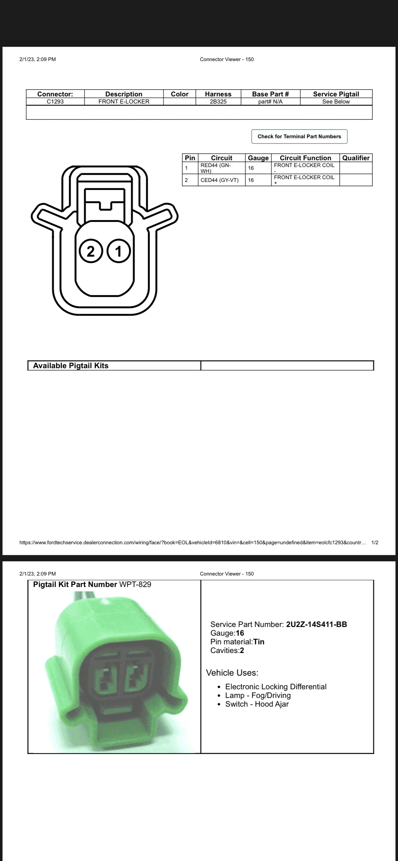

Here's the wiring schematic for the locker from ford, ford performance tech team recommends a switched 5 amp minimum circuit. Pin 2 is the hot pin and pin 1 is ground
Awesome, doesn’t seem so bad. What about the switch to activate the locker? Were you able to drop in a hero switch board with the front locker button or did you have to plug it to an aux switch?
No that's the last part there, ford performance recommends a switched 5-10 amp circuit. According to them there isn't a way to do the hero switch swap yet, another member has tried as well. Everyone I know has it on either an aux switch or has put in a switch somewhere in the cab for it

I have one more question. Since you upload the tune with the Procal does it have all the features on the gauge cluster that it would from factory like it tells you the front locker is on and doesn’t let you activate it without the rear locker on and gives your warnings? Or is just like an aftermarket one that you just have to know It’s on and when not to use it?
You just have to remember it's on or use a lighted switch, it won't have any communication with the bronco, only with you. The procal is only disabling the front axle disconnect in the tune and allows you to change gear ratios if need be.
Im going to guess one day someone will figure out the programming behind the factory dash switches but according to ford it's currently not possible even with a harness.
