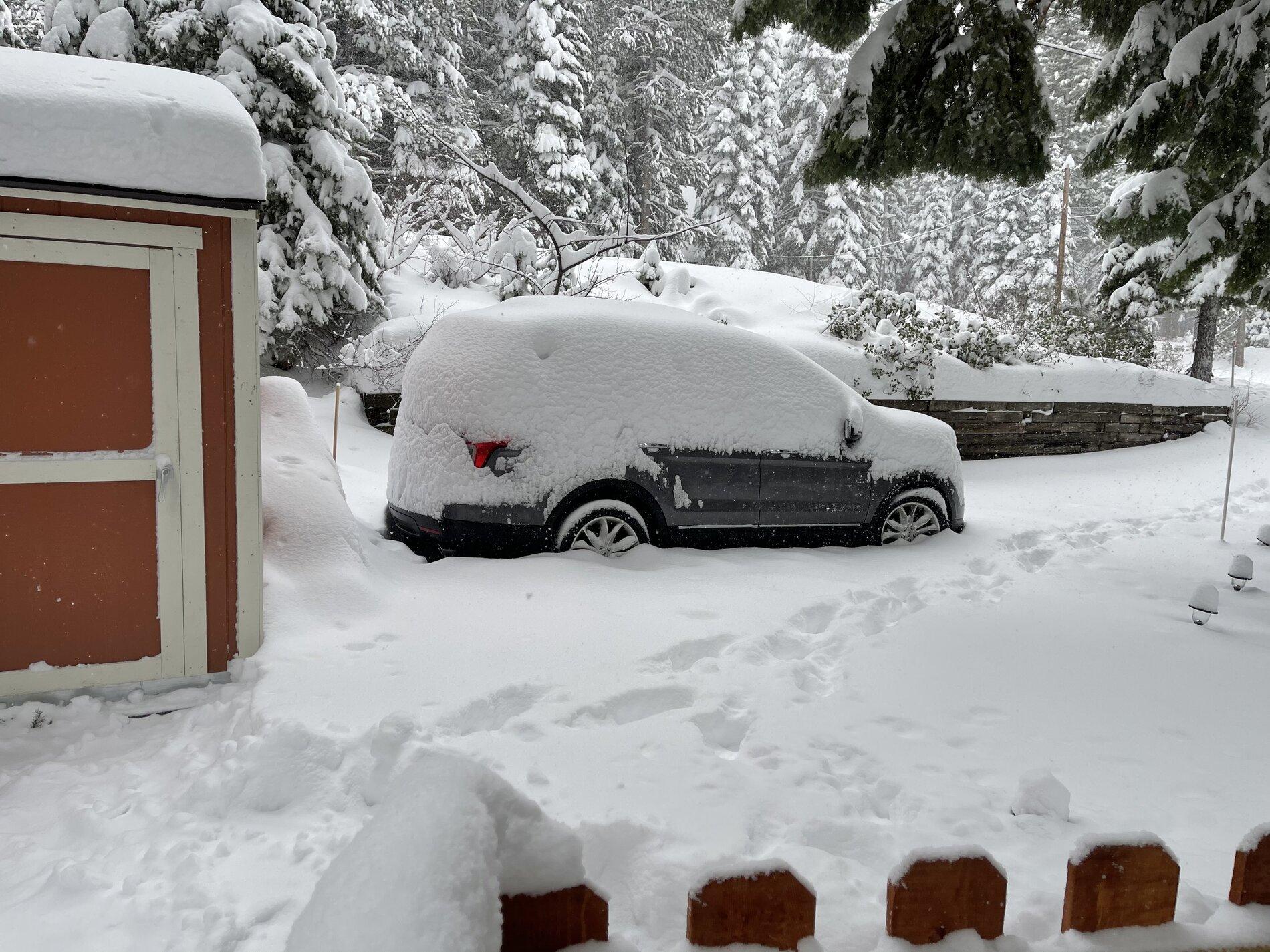

This is where I’m going to be parking mine. You think I should get it? Or not?
