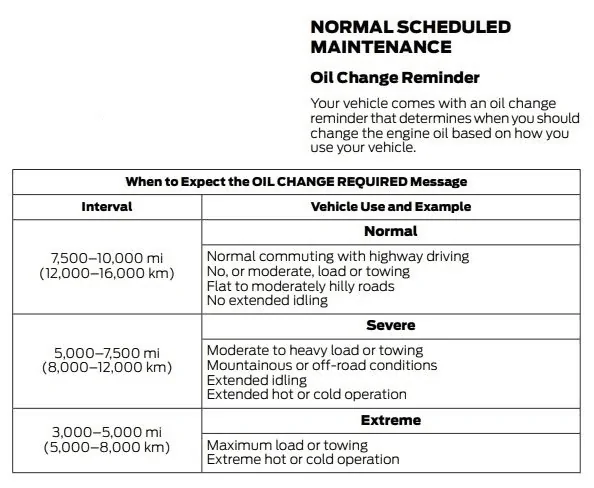

Per Owner's Manual:
Ford Bronco Ford oil change intervals 1626018811008

Couple things...
1) oil technology has far surpassed the old way of thinking.
2) running 10k on today's synthetics and regular driving is very doable, and changing it more than that is just a waste (of money and environment)
3) if you doubt, instead of tossing $30 out the window for an unneeded oil change, skip it one time and send a sample to Blacklabs for the same price...truly an Eye opener.
I have 2 cars, 1 just about to hit 100k, has seen nothing but 10k oil changes and black labs to back it up. Yup..only done 10 oil changes in the 8-9 years I've owned it.
(Again this is not Turbos or off-road driving)

Jeep Wrangler JKUR
Modern Ford vehicles have an IOLM (intelligent oil life monitor) that monitors ...
I don't know how all manufacturers do this, but the ones I've had are just using an algorithm to "guess" so I would never go by one of these. Until I know 100% that they have some means to actually TEST the oil somehow...no way in hell.
