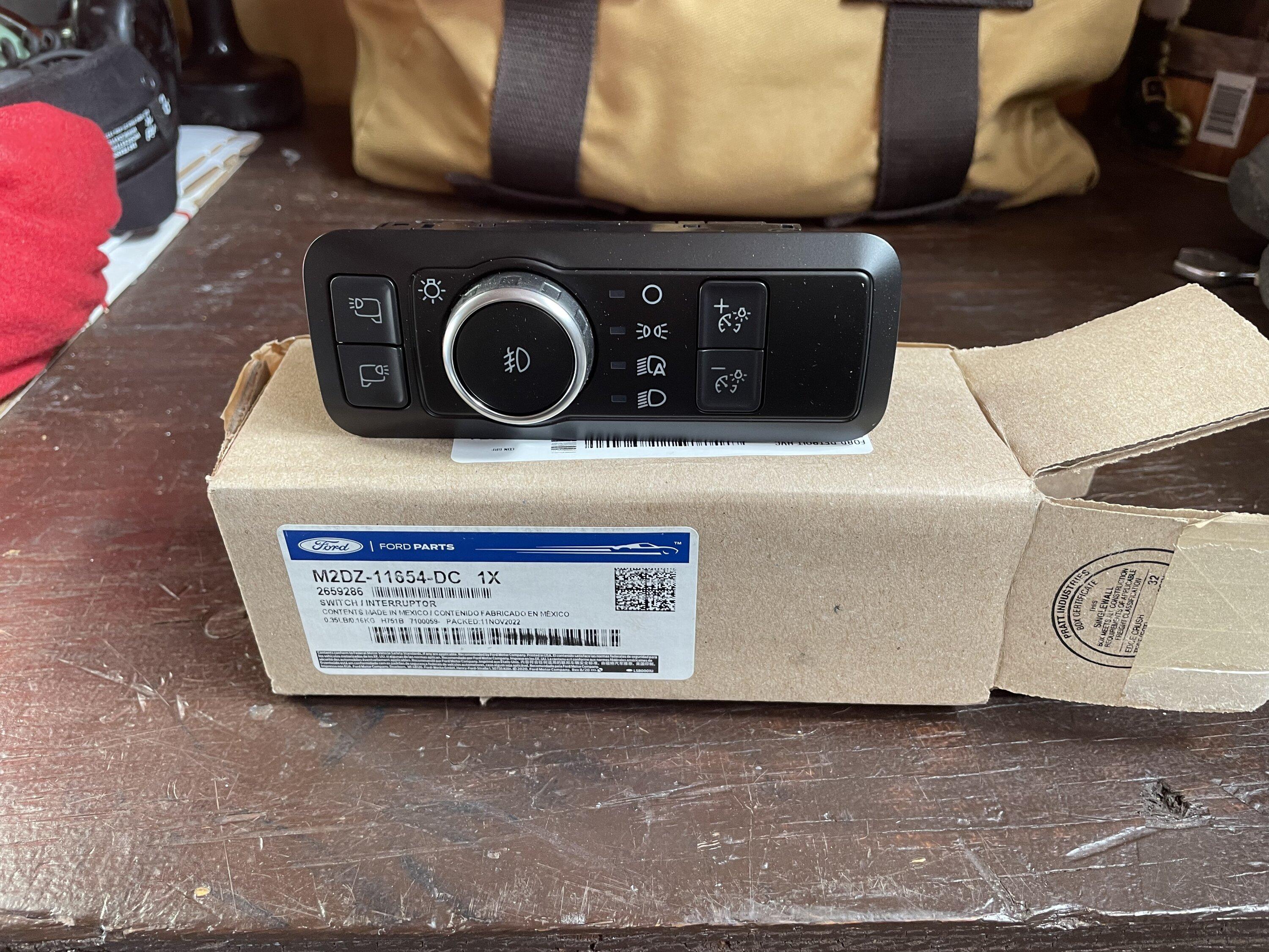

I have a sheet from the dealer with different switches. The numbers are similar except for the DA at the end. So that’s where I’m drawing a blank
This is the one I got from Tasca
Looks like it’s M2DZ-11654-DC instead of DA.
They mention it replaces: M2DZ-11654-DA, M2DZ-11654-DB
Cool. When I went to the dealer they seemed clueless. Basically handed me the sheets and left it up to me. Appreciate the info!

-DC is the switch for vehicles with front fog lights, power adjust, heated, puddle lamps, blind spot, spot lamps, and No rear fog lights.
Basically a loaded bronco with front fog lights.
There 8 different switches depending on your options.

Here is the one I used for my ‘22 Wildtrak, the DC seems to have replaced the earlier DA & DB switches.
