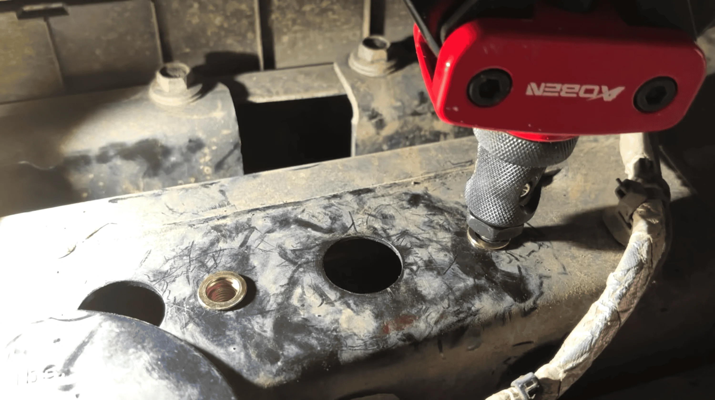

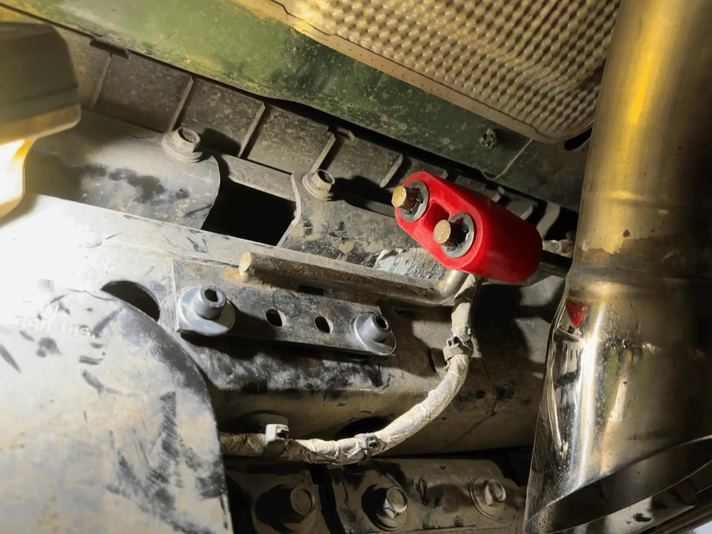

I picked up a used exhaust (previous owner thought it was too loud) and watched a couple videos on the installation. With a hitch installed it's even more challenging. After struggling for a bit I wondered why I couldn't just use some rivnuts so I grabbed a couple M8 and they worked perfectly! Made the install instantly easier.

I just had a couple M8 bolts laying around. I may switch these out later. If I remember.
