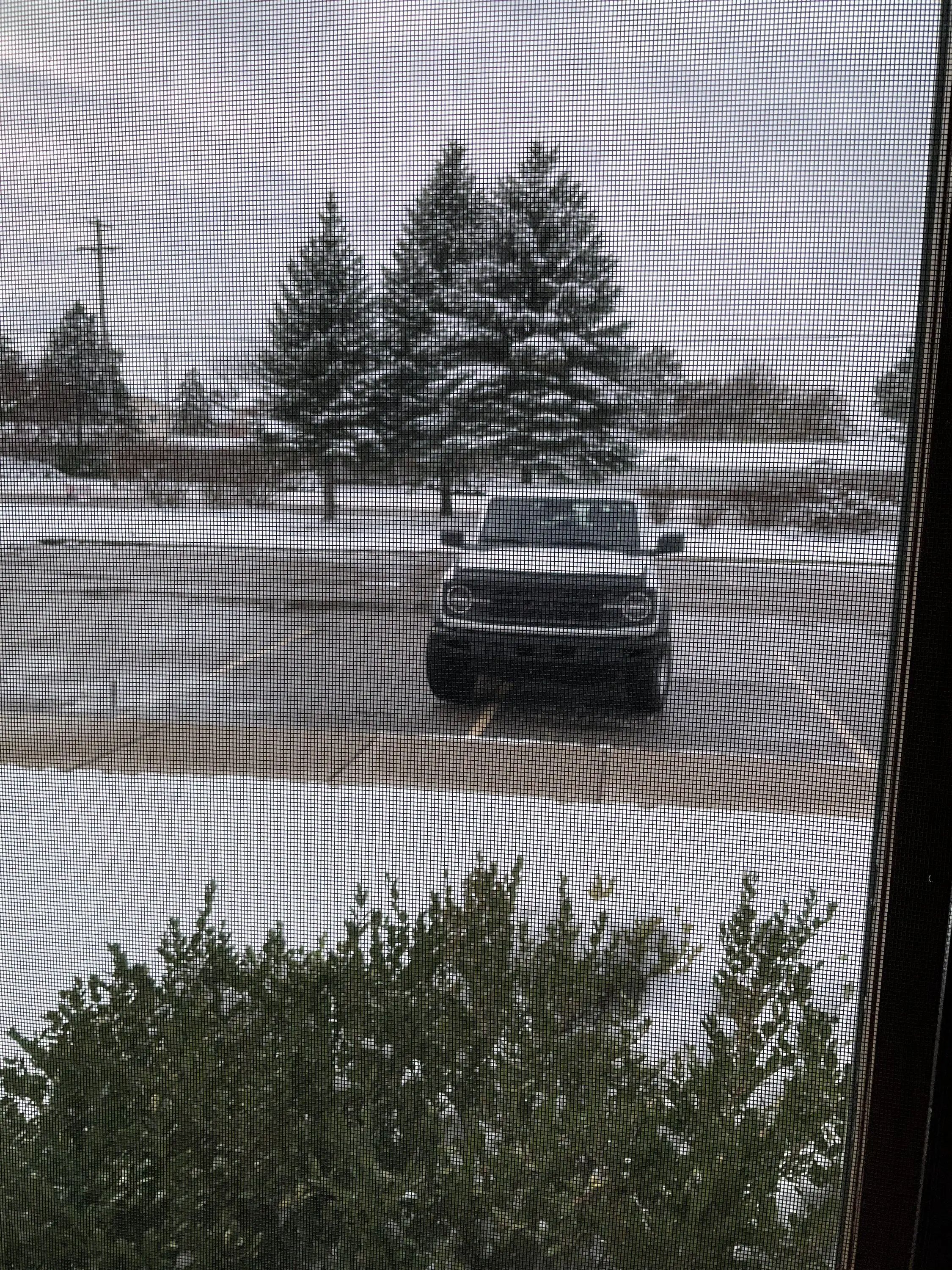

So far so good. First test and after 1 hour, 20 minutes, headlights have not come on!

That would be frustrating. I wrote out a memo detailing the issue, what I have observed, the hour and twenty minute delay, and copied the SSM. I went over that with the service manager, and even mentioned I have photos if he didnt believe me. I also taped a copy of the memo to my dash so the technician could read it too. I explained that if they didn’t wait out the time it likely wouldn’t repeat itself. You should go to another dealer if that is an option.
