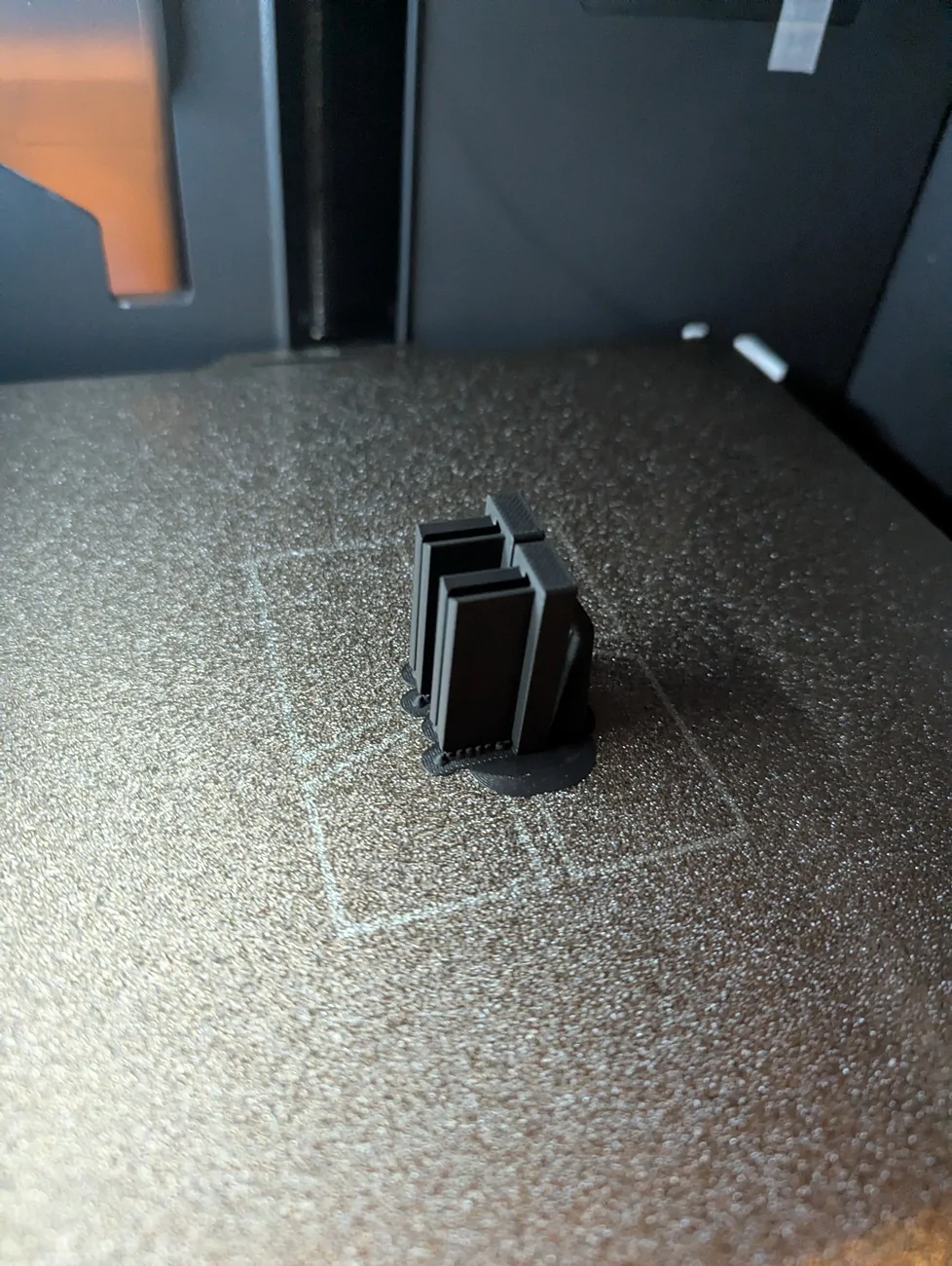

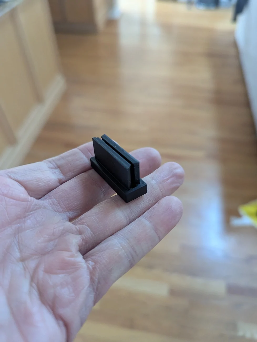

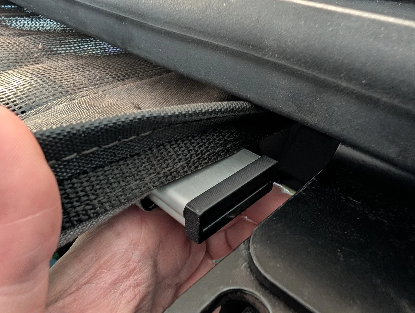

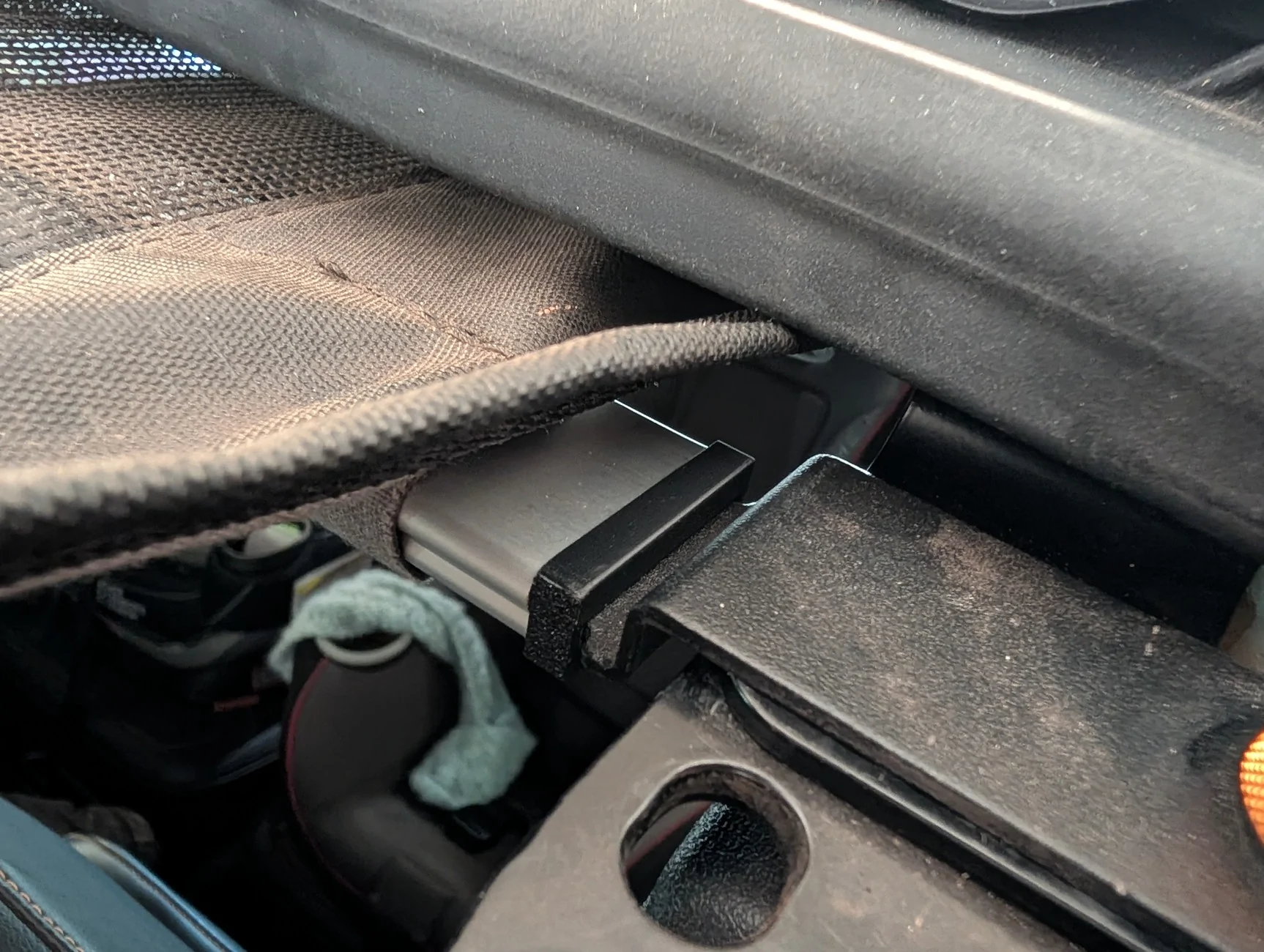

I modeled up a small bracket/shim that press-fits into the crossbar extrusion and takes up the slack. It's a snug fit that keeps everything tight without requiring adhesive or modification to the top.
I 3D printed it in ASA (much better heat resistance than PLA which is important since this lives in the sun all day).

I've had it installed for a month or so, mostly with the roof on, but some limited testing with the roof off as well. The rattle is completely gone. The inserts stay put. I'm still testing and refining the design, but I'm curious:

As a follow up, I just installed mine and they must’ve made a change in the cross bar mount. Your mounts turn downward and then engage the cross bar. Mine are straight. The only downward turn is at the opposite end to keep mount from moving. The cross bar is tight. No movement at all, no rattling or vibration.
