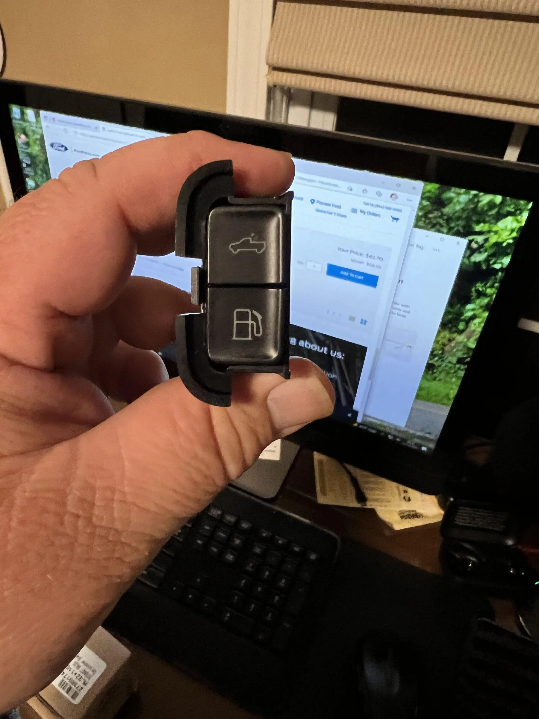

Interesting - I checked them out - they are Escape / Explorer switches - look the same except for the gas tank lid switch where I have puddle lights. Not sure if I can swap - but good backup plan in case I can't get the other parts - thanks.

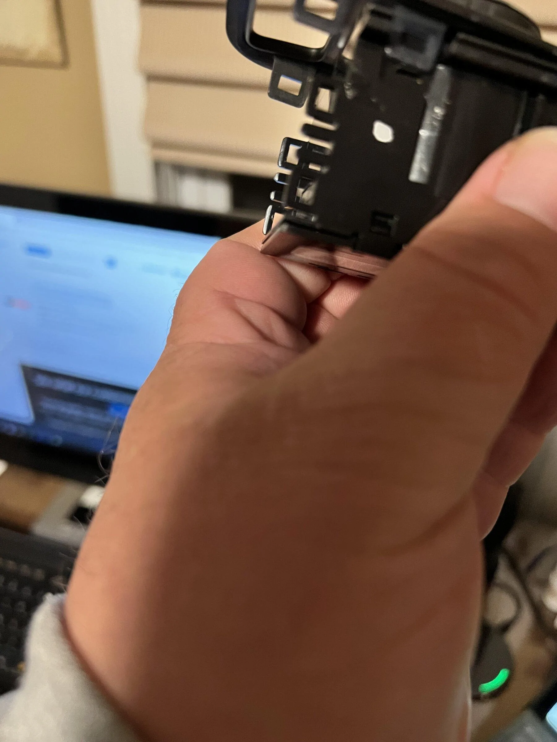

Yes it is an easy swap. You don't even have to completly remove the bezel. There will be four tabs that hold the bezel to the switch on the button side. Loosen them, then there will be four tabs that hold the buttons to the switch. just loosen them and the buttons will pull away from the main switch. Just plug in the buttons from your old switch and resnap the bezel down and you are golden. Just be careful plugging the buttons back in the connector is tiny.
