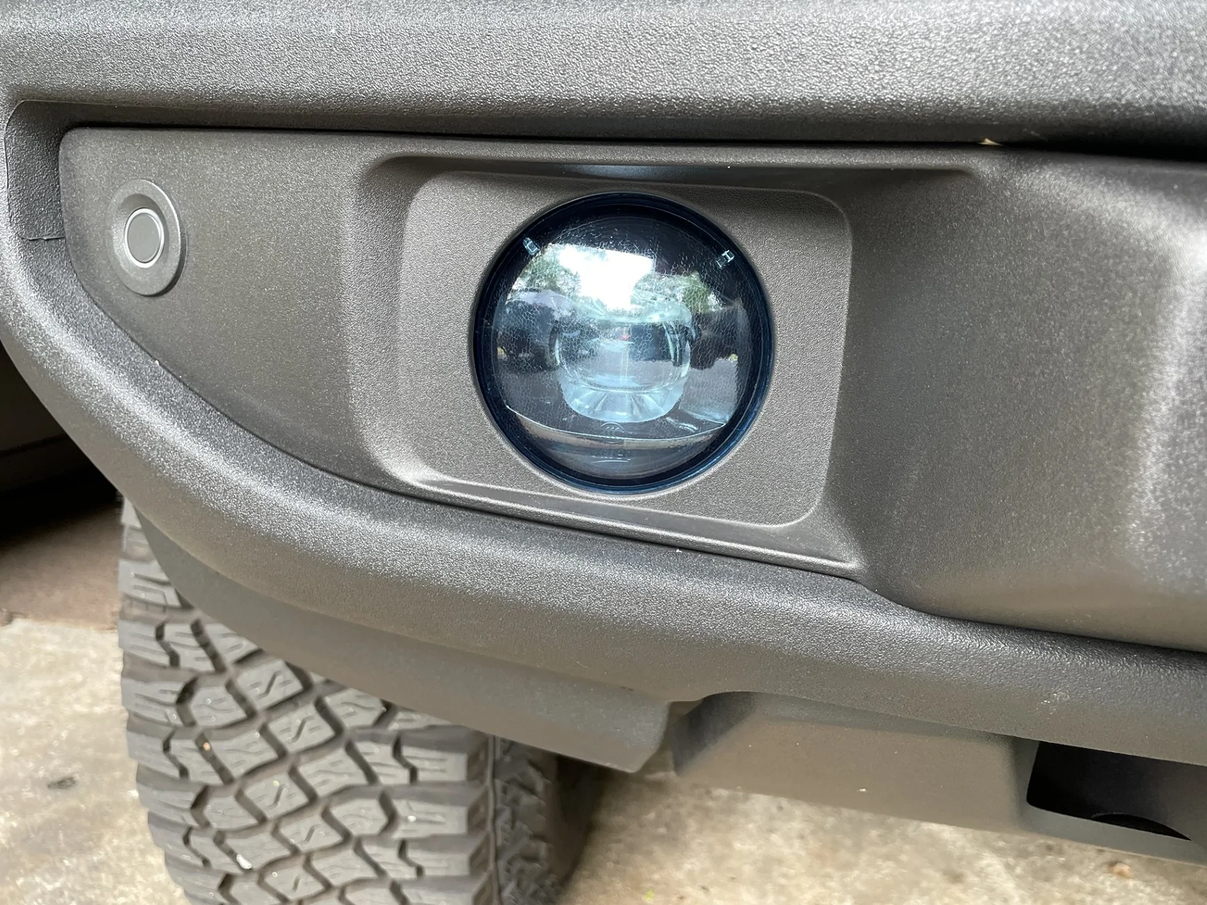

I liked having these lights on all the time, so I used ForScan to enable them with the DRL and High Beams. I also put a blue tinting on them. Leaning into the blue accents for the Wildtrak.
Ford Bronco Factory fog light not turning on Blue lights Fog
