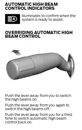

Fog/Driving lights are programed to turn off when the high beams are activated. So if you have automatic high beams they will turn on and off with the high beams as you drive.
That's a possibility since it usually happens when going over a hill now that I think about it. Didn't realize it even had that feature. It's an OBX with high package. Will have to check the features.
Thanks!
