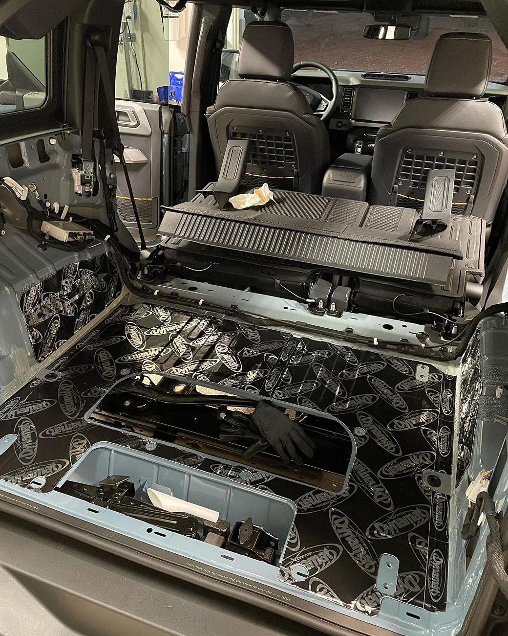

Summit981
Paul
Dec 14, 2021
320
425
Maryland
Porsche Cayman, MINI GP2, MINI Countryman
There are YouTube videos describing removal of the full interior to lay down sound deadening material. When I bought my 2022 Badlands, I watched these two videos by 1Five1 Garage to install Dynamat in all four doors and interior of the rear cargo area: (rear cargo area) and (doors). Both were great reference tools for me to refer to while undertaking this install in my garage and driveway.
