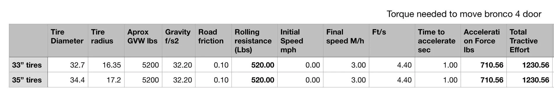

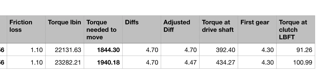

Just did a BUNCH of maths!
figure the 4 door bronco Bandlands 7speed weighs 5200lbs.
And your accelerating from 0-3mph in 1 second.
With 33” tires you need 90lbft to move the car.
With 35” tires tour need 100lbft to move the car.
So that means you need 10% more force to do the same thing.
That force makes a clutch work 10% harder.
Doesn’t sound like a lot at all. But that’s a massive difference from and engineering standpoint

lots of maths..... but you can see the torque needed at clutch to move the car. 33 vs 35
