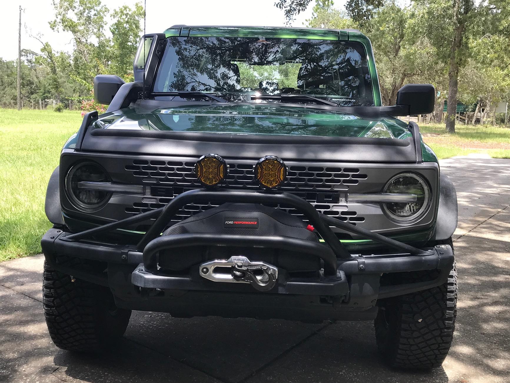

My latest additions are some off-road lights, the hood bug guard and the winch cover.
Next purchase will be the trans skid I think.

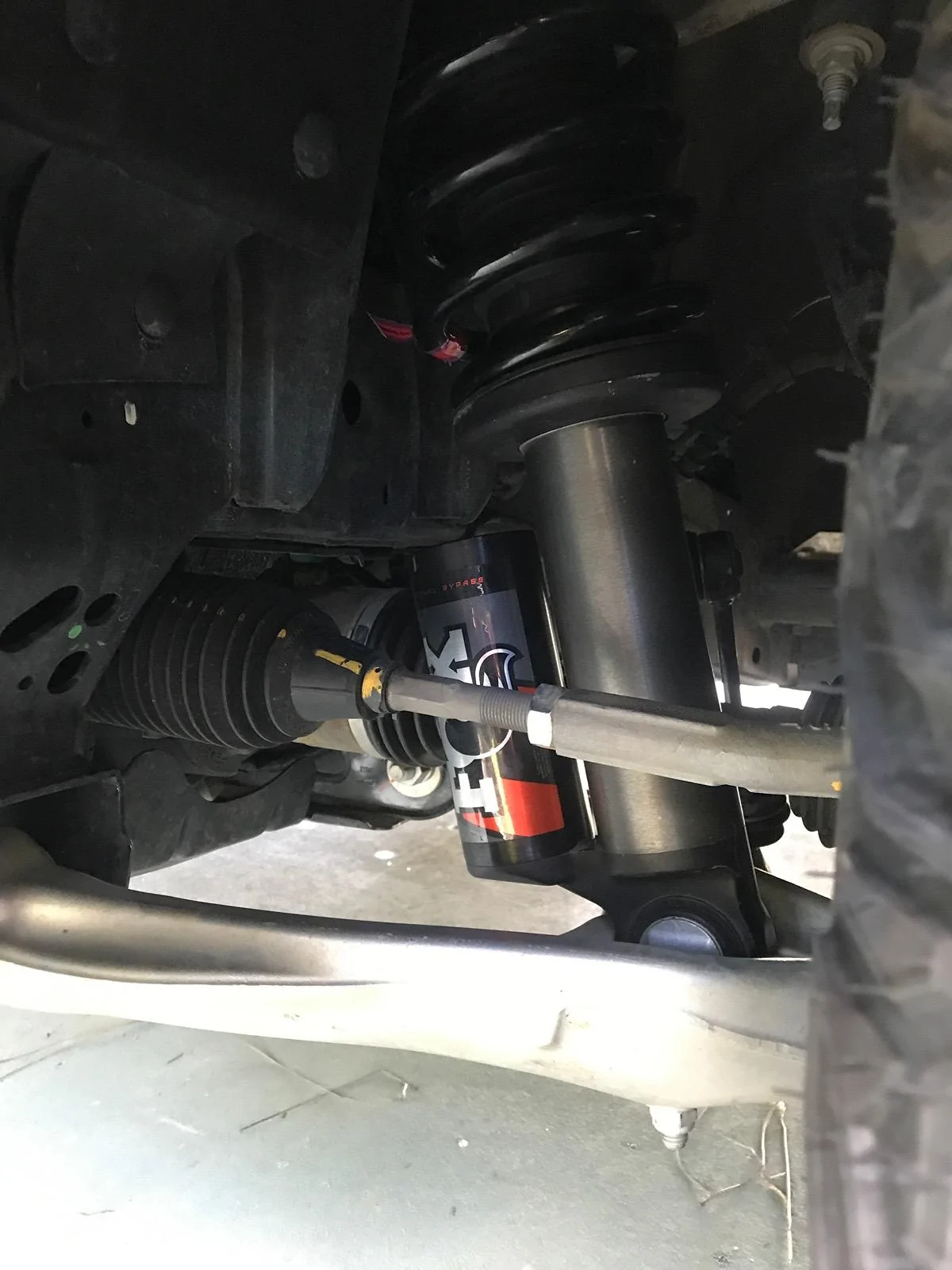

Disconnected the front sway bar links and went out this weekend for about 4 hours of trails. Felt good at speed on pavement to the trail head. Was nice at speed 40ish mph on dirt track, and good on the slow stuff. Not sure how much extra flex it gained, still has no problem doing the Bronco wave.

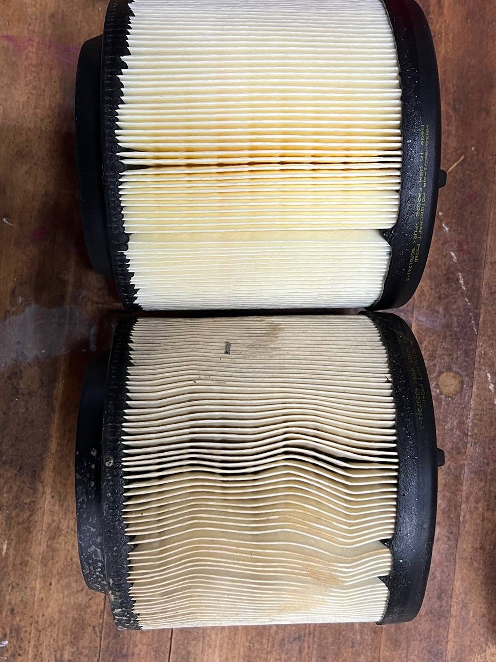

First air filter change, 9500 miles and I’m surprised how clean it is.
I live on a dusty road and drive on dusty trails often. Splash in water and mud a lot also. The snorkel picks up cleaner air for sure, most definitely has kept a lot more water and dirt out vs the front facing grill intakes.
