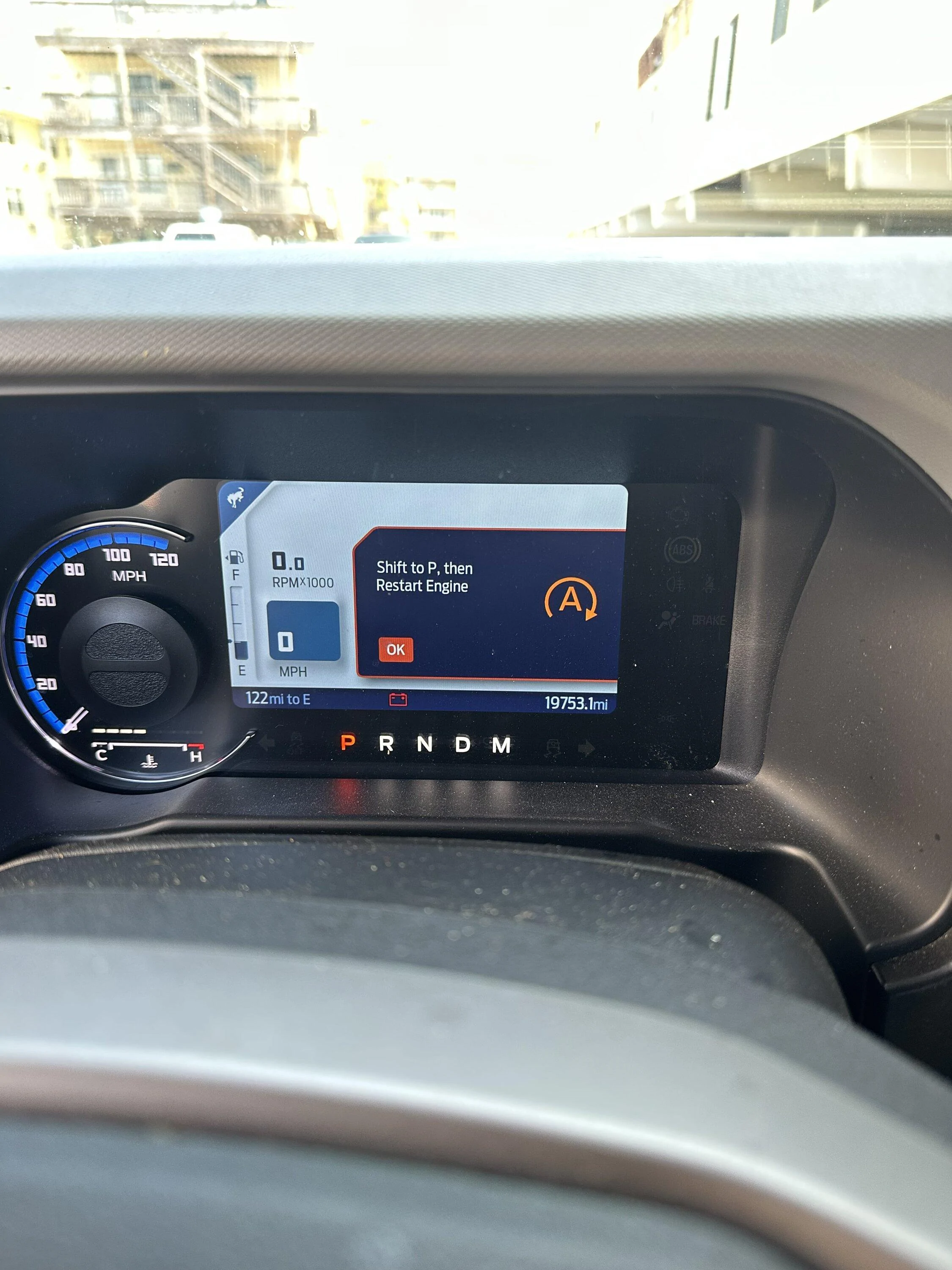

Hi everyone,
At the beach today a pedestrian was crossing the road and I made a sudden stop. Nothing at all too drastic. But the truck stalled out with a message saying, shift to P then restart engine. About 10 minutes later, I made a left hand turn from about 10 mph to a side street and the truck stalled out with the same message.
Coincidently I did check ground cables and battery cables last night before making my trip, a preflight inspection.
Any idea or anyone seen this ?

Or the fuel pump is giving up the ghost….good luck.

Something to think about thanks. Will chk with dealer. I also think it may be related to auto start stop.

I saw that message when my fuel pump died but it died hard, there was no restarting it was a tow to the dealership.
There are a lot of reasons to dislike ASS, but I doubt it's relevant to this case. It sounds like the torque converter failed to disengage and/or the transmission failed to downshift and it stalled the engine. ASS is intentional and only happens at a complete stop, and it knows to restart itself when pressure on the brake pedal is released. My chips are placed solidly on the transmission.

here is a Ford Maverick thread about the same thing. Dealer told him the transmission "valve body outta spec"
https://www.mavericktruckclub.com/f...hutting-off-when-i-come-to-a-full-stop.13631/
Despite the easy to make double entendres - I hope the dealer can pull some codes from the transmission. Thanks for the input. I have a long ride back today so I will see if it does it again and also pay attention to the shifting.

Hi Broncolli - I am having the same issue and my car has been in service for 112 days now. The techs and Ford Service Engineer cannot figure this out. Can you please share your findings with your Bronco - assuming its fixed? I appreciate your help in advance!
