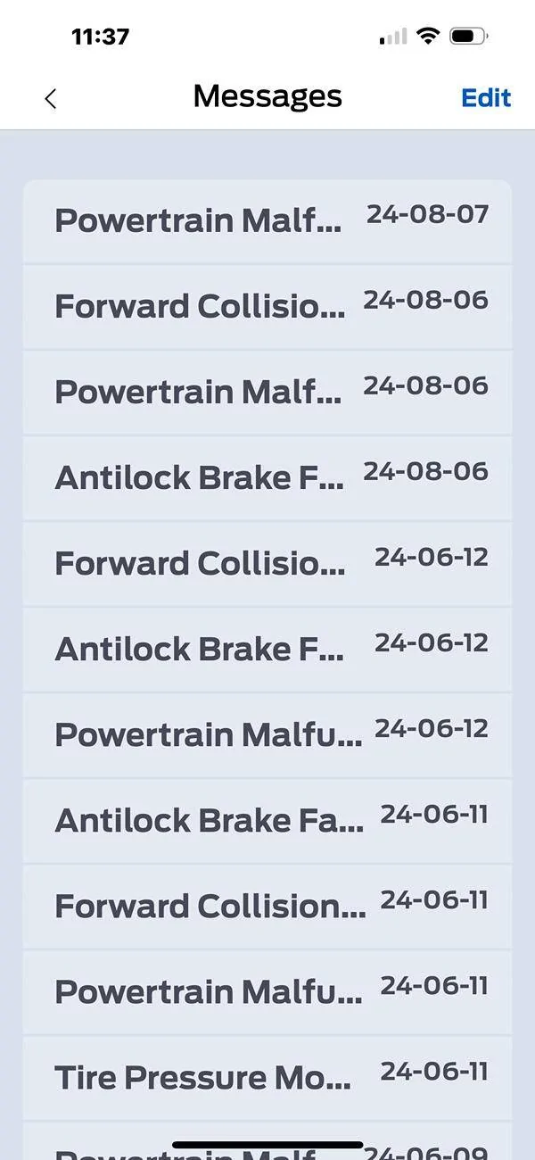

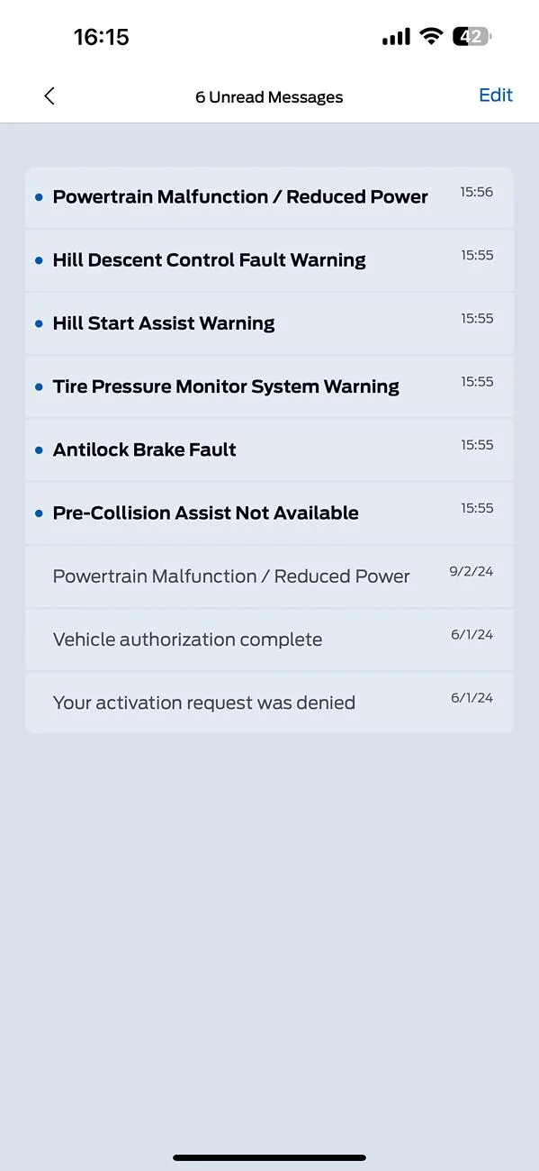

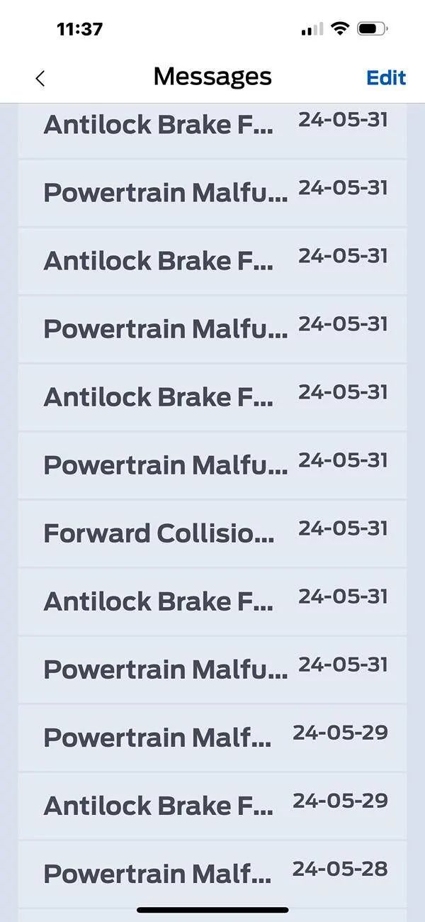

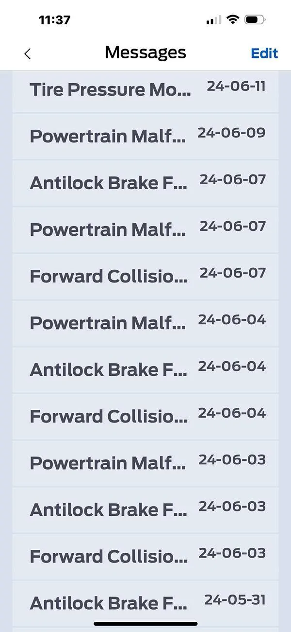

I have a 2022 Badlands non/SAS high package that I‘ve only had for just over 3 months. It has 50,000 miles on it and suddenly we are having multiple warning lights come on at random times. Getting a vehicle communication failure and both screens turn to the vehicle off mode intermittently then come back on. Service engine soon light come on the same way. The warnings lights range from Traier brake failure (when not in use) to just about every other system failure all cycling within minutes. Then the next time you start the vehicle it will drive fine for awhile before starting all of this again. Anyone else experiencing something like this and if so, what seemed to be the issue?

This looks like about all of the warnings we are getting. I will check on this asap and tighten it all down if it’s loose. Thanks
