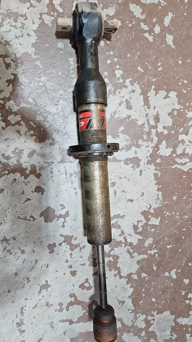

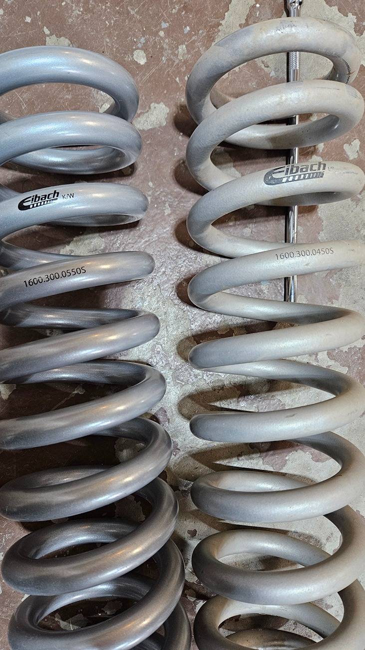

If you are just swapping out the springs, I just did this. I didn’t mess with a spring compressor. I just took the top shock nut off and raised the truck till the spring was loose. Undid lower mount and pulled the coilover out, swapped springs, and put it back in the way it came out. Way less sketchy than using a spring compressor! 😬 Fronts are a little bit more involved but you get the jist.

Only pics I got...
Only pics I got...
Is this what you did?
