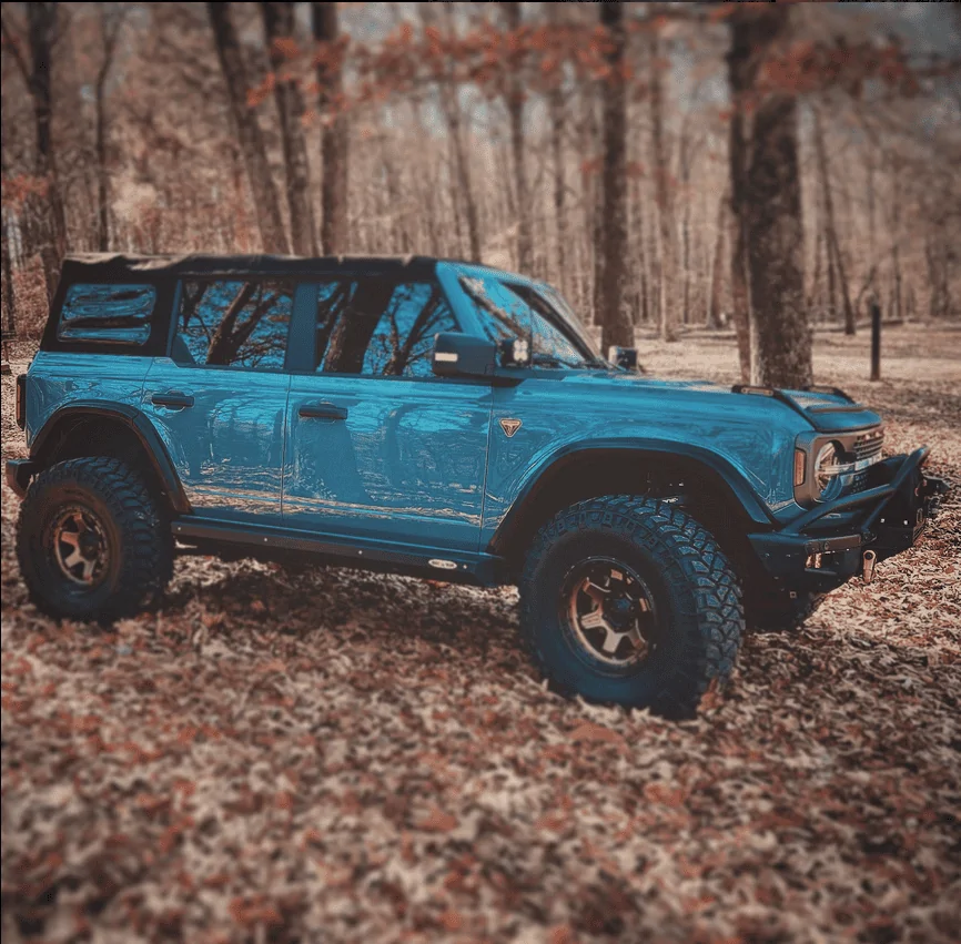

I don't have a winch, but I don't want sag in the front. How is the ride with the 550? Have you gone off roading? I have a Badland 2.7 4-door.
I have the Badlands 2.7 4 door as well. It’s the heaviest of all the trims and didn’t want any sag either. The ride is good and no problems off road. With the swap you get 3” up front which helps with the 37’s.
I was going to keep 35’s, but want Max height. How do they feel compared to your original shocks? Did you upgrade the rear?

550 pound from Eibach
been pretty hard on them and no complaints about ride quality, but I do have a winch mounted up front along with Tricky Dick’s beefy frame horn reinforcements
never notice the heavier springs when driving, feels A LOT better than factory
They feel as good or better. Kept the rear Coilovers the same. You get 2” on the rear so makes it level. I hate when the rear sags on those spacer lifts so these were perfect to make adjustments.

They feel as good or better. Kept the rear Coilovers the same. You get 2” on the rear, so makes it level. I hate when the rear sags on those spacer lifts so these were perfect to make adjustments.
Thank you everyone. Awesome information. I just got off the phone with Eibach. They said they are in the process of designing and producing a new HD spring specially designed for the front of a Ford Bronco that would allow for full use of the threaded collar. Running Max with the current HD 550 spring can cause damage if compressed all the way. They said it should be available this coming summer.

I promised I would come back and give you my review after installing the Pro Truck 2.0 coilovers from Eibach. After setting the height at around 1.5" over the Wildtrak standard height, also added zero offset Method 705's using original tires, I have the look I wanted all along. The ride on the freeway is noticeably smoother and offroad I feel the springs flex a little more. Glad I made the purchase!
