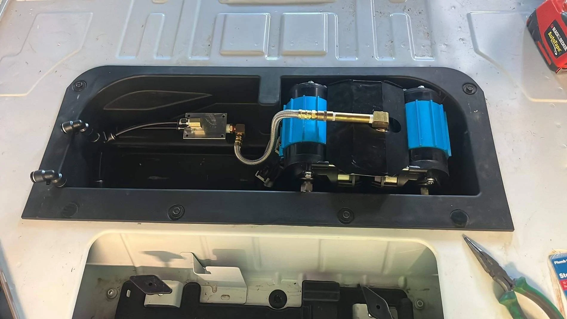

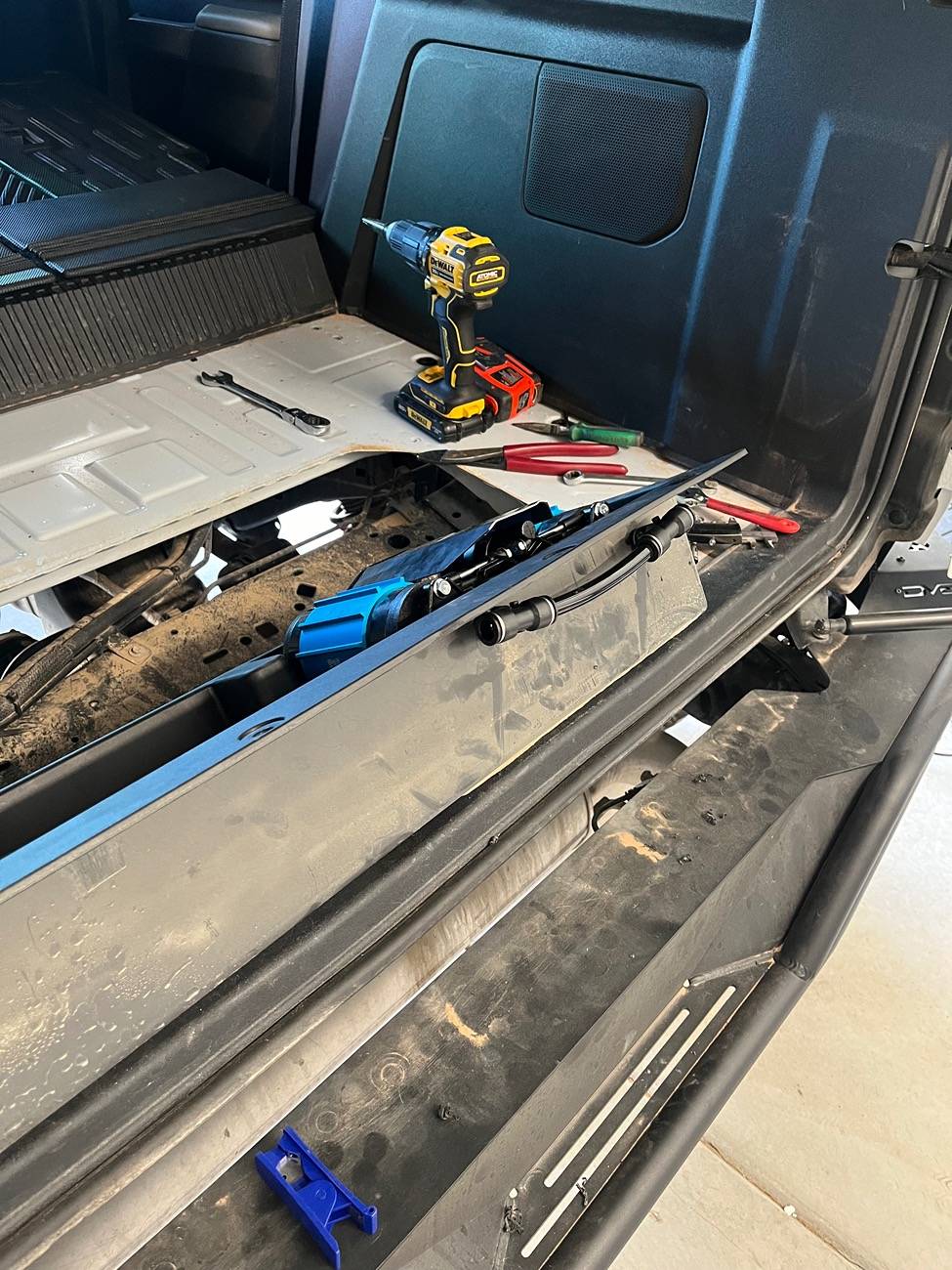

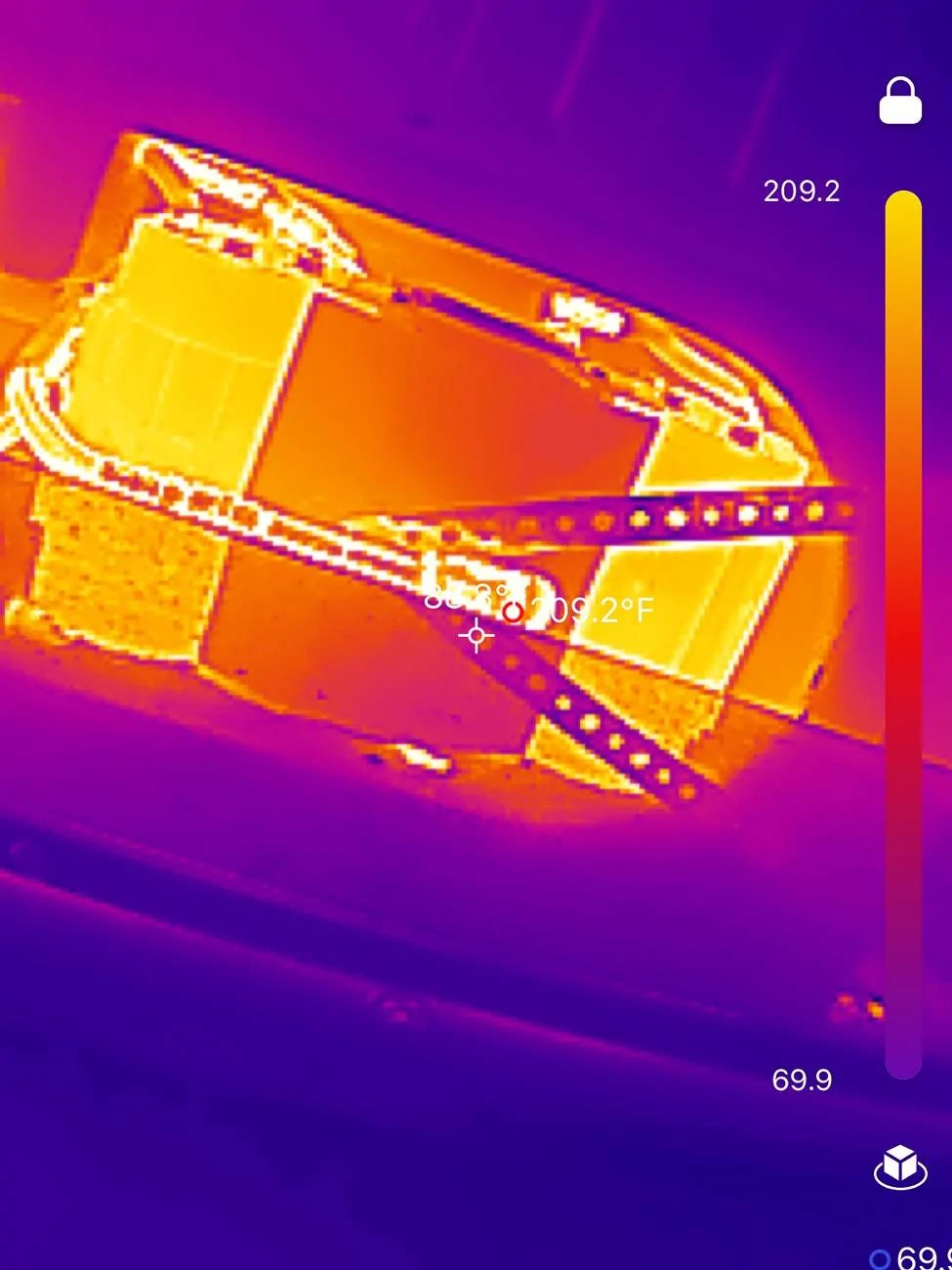

Max temp we’ve seen (when checking) after airing up 4 forties was about 209F on the outlet. This is still in the factory box though, so a lot less air than the the DV8 box, but it’s under a toolbox with a sliding drawer and deck. We also routed the intake outside the box by drilling through the sides, connecting both intakes together outside the box to further lower resistance, and routing the intakes back up into the cabin behind the panels so they’re drawing in cool, clean air rather than the hot air inside the storage area. Can’t tell you if that makes a difference or not but in theory it should help with efficiency of the compressor.
My compressor is currently mounted outside, and I‘ll add that I also did this intake routing for the same reason - AirCon air vs. TX/SW outdoor summer air is way easier on the equipment. When I move ARB to the box I’ll keep that same routing.
