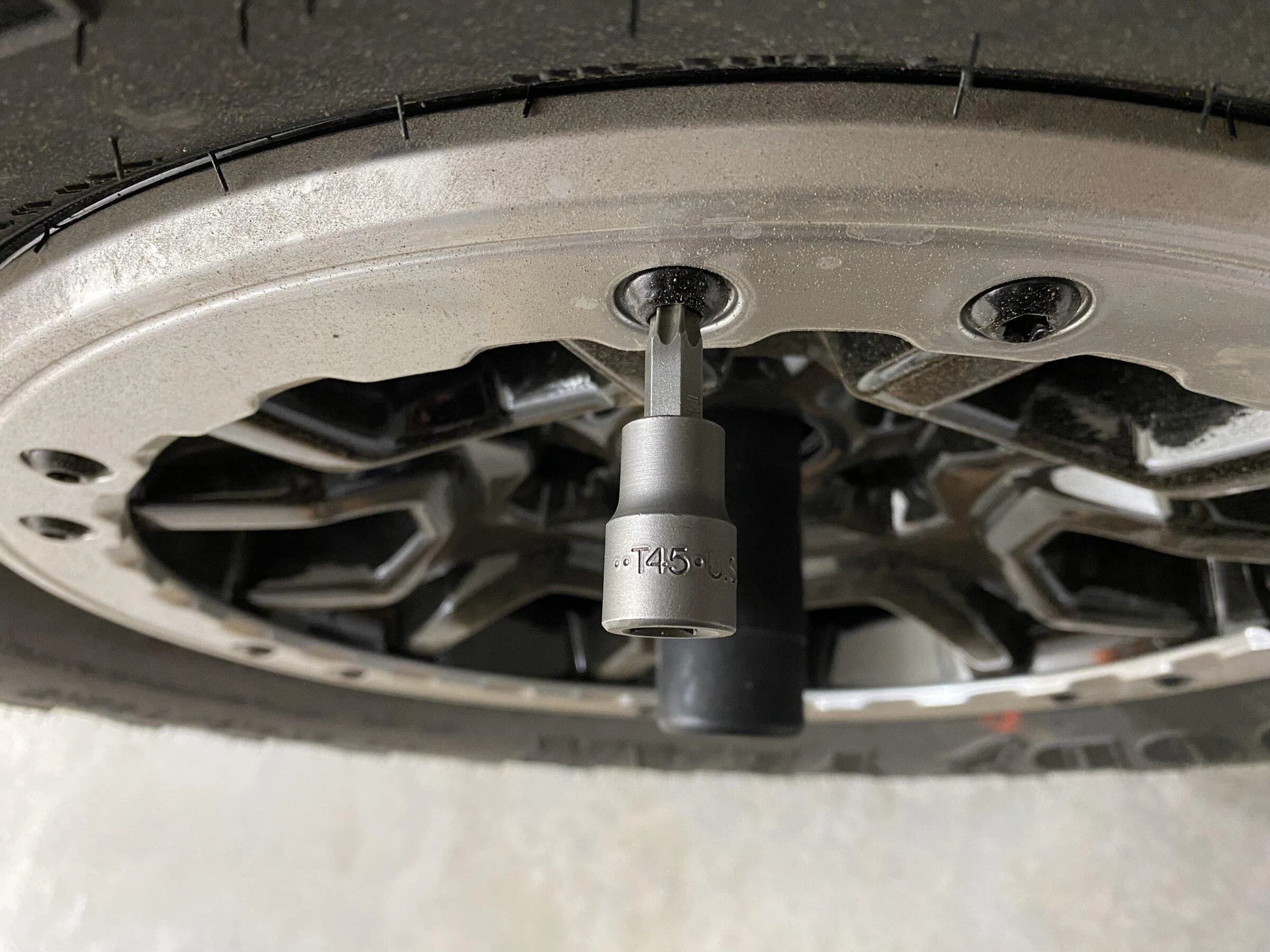

Torx 45 (T45). Standard Torx, not Torx Plus. TP45 will not fit.

On my Bronco Badlands with Sasquatch package, only the T45 fits…

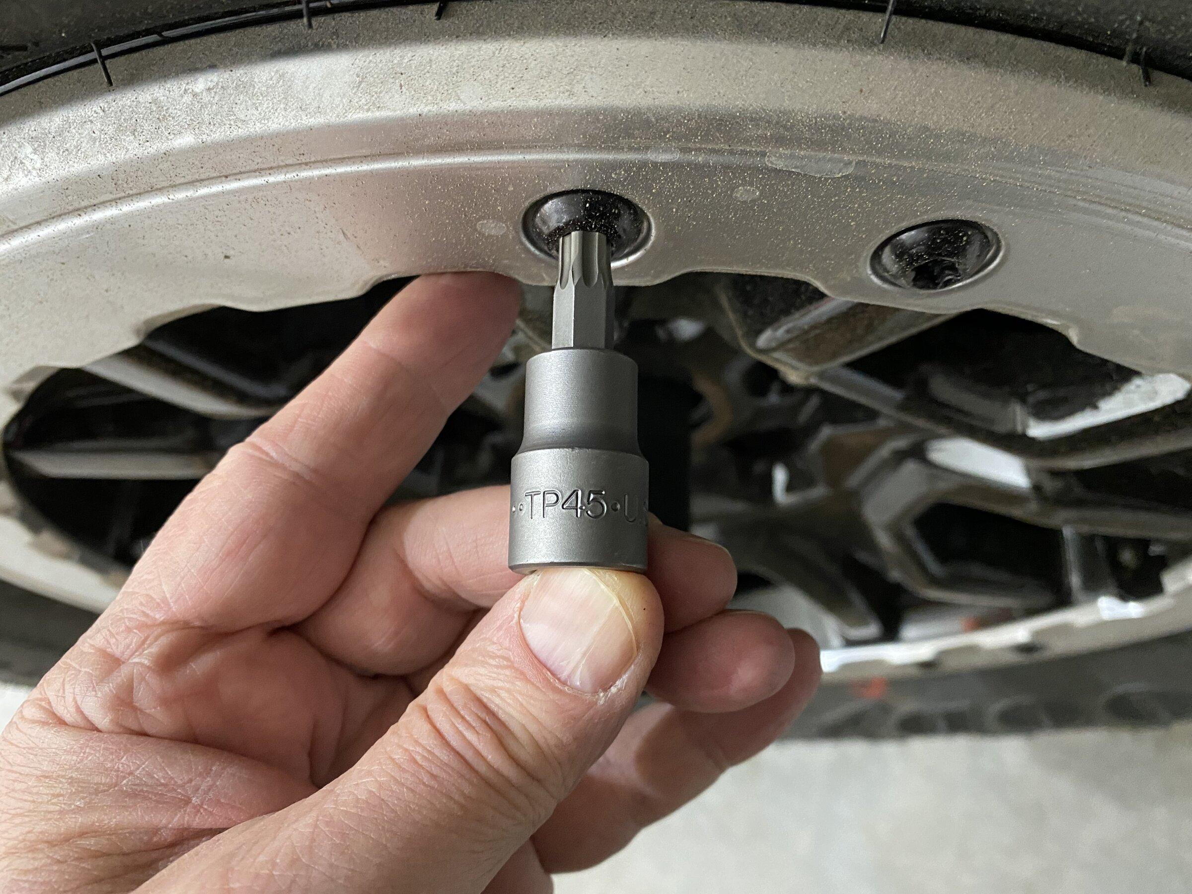

On my Bronco, the TP45 does NOT fit. I am holding it against the bolt, but the bit is not penetrating the standard Torx recess…

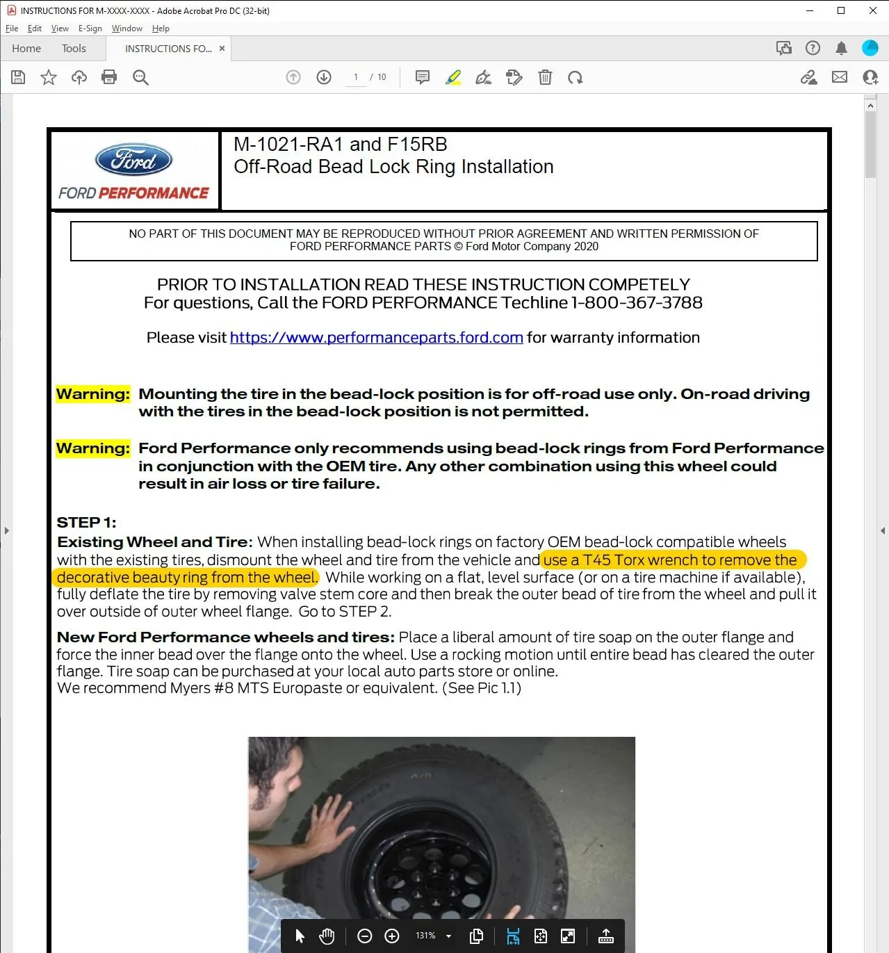

The installation instructions for the bead lock rings (attached below) also say to "use a T45 Torx wrench to remove the decorative beauty ring from the wheel."
Ford Bronco Driving without bedlock beauty rings installed? And torx bolt size? T45 on Beauty Rings
I guess it is possible that Ford has been selling Broncos with both tool specs, but I can only speak about what is on my Bronco and in the Ford installation instructions for the beadlock rings. To be safe, I would recommend trying both bits before attempting to remove the rings, especially if the T45 bit appears to have a very loose fit.

T45 fits…
I am a mechanical engineer and a tool junkie. Please trust me on this, even if you think the photos are fake.

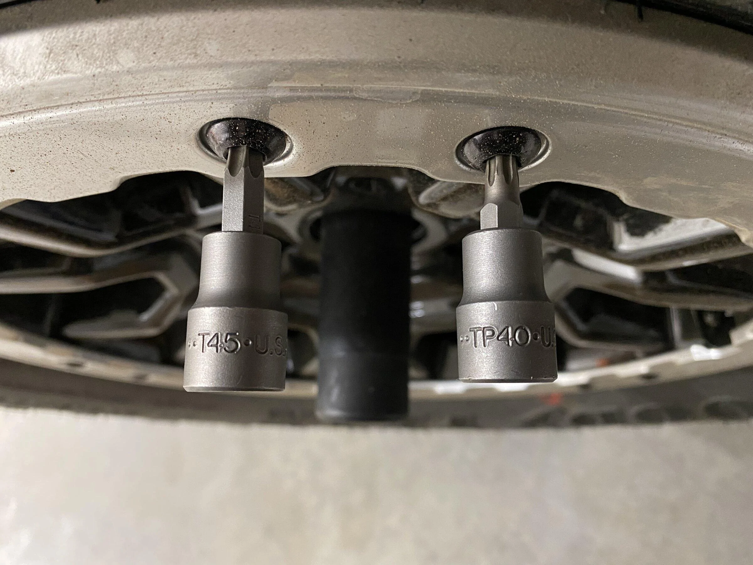

Quick follow-up...
After watching a YouTube video in another thread, where the YouTuber used a Torx Plus 40 (TP40) bit to remove his beauty rings, I decided to check the fit myself, to see if Ford actually changed the spec since the time the video was made. Interestingly, although Ford specifies standard Torx 45 (T45) here, the smaller Torx Plus 40 (TP40) does loosely "fit" by penetrating the bolt head (see below)...
Ford Bronco Driving without bedlock beauty rings installed? And torx bolt size? D3451129-CD60-472F-AE80-C80A017D9D12
... but the fit of the smaller sized TP40 bit is not optimal (i.e., similar to using a standard Torx bit where a Torx Plus bit of the same size is actually specified, in which case the standard Torx is not optimal), and it is not consistent with Ford's instructions to "use a T45 Torx wrench to remove the decorative beauty ring from the wheel."
From an engineering perspective, the T45 bit makes sense here, because it is a larger diameter bit, with more surface area at the perimeter of the bit where the teeth are located, for better contact with the bolt head and better application of torque in this particular application.
I suspect that the non-optimal "fit" of the TP40 bit may explain why some people have stripped a few of the bolt heads when removing their beauty rings (i.e., where the bit cams out of the recess). 🤷‍♂️

Quick follow-up...
That makes sense to me, and I agree that T45 is the correct bit for the beauty ring bolts. Thanks for the follow-up.

Quick follow-up...
